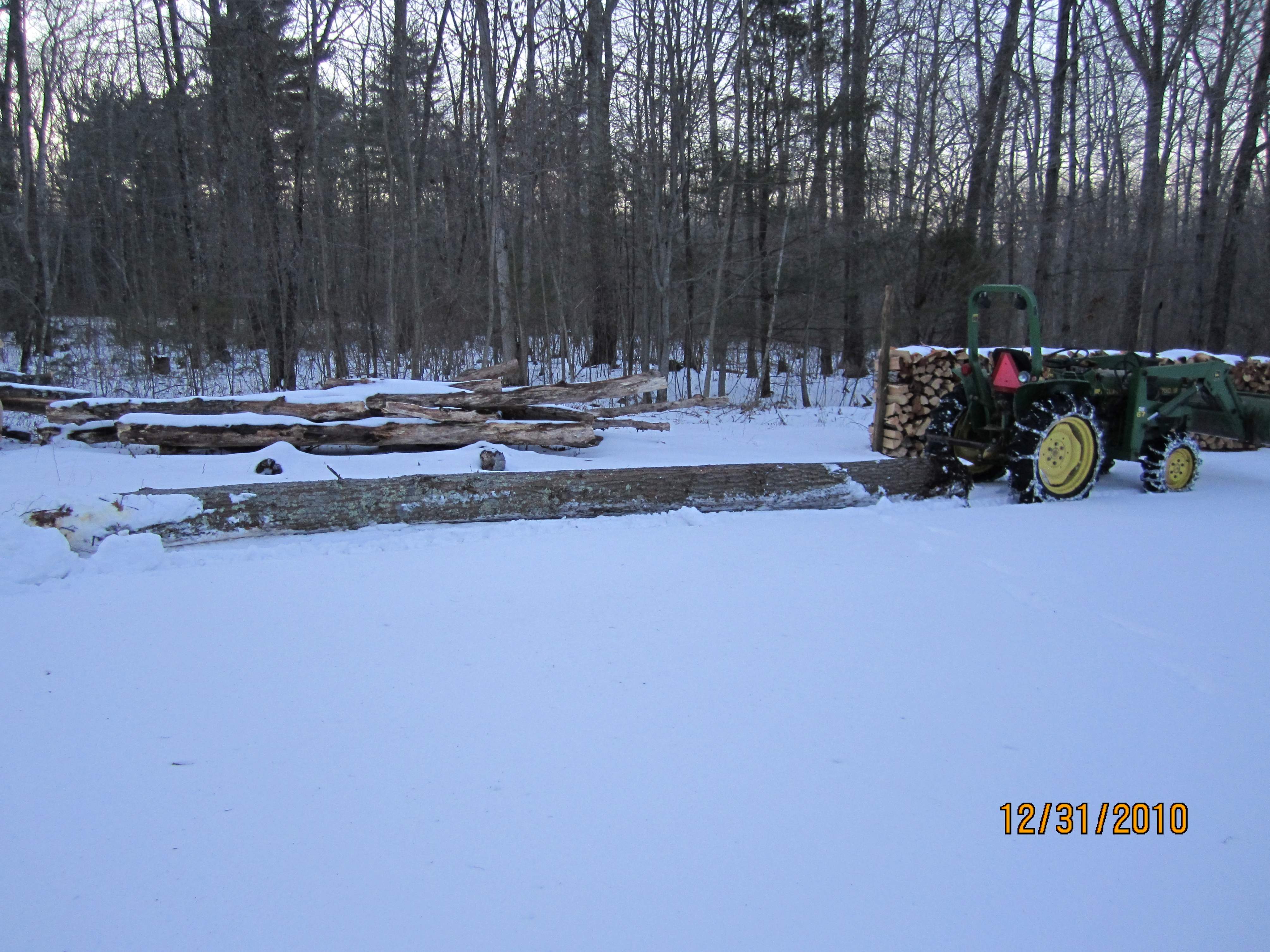

All the logs in this picture were pulled in by this kid and his John Deere. If you are having a problem believeing that I understand. The logs may have been pulled in by the larger JD which is a 20 hp 1985 750 that has been doing this kind of work since I got it. It will knock over a 4" tree. If yours are bigger, you'll need a larger tractor. For the jobs you desrcibe, one needs traction which does not necessarily equate to HP. Mostly you need weight. Also, some manufacturers have muffler kits that allow variations of muffler placement. Front grapples are not light so you would want a tractor with at least 1500 lbs lift capacity to place chunks of trees around which equates more with the DK 35. Have the dealer install the remote so you'll have a tractor ready to go with no issues.

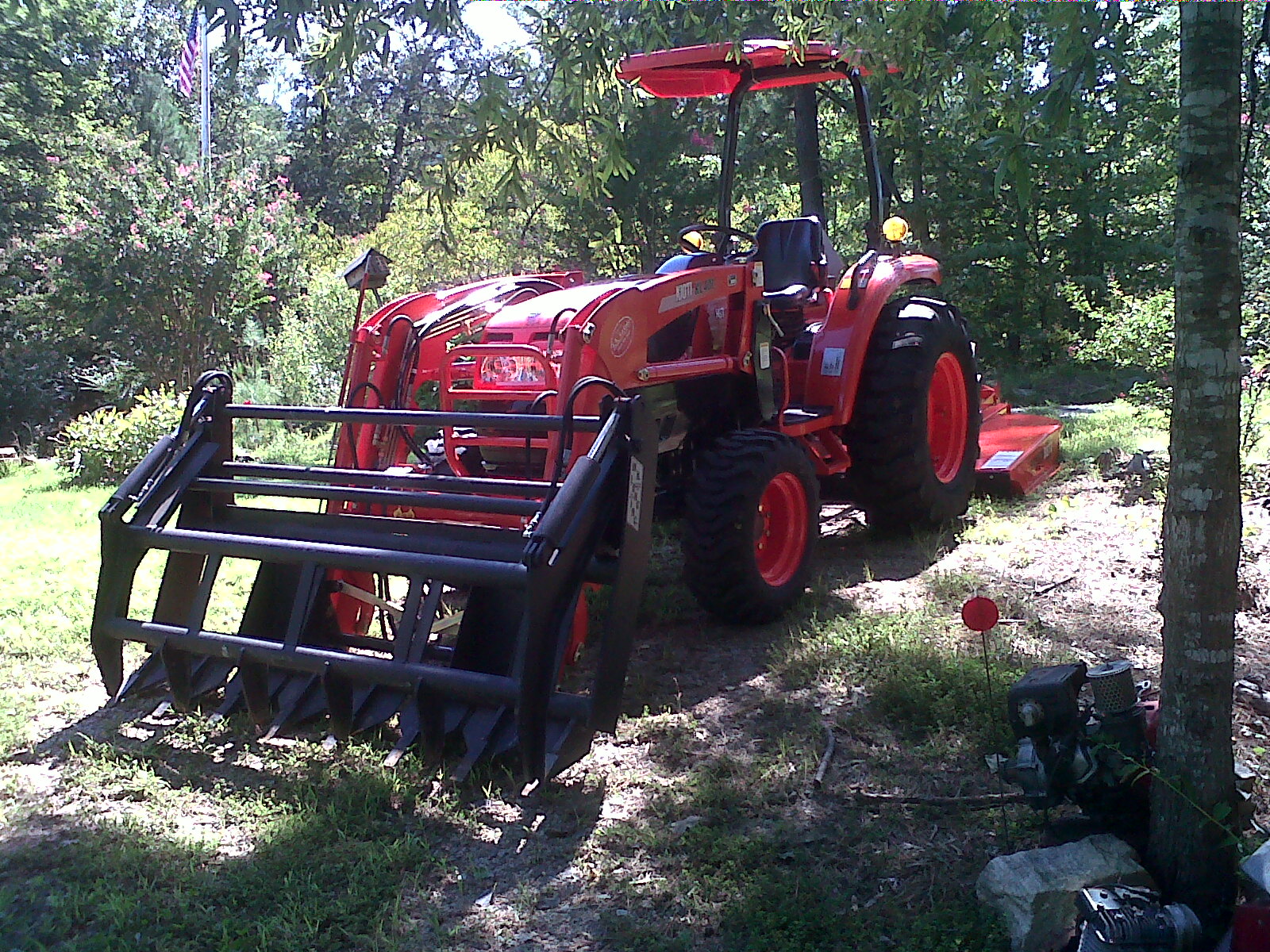

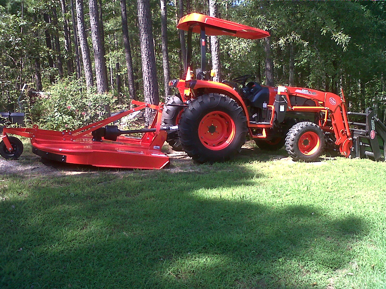

I just bought a DK50SE HST with a grapple. I love it. The FEL is the same all of the larger chassis, and it has 2700+ lbs capacity. I was convinced to go to 50 hp to get the PTO hp up higher.
This is mine...
Enjoy the shopping!
