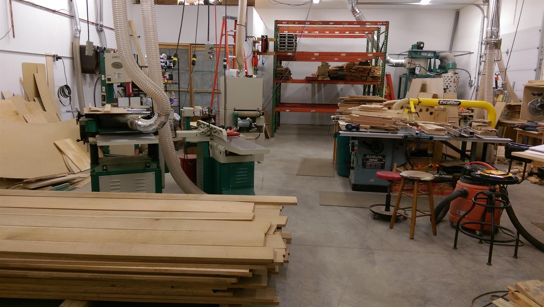

2 sections of pallet racking spaced ~4' apart. The racking is 42" deep, IIRC and 10' long beams. It's much more full now than when this picture was taken. And yes, it does not matter how you stack it, the ones you need are on the bottom... Pallet racking is typically rated for 4 tons or more per upright pair, so you can pack them as full as you want.

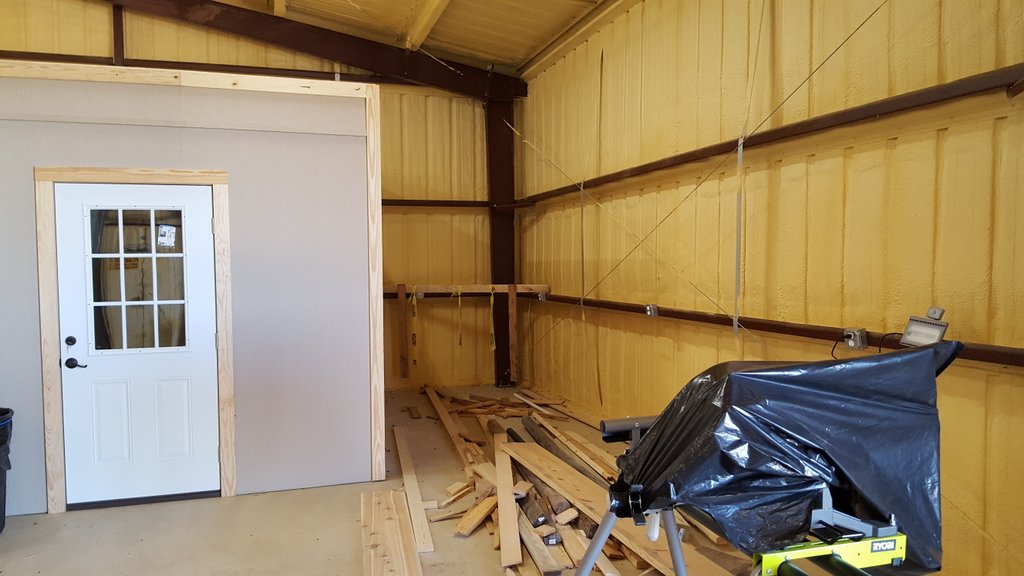

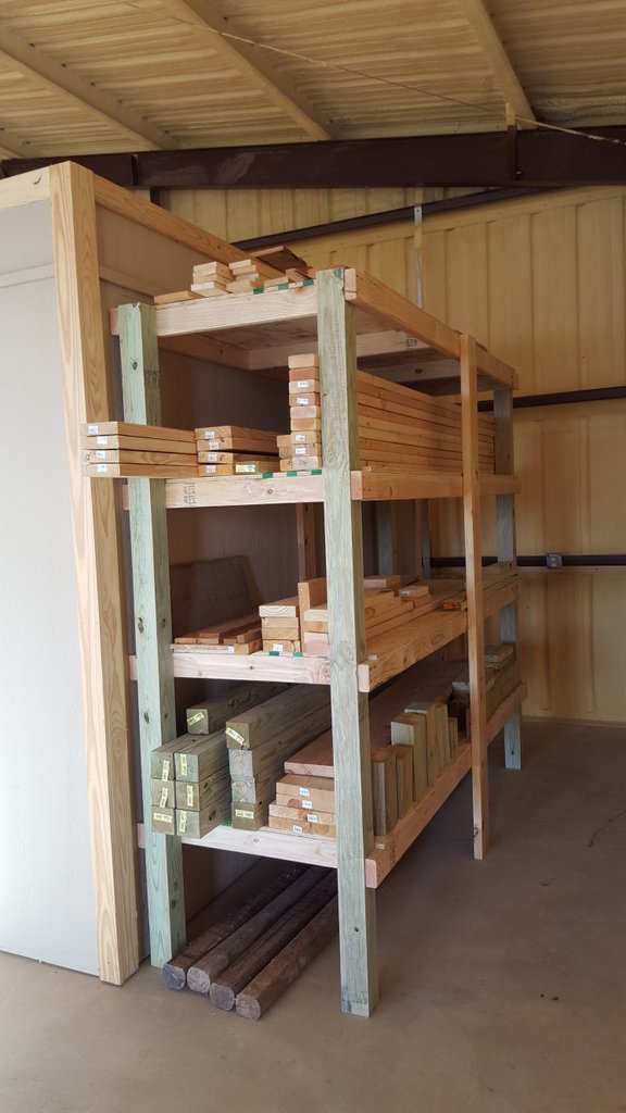

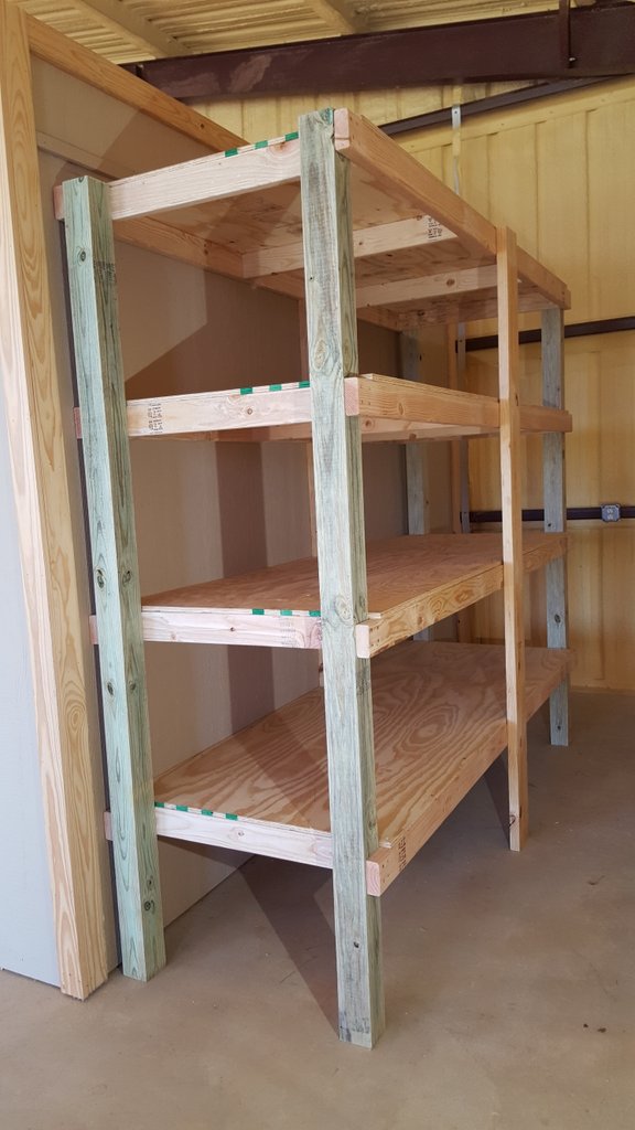

I had the same problem, you can see the jumble in one of the photos I've attached. I ended up building a rack to hold lumber. 4x4 posts for corners, plywood shelving, 2x4 and 2x6 for cross-braces and supports. My part of Texas if *very* humid, and I wanted to support the lumber with a solid shelf.
I did debate using pallet racks, I have several of them in my barn. In the end, I decided I wanted to build something, partly because I like making things.
My next project is a plywood rack. Right now it's all laying on a rack of the pallet racks, and yes, the one you want is ALWAYS at the bottom. I'm thinking about an A-Frame type upright wood rack.
