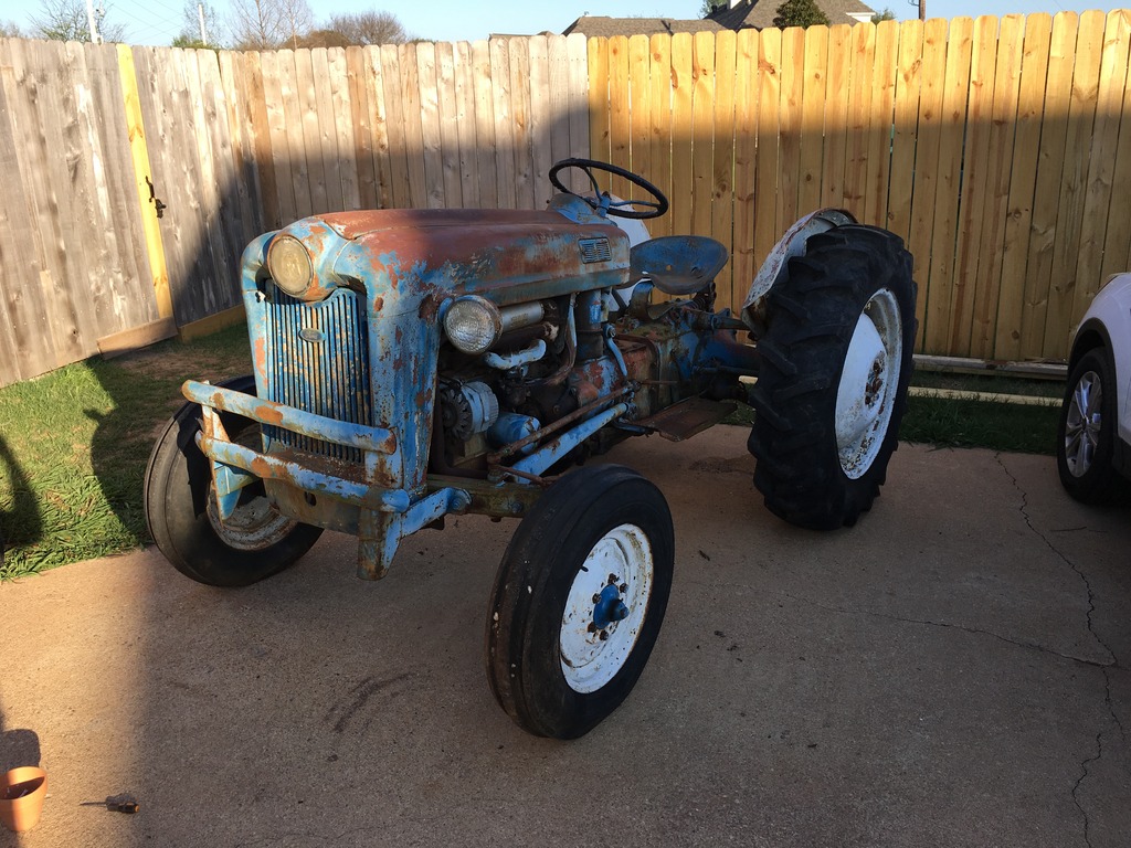

At this point I'm about 95% confident that I have brought home a non-running 1954 Jubilee. Unless it somehow happens to be the 641 with more hp, I don't care a hill of beans. Tons to get straightened out before I can attempt to start her. I'll be using her to renovate and maintain pasture that I'm (fingers crossed getting a lease on).
Issues:

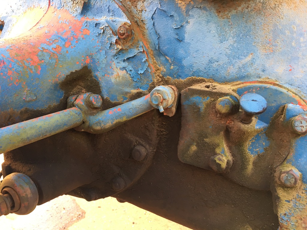

Carburator linkage is stuck - I think its just the friction disk area that is holding back movement.
PTO - leaking oil like nuts. ORC is super wobbly. Planning on replacing bearing, gasket & oil seal. Is it a fairly straight forward job?
Birds/Rats nest removal clean out
Wiring cleaned up - probably just going to make or buy a new wiring harness. Too many chopped wires and places to have failure.
Fluids/filters changed.
Once I verify she runs, I estimate I'll drop about $500 on just maintenance items.
Well here she is.

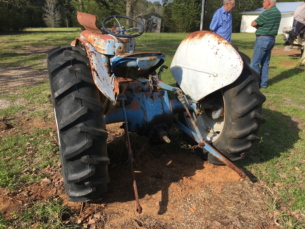

All of the eyelets or balls on the three point have lost the bearing material. The ball just floats about 3/16" in the arms. Other than replacing the entire arms, can I chop them off and weld on new? What's the typical repair method?

Rear wheels/tires different sizes ???
   / Restoman's Jubilee
Fried1765:
Both rears are 12.4-28. one is newer and probably at most an 1" taller.
Why? I'm open to all opinions. Thanks for coming and taking a read!

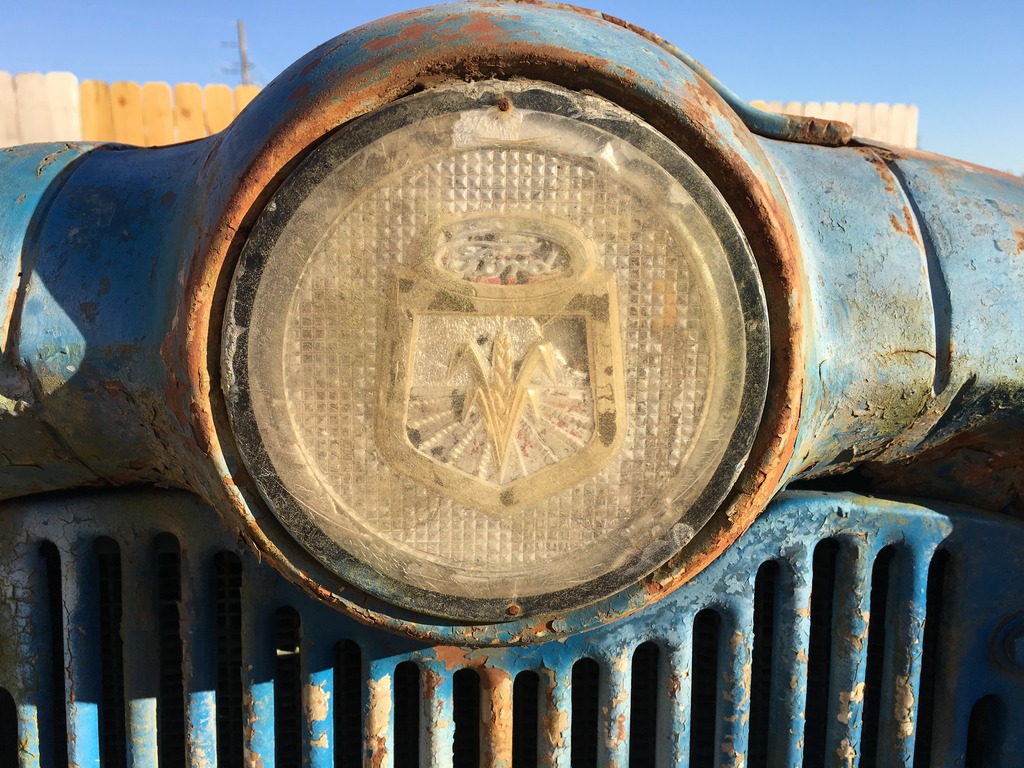

Look on Smith's Old Ford Tractors ,they have change history page that shows where to find the serial numbers.
From the information on that page, your hood emblem looks like you have a 1 series (601?) manufactured 1957-62.
