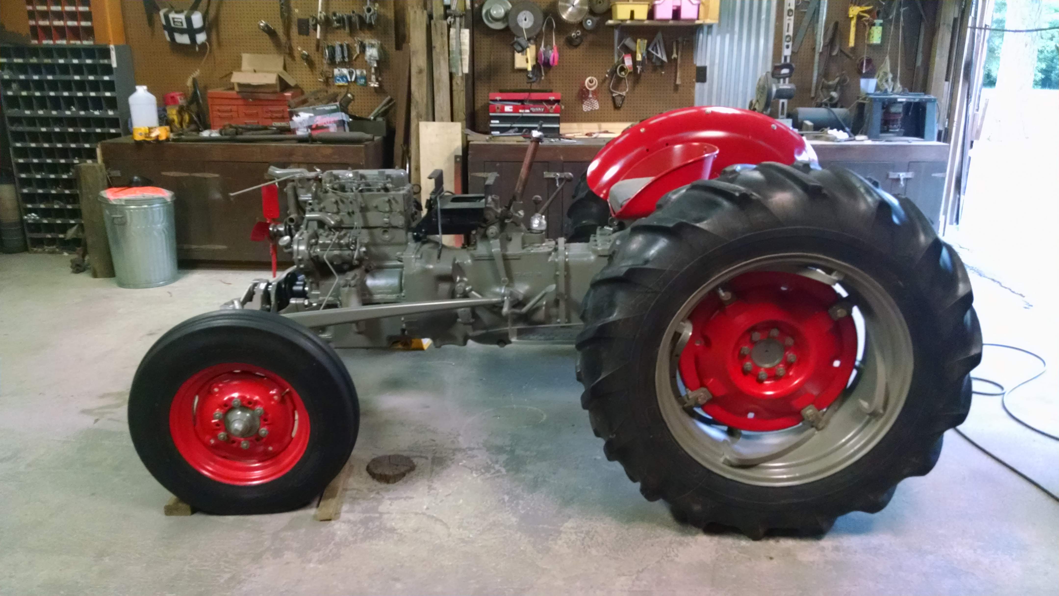

I still have a ways to go but this is what i have done so far to my 63 mf35.

Looks very good. Did you have to get into the engine, transmission or hydraulics?
   / restore
I rebuilt the 3 cyl perkins about 5 years ago_On this journey I had to replace the clutch and while I had it split I removed the main shaft in the transmission and replace all seals.Hopefully I got the oil leak fixed
   / restore #5
Oh wow, then you will have a nice fully rebuilt machine shortly. Very nice. Those Masseys are some of the nicest tractors ever built in my opinion. Great brush hoggers. I have two of the decedents of the MF35, the MF245. They share much of the same technology. Very reliable tractors and engine.
