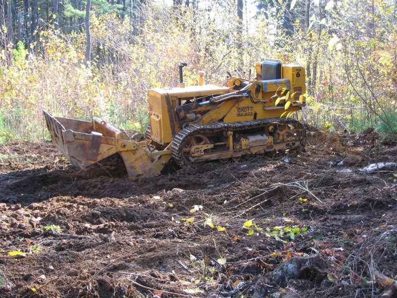

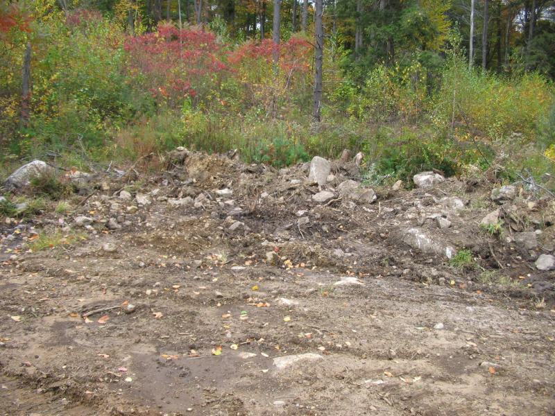

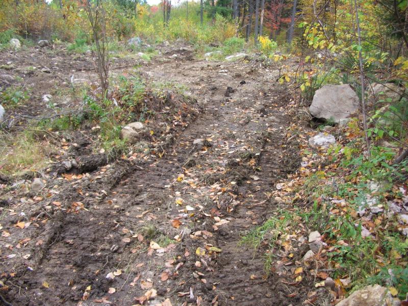

You are going to need a big dozer to dig up stumps, one in the 40,000-50,000 lb range as a minimum. And then it's going to take some time to dig around and push them out. It will be much faster and cheaper to simply contract a big excavator with experienced operator who can come in and get it done in several days depending on how much you have to clear.
I am clearing a couple acres with my dozer. Plenty of ground level stumps 18" to 30" in diameter (and roots to match) and plenty of rocks from football size to car size. I have cleared the brush and in the spring will get an excavator in for a few days to dig up the boulders and stumps.
