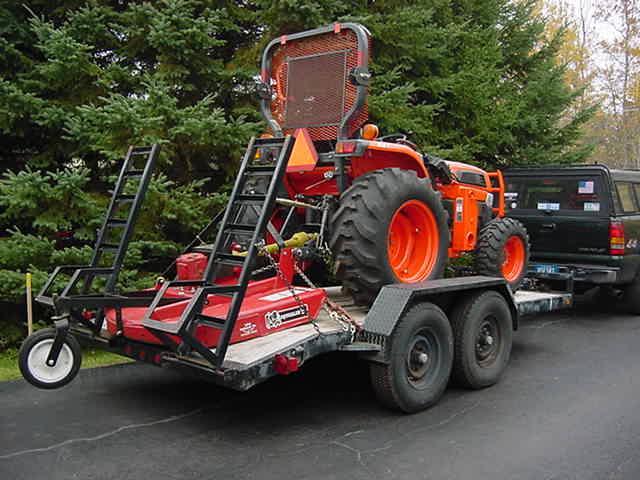

Have them on my trailer and have hauled on Interstates, State, County Highways, usually no problems. Have a County Highway, steep grade for one section with 35mph corner at the botom - grade is 4 miles long - have to apply the pickup brakes frequently, which results in surge brakes engaging for longer period of time. Have had problems with my brakes not wanting to release completely after descending and wheels heating up. Had to disconnect brake on one wheel completely, so now have brakes on 3 wheels. I'm not enough of a mechanic to solve the problem, have cleaned the wheel cylinders - would appreciate any advice on this. Final comment, when backing up I place a block of wood between fixed and moving part of the hitch so it doesn't close. Attaching pic of the brake (Trailer was custom made with 2 6,000 lb. axles.)
penokee /forums/images/graemlins/smile.gif

trailer w/surge brakes.

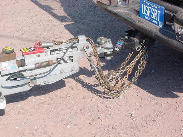

Hauled our son's car a few hundred miles, using a U haul w/surge brakes, as mentoned by Syncro - worked good. Didn't dare take mine on a longer trip because of brakes hanging up. Picture of U haul surge brake attached.

U haul trailer w/surge brakes.
Note: U haul holds you responsible for any damage to trailer, so took a few pics before renting, so proof of existing damage before we left.
