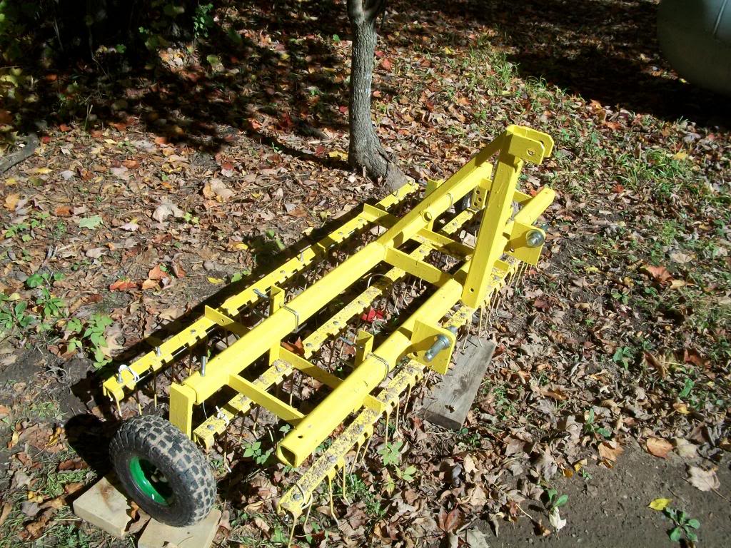

I built this thatch/gravel/yard rake that I can use on one of my universal 3pt tool bars...
I plan to build a bolt on front 3pt mount the use the rake on... The rake assembly can be reversed on the tool bar...
Actually.... The picture is version 2... Version 1 worked OK... But would clog quickly...
I plan to use the lift cylinder from my front snow blower to lift the front 3pt... That way I can use the up and down on the joy stick for the thatch rake and the bucket curl to lift/lower the mid mount mower deck...
I have it set to run only about 3/4" deep, but with this many teeth, it seems to be quite aggressive... That is OK for the gravel, but may be a bit much for a pristine yard.... Mine is pretty rough, so that isn't a concern...

Wow is that thing ever a heavy duty implement! I like your idea of using the snowblower lift cylinder. I think I will look at putting my quick-tatch lift bracket back on the front and retrofit the dethatcher to that.
Thanks,
DM
