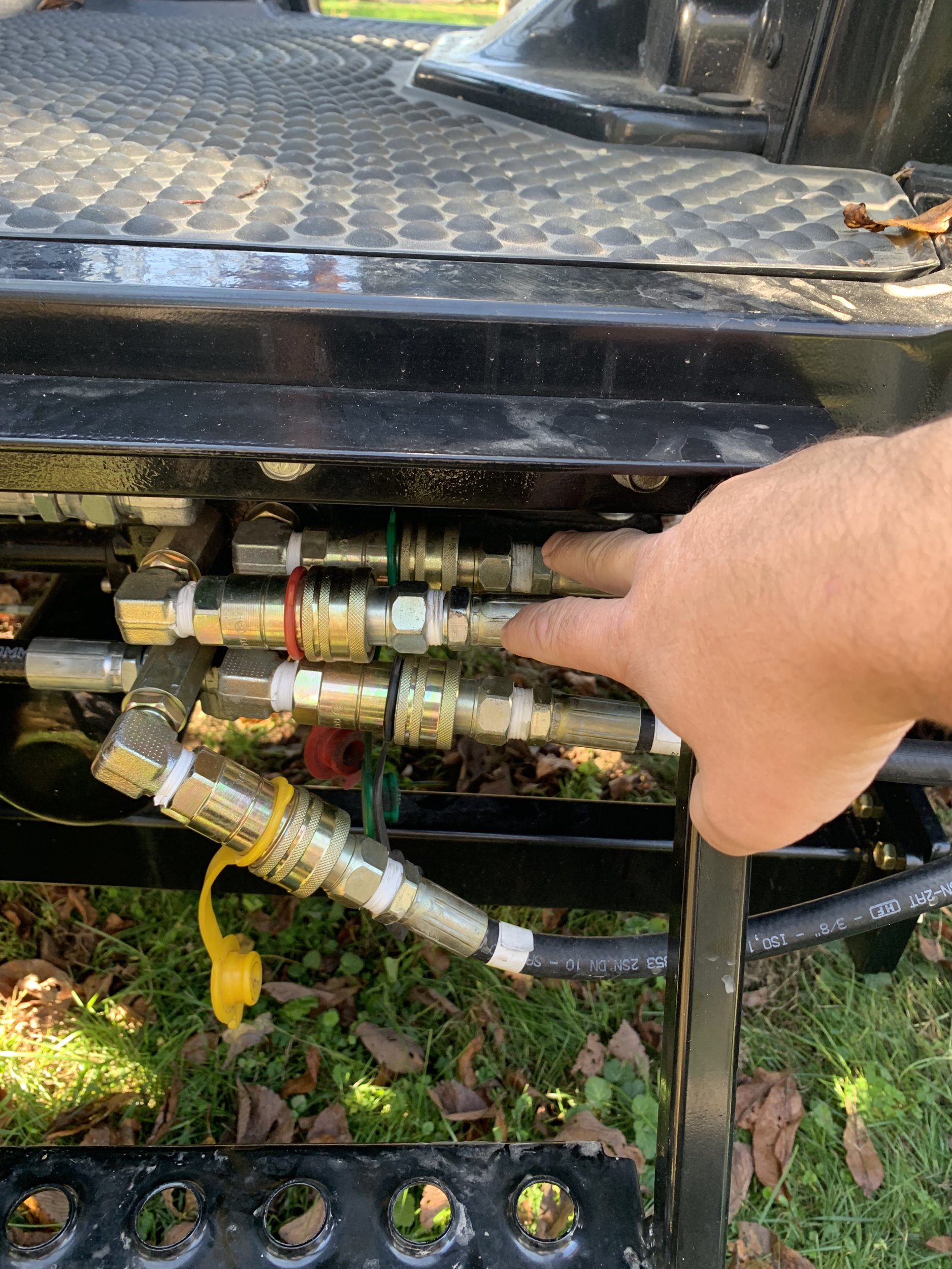

Got my RK 55 finally. I had the dealer install the third function valve, but in doing so, my “curl” and “dump” functions for the loader are hooked up backwards. (Curl=right stick Dump=left stick) my question is, can I reverse the functionality by swapping the quick connect couplings under the operator station? Or am I going to damage something?

Yes you can easily swap them without issue. Quick coupler look to still be there so will take about 2 seconds.

I did. And it worked!!! Thanks Stikky
