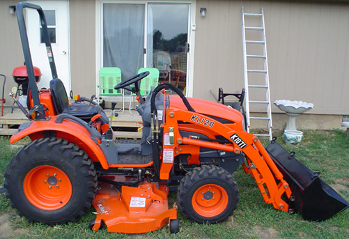

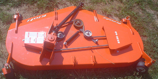

Hello Steve,
I just got back to TractorbyNet. Been busy. I got my CK20 four weeks ago now. I have the 60" MMM rear discharge. I like it real well for getting around objects. It might sound odd, but I can remove the deck in about 2-3mins. Real easy. I can attach it in no more than 5 mins. It seems to be a solid mower and gives a good cut. It has been real hot here, so the grass is barely growing, and very thin so a I really need a little more testing to make a better evaluation. The thing I don't like is the clearance. I can't get but about 4". I tried to adjust it higher, but that causes the gearbox to make contact with a hydraulic line. /forums/images/graemlins/frown.gif Also the rear gage wheels are just heavy plastic on a shoulder bolt. Seems like they should have a bearing. The manual is kinda poor too. For me I'd buy it again. I like the fact that my wife doesn't mind using it. She would not use a 3-pt mower. I'll post a pic if I can.

Wannabe,
You definitely have some Kioti inventory. I encourage my wife to use our tractor. She feels like she accomplishes something and she has some tractor stories to tell her father. Maybe the hydraulic line can be raised on your CK20 to get some additional pan height. Lube your rear gauge wheels more frequently if they are a bushing style. Do you know the manufacture of your mid mount mower?
   / RFM or MMM for CK20? #7
If I'm remembering right, the MMM is an American made product in Harrisburg, IL. Made by Midwest. I always thought the wheels on a MMM were not for constant contact with the ground and height adjustment. The MMM is a suspended mower.......correct me if I'm wrong. The wheels not having a bushing should be no big deal if it's not constantly supporting the weight of the mower.

R_squared,
I guess I like orange /forums/images/graemlins/smile.gif. I had heard that Midwest made many of the Kioti attachments and liked what I had read about them. So I bought all Kioti brand. So far no disappointments. I called Kioti about the hydraulic line and they said they could see where it could be a problem and would look into a solution. I was impressed with the tech guy I talked to. Very helpful people! It really isn't a huge problem, but an extra inch of clearance could be gained with a solution. I'm pretty sure Midwest is the manufacturer.
   / RFM or MMM for CK20? #9
Inspector507,
You are correct, the rear wheels are supposed to only occasionally make contact. My "Lawn" is so bumpy that they make contact quite a bit. /forums/images/graemlins/smirk.gif I'm going to cut a little higher next time.
