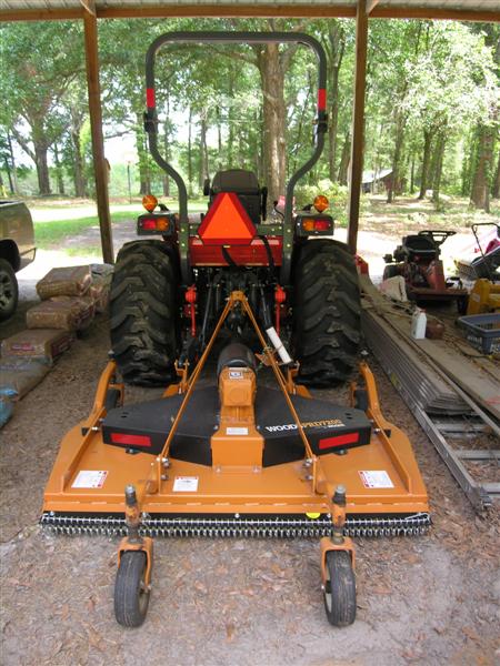

I mow with a Woods PRD7200... 72" rear-discharge, 720 lbs. (+ chains & front roller). RFM does such a nice looking job, I only use the Woods BrushBull for rough cutting and first cut on new (to me) areas.
