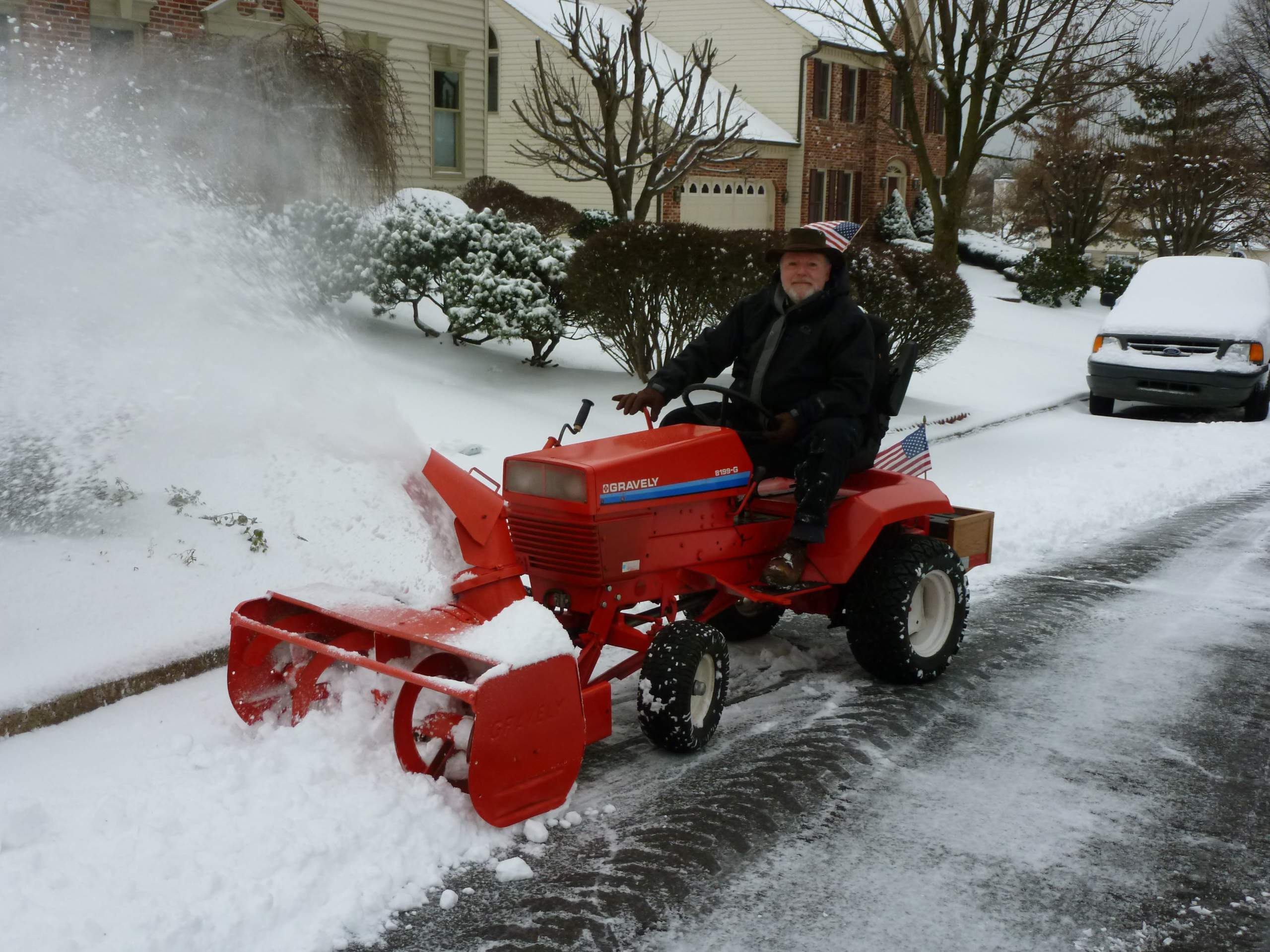

Fluid - after looking at that unit and the PTO connection, even if I could connect the PTO (unlikely without creating an adapter), I doubt the old Model L would have enough power to use it and I don't know how I'd support it anyway. I appreciate the offer though! Now I'm looking for an old MA210 snow blower attachment that was made for the Model L I have.
Picture of the MA210 on a newer walk behind Gravely than my Model L: http://i4.photobucket.com/albums/y150/krislu/100_1474.jpg
Thanks again! Of course, if you find out that it'd work or think it'd not be too much to make it work, I'm all ears. I know how to fabricate and have tools and a welder and love a new project :)

alteredz;;; I look for anyone that had put a tractor snowblower on a walk behind and didn't find anything. I found info on mounting walk behind snowblowers on riders, then it dawned on me that rider snowblowers are heavier then walk behind snowblowers. My 38" blower is 250 lbs, you could put counter weights on to help with the weight but can the drive piece take the stress. Do you ever use gravelymanuals. com to get info? If you look up the 26" MA 210 and 34" MA 211 blowers there is a piece called the (drive pn# 10184) that you would have to buy or make one and you would have to change some parts but if you are good with that stuff I can't see why one couldn't do it. Like you said the only thing if you wanted to mount the bigger blower is the HP. How much HP do you have with your L. I don't know anything about them to say that it will have enough power to do the job. Let me know what you think if you look at the site I gave you and post back your thoughts.

Thanks, Fluid. I found the IPL for those blowers on gravely manuals and that part (77 in the diagram, PN 10184 "Drive". Looks like an adapter and mounting that mounts to the front of the walkbehind 2 wheel tractor. That part would also need the slip clutch, etc. that goes behind it to interface with the walkbehind. Looks like quite a project to make.
The Model L I have is 6.6hp. So I'm wondering if it has the power to turn that blower you have and push. It seems like the 34" MA-211 may have been mated to the later Model L tractors that had the 6.6hp engine, so the engine might be o.k. with the 38" snowblower if I could adapt it. What is the HP of the tractors that the 38" snowblower is designed to be attached to?

So, as it turns out, now I have a MA-210 that I could borrow parts from... So I MIGHT be able to hang the 38" snowblower on the Model L. with some fabrication. If the horsepower of the Model L's 6.6 hp engine is enough to operate the tractor and the 38" snow blower, another compatibility question comes to mind: Is the height of the PTO centerline of the 38" snow blower compatible with the PTO centerline height of the Model L? I don't know what the Model L's PTO centerline is off hand, but I can measure that tomorrow.
After that question is answered in the affirmative, two other questions remain for me, assuming that the 38" snowblower can be made mechanically compatible with the Model L (PTO connection interface, mounting of the unit to the Model L):
1) Is the Model L's 6.6hp engine enough for the 38" snow blower?
2) Is it feasible to obtain the 38" Snowblower (travel distance, price)?
Thanks for your help and listening to all this. BTW, if you guys think I should move this to a new thread, say the word.

Question no.1- What is HP of the tractors that the 38" blower is designed to be attached to? Gravely sales literature says that the 26", 34" can be used on the two wheel 7.6 HP convertible. So you may be pushing your luck with a 38" on your 6.6 HP two wheel tractor. Question no.2- Is the height of the PTO centerline of the 38" blower compatible with the PTO centerline height of the Model L? I will check today and give you the answer to that later, with pictures. Is the Model L's 6.6 HP enough for the 38" blower? Read answer in my question/answer no. 1 Is it feasible to obtain the 38" snowblower (travel distance, price)? If we find that the Model L & the 38" snowblower are compatible, we can PM each other to work out the details on locations & price if that sounds good to you. I don't like giving out my info on a open forum. Best Regards, Fluid

Based on that comment about the HP and the Model L, I agree - I'm going to just keep with the MA-210.
I really do appreciate all of your help on this, Fluid!
