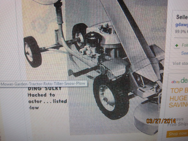

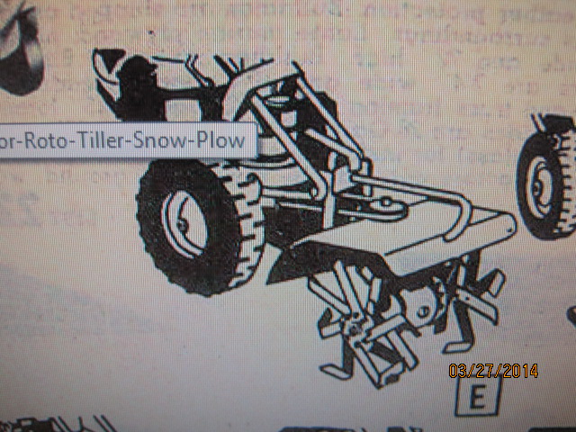

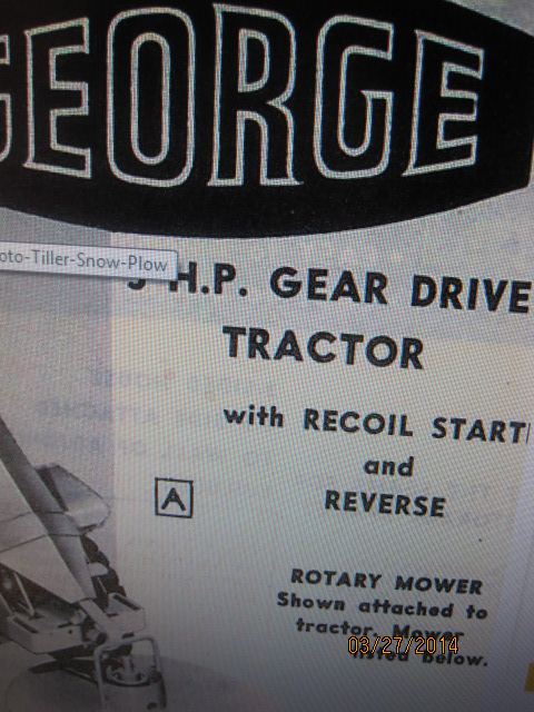

Hello Again: I happened to be searching E-baay for a riding front tine tiller and i can across an advertisement someone had up for auction and would you believe ssme outfit made the exact thing I was interested in, but it was back in 1955.
Has anyone run across a GEORGE 3 hp GEAR DRIVE TRACTOR. It had a variety of attachments you could mount on the front of it such as a mower deck, tiller, etc.
It appeared to be manufactured in either Illinois or Missouri.
Does anyone out there know of one still in existence or in a scrap yard?
Another thought, instead of a rototiller in front, what about a simple cultivator that can be raised or lowered and shoess or tines to just barley scrape off the new weed sprouts?

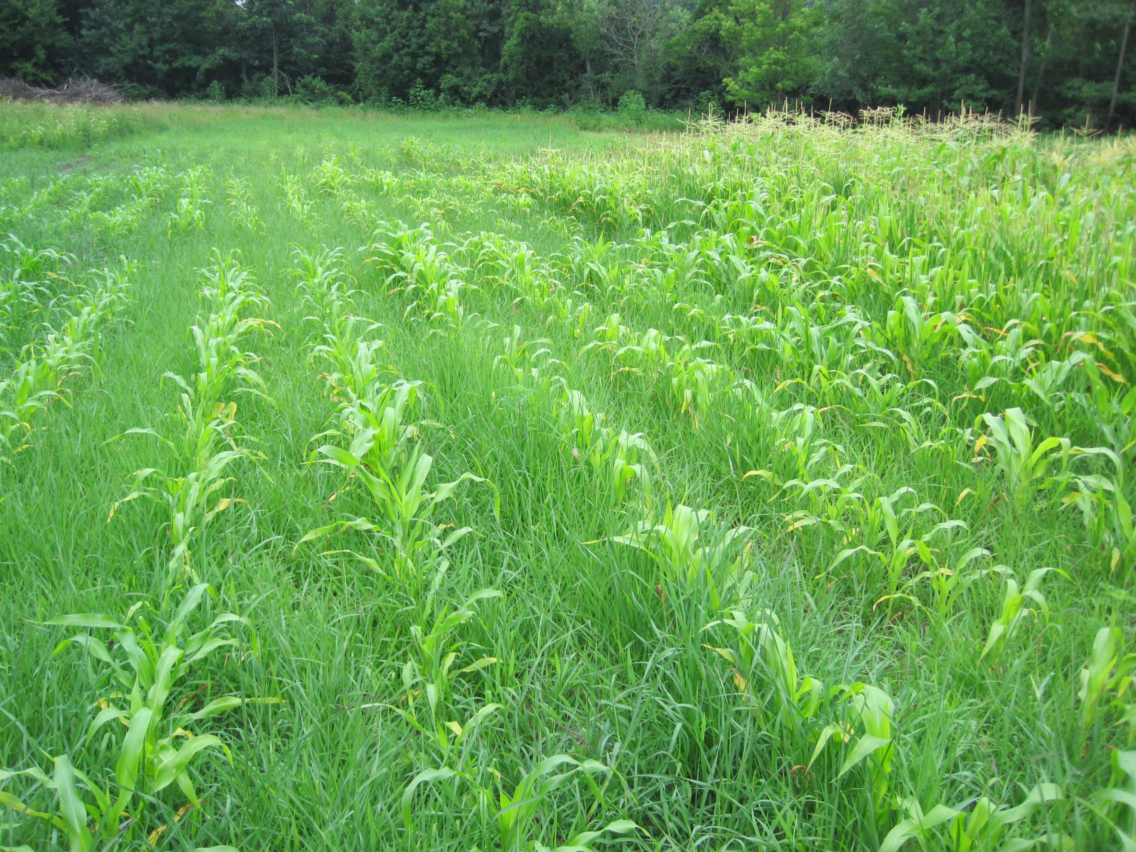

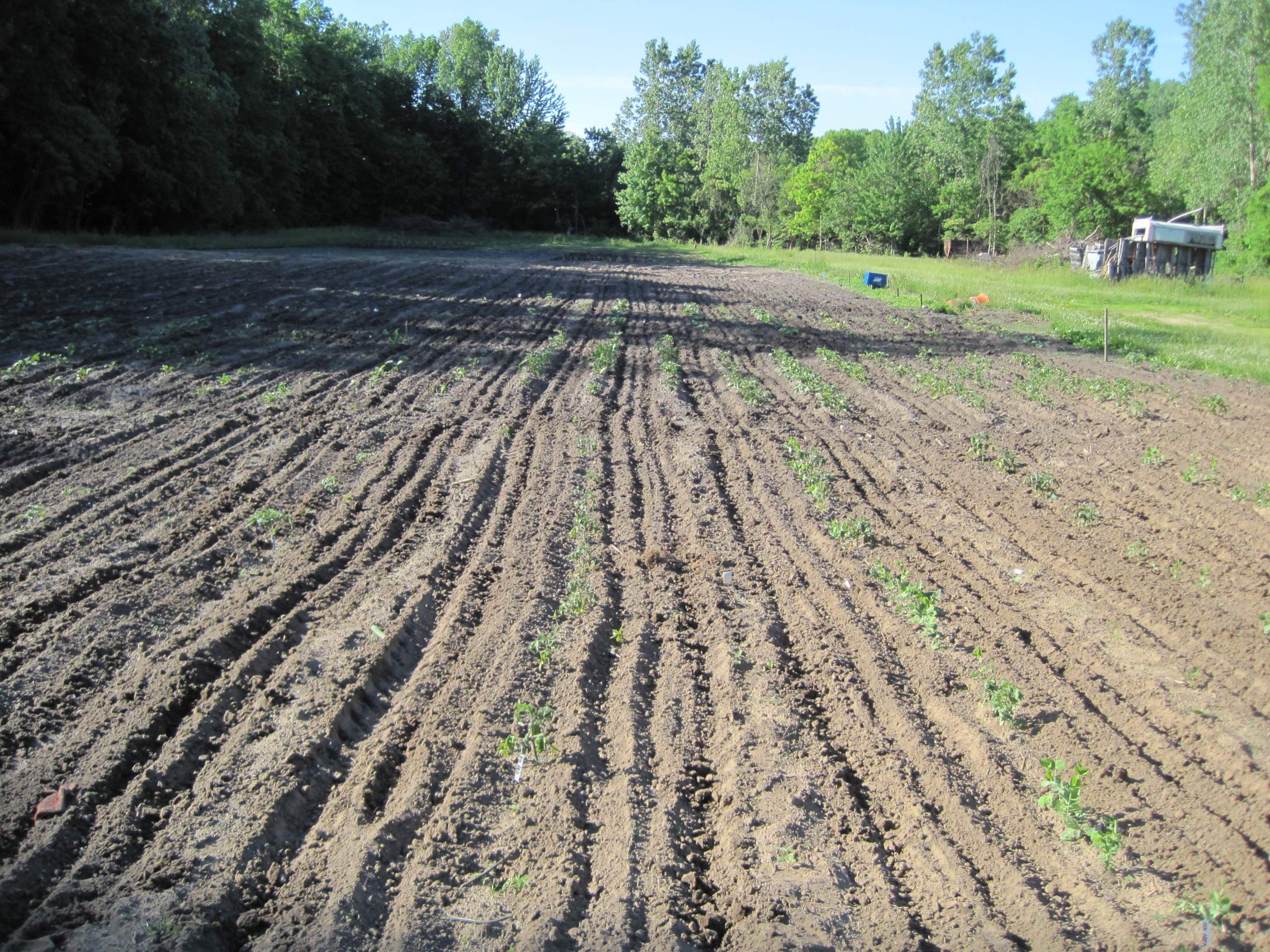

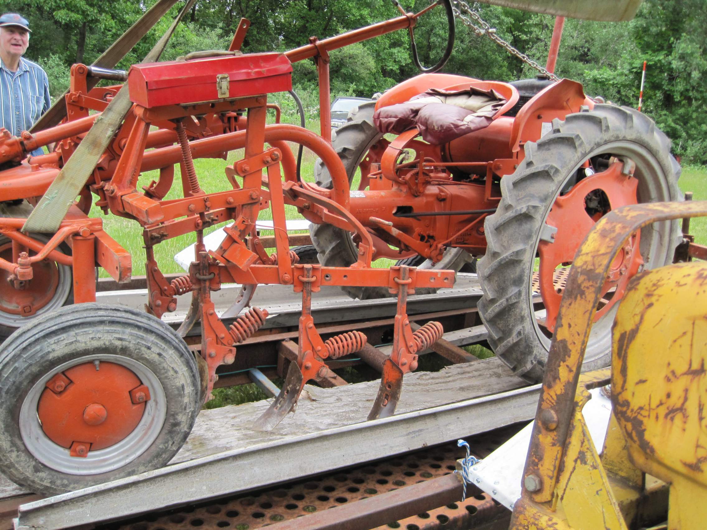

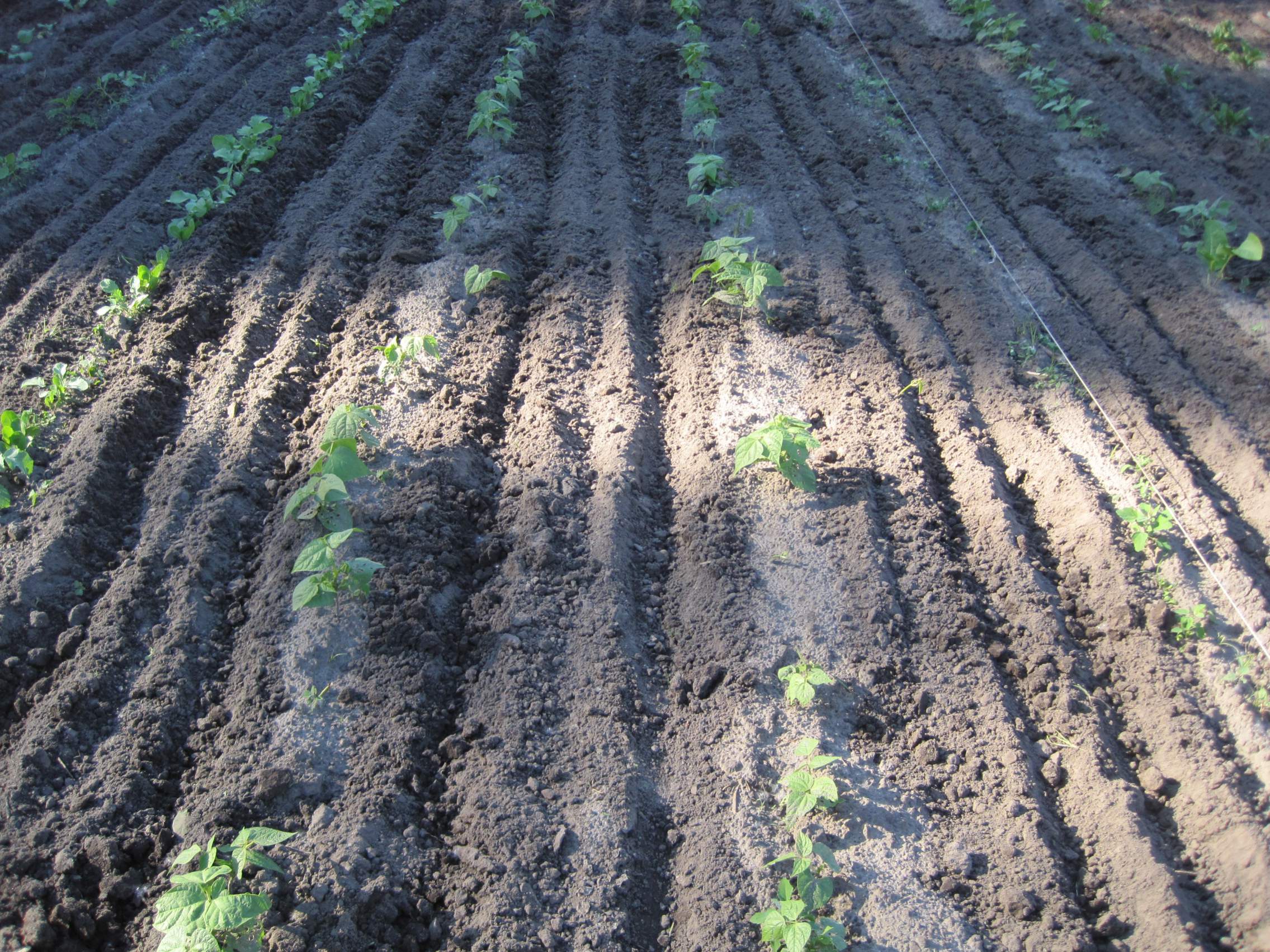

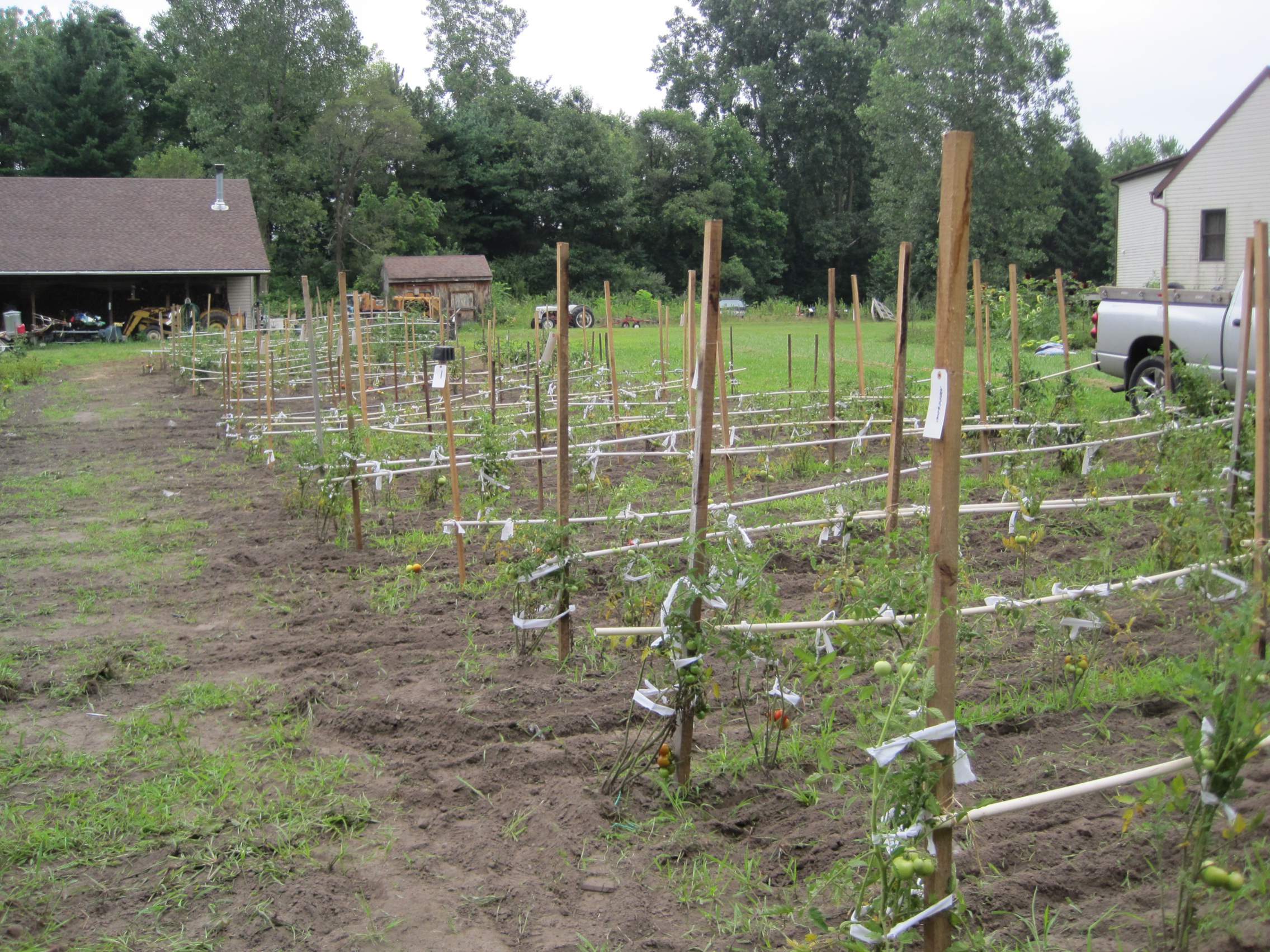

Motownbrown: I appreciate and understand your recommendations. I do have an Allis Chalmers G which I picked up at auction last year with a hydraulic lift for the cultivators. She is a beauty. But one problem with the G as well as Farmal cubs etc. Once I get my tomatoes staked and some of the other plants start to bush out, I can't row cultivate the fresh new weeds after a good rainfall, I do have a 16', 24' and 28' walk behind tillers but I show you a picture of the row lengths I have and now at my age, I seem to be "petering out".

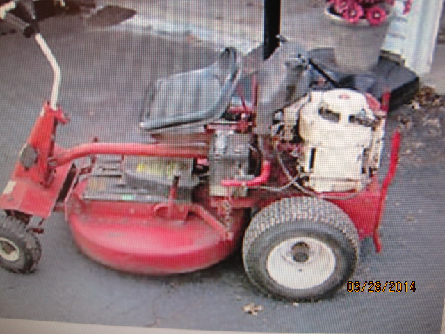

I bought a Snapper a few years back and dropped the mower deck. Now I am trying to figure out how to attach a cultivator with either tines or Danish sweeps that will just scratch the surface and also allow me to cam them up when turning etc.
I am illustrating with 3 pictures my problem. One shows the length of my garden running south to north. I divide sections east to west about 25 feet long with a 6 foot lane between each section. the first shows my cultivating in mid June with the AC G and a close up. She does a beautiful job. But the next shot taken about 2 weeks later shows if I let that grass get up more than a a few days after a rain, look out, it takes over. As the corn gets too tall, the AC G is too low for the new stalks. Also if I have the tomato stakes up, no chance.
Also, I am a total amateur at this and retired, so I can't afford the 2-5K machines that would be nice. All my produce goes to charity. I usually spend a few hundred bucks at auction for my machinery and then jerry rig something out of the junk to get my task done.

Wow, that is a grassy stand of corn, my friend.
I understand now, I think, that you want something to cultivate between the rows, not on each side of a row which the machine would straddle, like the G.
What kind of grass is that you have? I'm wondering if you could do more tillage for weed control prior to planting your corn, say, till, wait ten days, till, plant. Also, we use flame weeding in our corn patch, that's something to check out.
We grow about an acre of vegetables, and you're right, it is a lot of work. We are farming on the contour of a slope also, so mechanical cultivation is almost totally useless. We rely mostly on wheel hoes, swan neck hoes and diamond scuffle hoes. We do use the troy-bilt tiller for one or two cultivations of the corn, then use hoes to finish the job.
Your area looks pretty flat, so you should be able to come up with something. How about a toolbar on a riding mower? Mount some sweeps on n it, put it out front and set it to dig 3/4 of an inch. Worth a shot anyway. Also, one thing we've really found helps a lot is really being proactive when it comes to weed control. It's hard to do, but dealing with small weeds is infinitely easier than larger ones.
One last thing, try mulching your tomatoes. We use poly mulch laid by hand. Really helps with weed control, as well as soil temp and water conservation. You could use straw mulch too.
When I said 2-5k should get you a good machine, I didn't know you already had a G. Don't go get another cultivating tractor, you already have one of the best.
Good luck.
