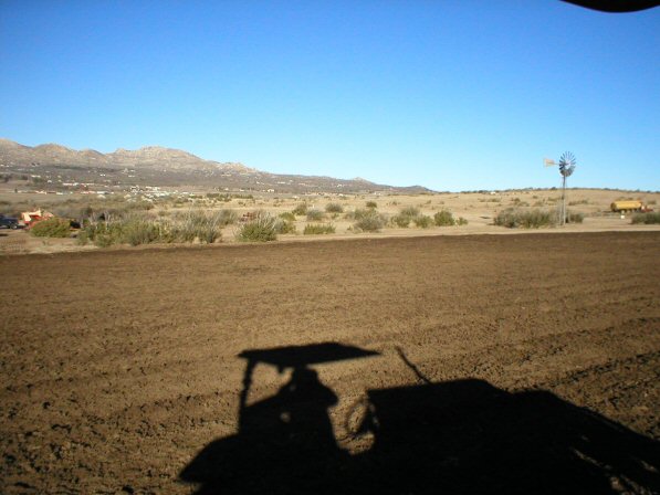

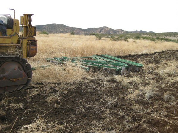

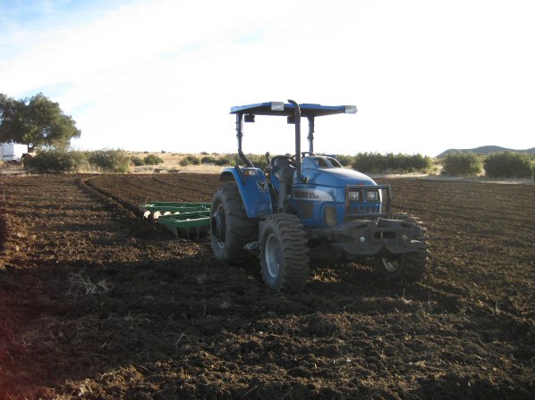

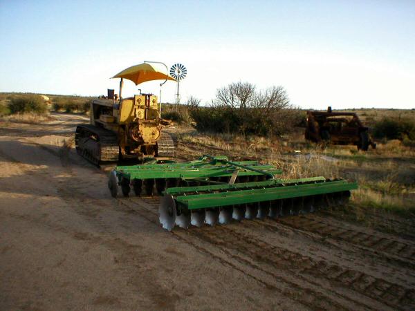

Galen, I think the same thing, just the opposite. How in the world do you guys pull such big disks? :confused3: With our ground and terrain, I have had the tracks on our D6 slipping when pulling out 12' offset disk and I have almost run out of power pulling my 8' offset disk with the 7520. All our disks are old JD-Kielfer pull disks with 22" blades. Normal pull would be 8"-9" deep in damp soil. ;)
The discs I remember on the farm only had 16 to 18 " discs, and once in a while we would disc the corn stubble in with out plowing, and if you set the disc to a good angle you could only get a couple of inches of penetration the first time over. I stopped and watched a local farmer discing a couple of years ago and he was only getting 3 to 4 inches of penetration. The disc he was using was probably 20 to 25' wide you don't see much of anything smaller being used for farming in our area anymore. Actually I don't see discs being used much, in our area, anymore.
Brian,
Your pictures almost look like you are plowing.
   / Right fit for Disk Harrow? #9
Brian,
Out here in the West, they are still disking and the "REAL" farmers are using anything from 24"-42" disk pans from 14'-20'+ wide. So anywhere from 10"-18" deep. Of course it all depends on what they are growing. Just goes to show how different things are in different parts of the country. ;)
