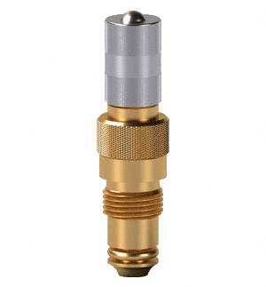

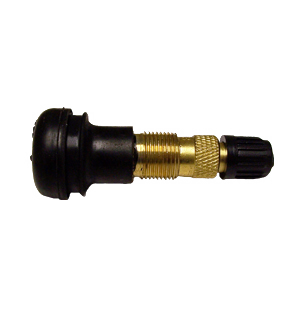

As I mentioned most tractor valve stems or any valve stem made for liquid filling are are 2 piece;
tubeless tire valve.png in this picture you can see the plastic valve cap, then the knurled portion below the cap will unscrew from the base of the valve stem.
liquid fillcore.png this is a picture of the liquid fill core, this one has a metal valve cap, this screws into the main body of the valve stem.
