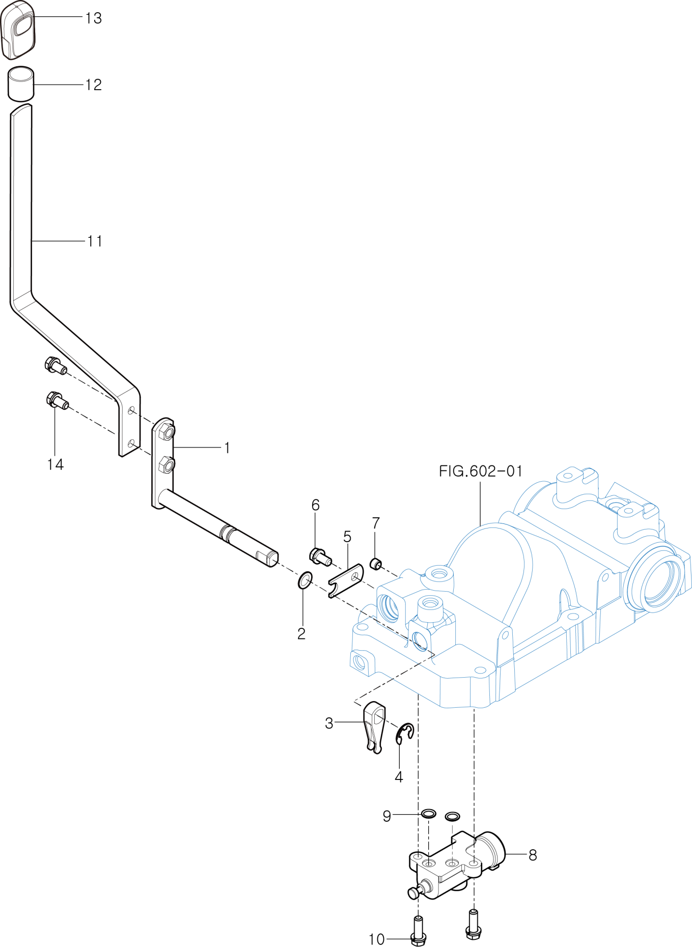

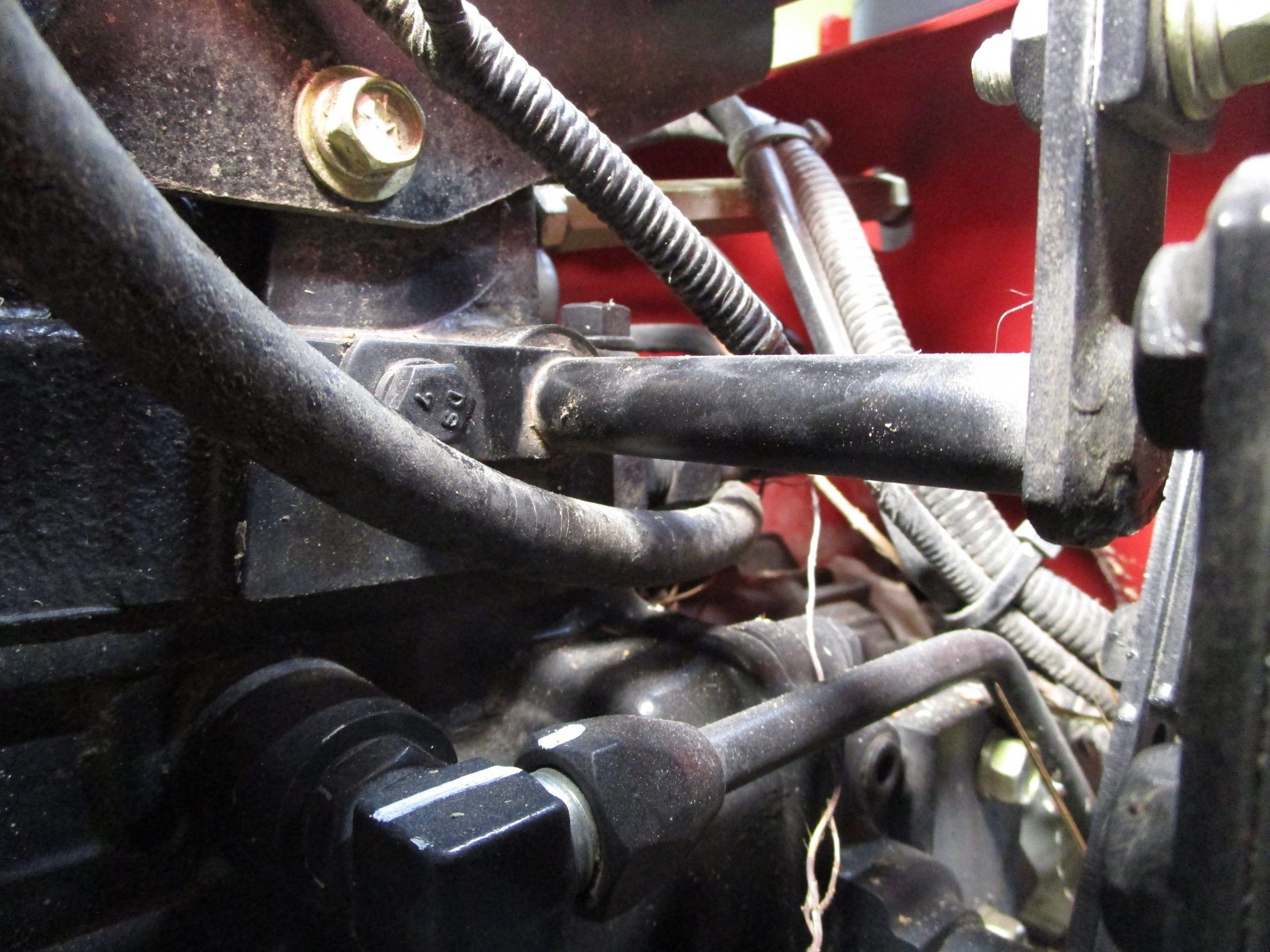

So I took off the seat assembly to gain better access. Where the lever goes into the valve body there is a 12mm bolt that holds
a tab that goes between the shaft and the valve body. I took the tab off and noticed rust where the shaft enters the valve body. I assume there
is some sort of metal bushing/seal in the valve body, so I've sprayed it with penetrating lube. Still no movement yet but i'll give it time to do it's thing.

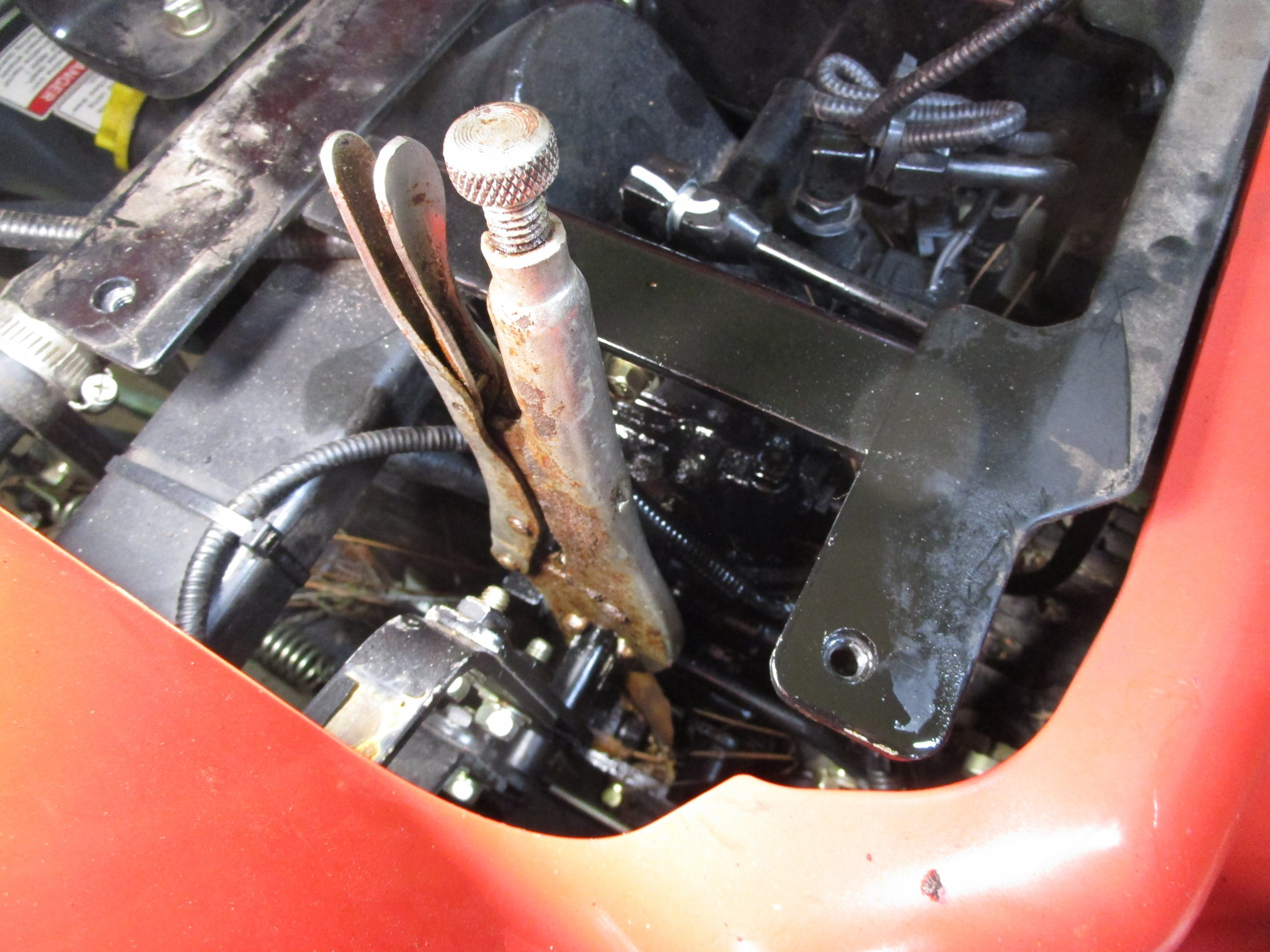

Success!! So before I tore it apart and declared War on Korea, I decided as a last ditch effort to warm up
the tractor by running it a 1/2 hr. then put vice grips on the shaft and pull back and forth with the lever arm.
It moved a little then a bit more! After 15 minutes of spraying and rocking it freed up! I will be keeping
a coat of grease over that pivot point in the future.
