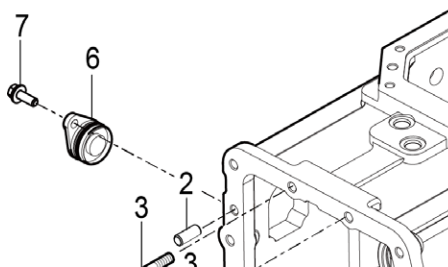

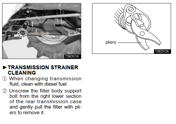

Well, today I did a service on the hydraulic/transmission. Back in August I noticed that I couldn't see the fluid level in the sight glass and I was approaching 150 hours. I hadn't really been keeping track of the hydraulic fluid level since the 50 hour service like I do the engine oil. Not knowing if the fluid level was down a gallon or 3 gallons I decided to just do a complete service. After draining the fluid and removing the filter I found that the filter they gave me was the wrong one. The one removed had a hole approximately 5/8" where as the one removed had about a 1" hole. I called RK and found out that the filter was mislabeled as one for the RK37 rather than the RK55. They swapped out the filter for me then after installing it I went to the last step in cleaning the transmission strainer. When I pulled that I don't see where that can strain anything. It looks to like nothing other than a cap with an o-ring to seal it. I was expecting a straining screen of some kind like on old Volkswagons. Am I missing something? After completing all these steps and adding 9 gallons of fluid, the fluid can't be seen in the sight glass. The rep at RK gave me 5 two gallon containers of transmission fluid so now I wondering if I go by the quantity in the manual of 9.2 gallons or add the other gallon and see if it shows in the site glass?

I looked at the parts break down and it just shows the cap as the only thing there. The description used in the parts catalog is suction cup. Beyond me as to what it does or how it could clean anything.

That looks like the strainer cap. Is there not a strainer inside? Few inches long like this (from John Deere):
   / RK 37HC transmission capacity
The link for the photo doesn't open for me. Nope, nothing inside. That's the reason I looked at the parts catalog thinking if there was a screen element suppose to be there it would show that.

I have the RK37HC Parts Catalog and it shows the location of hydraulic system strainer, that you're inquiring about, located on the lower, left-hand side of the transmission housing; as referenced from the driver's seat. See attached excerpt from Parts Catalog.

Thanks DRP........ That's what I've been looking for. From the picture in the manual I never would have guessed that it had a hose attached to it. Picture doesn't really explain a lot.

I know this is an older post. But I have a rk37 shuttle shift and it does in fact have a strainer. It’s about 10 inches long and I even got an extra for rural king to have just in case. But mine being a shuttle and not a hydro trans it does not have a screw on type trans/hydraulic filter like your hydrostatic trans does. Maybe the hydro needs the better screw on filter?? And the shuttle doesn’t?? Idk but mine has a 1 inch pipe connected to the other end of the screen filter. That yours must not have. Because my screen filter has a hose barb sticking out of it and not like the one in the picture being pulled out with pliers. I think the manuals really suck. One place says mine holds 4 quarts of oil. Another says over 5.

Thanks Blazer......... I decided I wasn't going to lose 9 gallons of transmission oil removing the strainer for cleaning since the oil was so clean and the magnetic plug had no residue on it. I'll do another change in 100 hours or just so to be safe and will clean it at that time. I guess I could check with the rep at my local RK and see if pulling the screen allows the oil to drain out.

It will definitely allow the oil to come out when filling the strainer. Unfortunately. I drained like 10 gallons and when I pulled mine still drained a lot more. But the hole for strainer leads directly in the pan where the oil is. Have a good one man.
