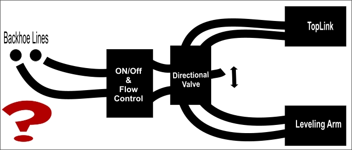

When I take off my backhoe I'll be disconnecting the hydraulic lines. I'm wondering if I can use those connections to connect to a new valve and toplink cylinder arrangement ...and maybe an arm leveling cylinder so I can adjust from the seat while working? :thumbsup: :thumbdown:

I would guess, probably not since the lines for your backhoe are either on or off when you throw the lever. With a leveling cylinder you would want the lever to stop at different times to apply or not. If that makes any sense.

Here's what I'm thinking with the shutoff valve and flow divider (i don't know the tech terms of the parts but...)
