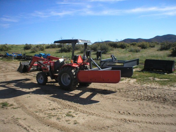

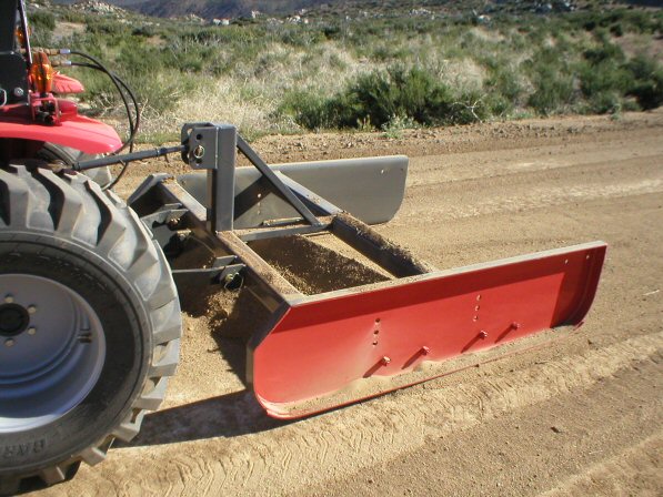

A 60 LPGS works just fine. I hope you have your tires filled. Worse case, you may need to only just let the unit down on the ground and not let it simply dig in to it's fullest capabilities. I would not get a 72" unit for your tractor.
