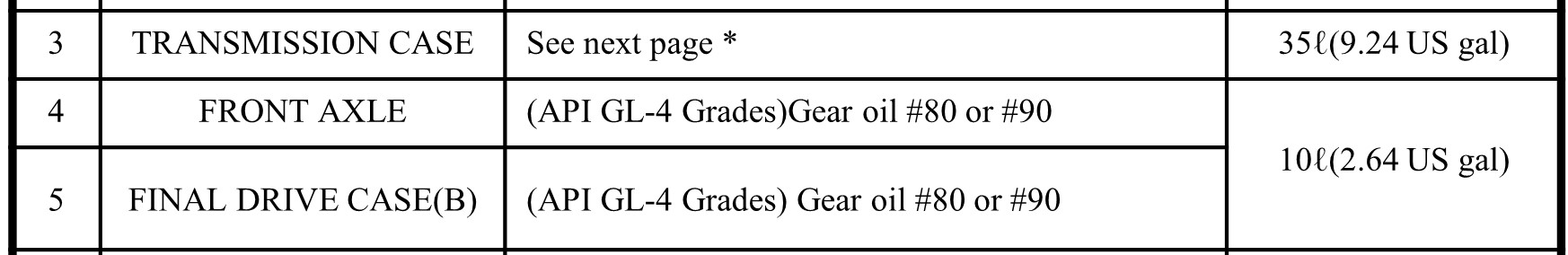

Just a note for the other RK55 owners out there who do their own scheduled maintenance.
The manual specifies GL-4 gear oil for the front axle which is hard to find locally, so I emailed them and they recommended a Harvest King GL-5 oil. I asked for clarification and got word from them that according to TYM engineering the manual is in error and it's fine to use either GL-4 or GL-5 oil in the front axle. Hope that helps anyone else looking for the right fluids for their service.
   / RK55 front axle gear oil spec #2
In my research on this I found that GL-4 is Hydraulic Fluid but GL-5 is different and has a different additive pack than GL-4.

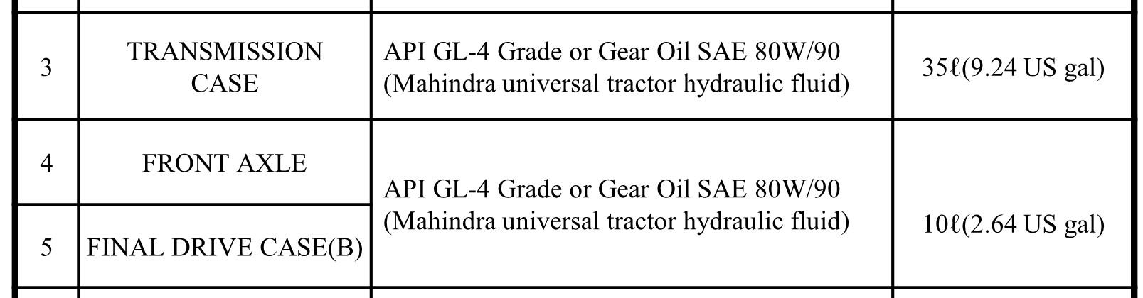

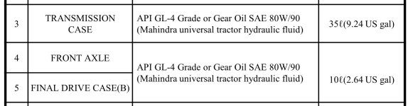

I have a Mahindra 2655 HST which is the same drivetrain as your RK55 and the TYM T554. While the TYM Manual says to use GL-4 and calls it "Gear Oil" the Mahindra manual indicates "Mahindra universal tractor hydrauliuc fluid" is acceptable for the front axle. The TYM Manual also lists different hydraulic fluids by name so what I am using now is the Chevron 1000 THF for transmission/hydraulics and front axle. The Chevron oil is available at Napa stores.
Here is a screenshot of the TYM T554 manual for the oil types:
Here is the Mahindra 2655 manual for the oil types:

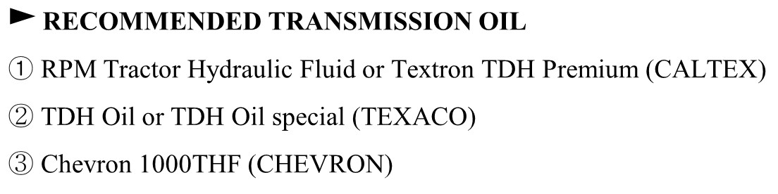

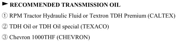

And here are the acceptable oil brands listed in the TYM manual:
