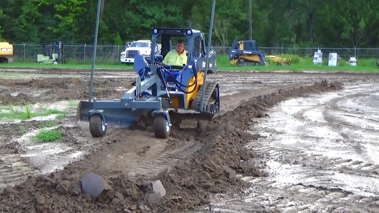

Wild idea. Do you think it's possible to make a road grader attachment for a skid steer?
Open for discussion and design input, criticism, dismissal, or fuel for thoughts on the idea.
Imagine the front end of a small grader cut off in front of the cab with a QA plate welded on it.
Pros;
Skid steer has 4 wheel drive set up located similar to a road grader.
My Bobcat 773 has 50+ hp - enough to push a blade.
Blade visibility would be good.
Aux hydraulic line could angle the blade.
Cons;
Skid steer drive wheels steer the machine so front tires would have to be fixed or swivel mounted.
1 aux line means blade angle control or tilt. i of these functions could be manual like swivel and pin for the angle
What do you think about this idea?
   / Road grader attachment for a skid steer #2
There are commercial versions. Look at them to see how it's done.
Here's the first that showed up on a search:
A short cut might be a caster-wheeled frame that used a 3-point rear blade.

Check out Skid Steer Grader Attachments | Gravel & Dirt Graders
They would very well.
I have an 8' model on a 100hp SS, it's rugged and heavy and I can highly recommend it.
The factory "grader" set ups I think would be great if I had the electric plug to operate the solenoids for almost real grader adjustability, but without this the Roadrunner was my choice.
