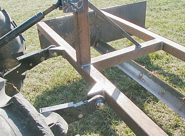

   / Road Grader
#2
Another picture

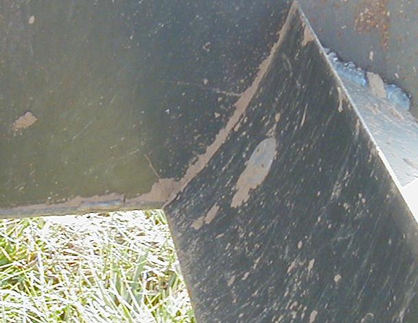

   / Road Grader
Picture showing how low the front blade sets below the skid.

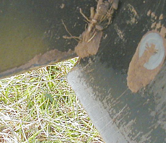

   / Road Grader
The back blade sets level with the skids. It doesn't do any cutting, just smooths things out.

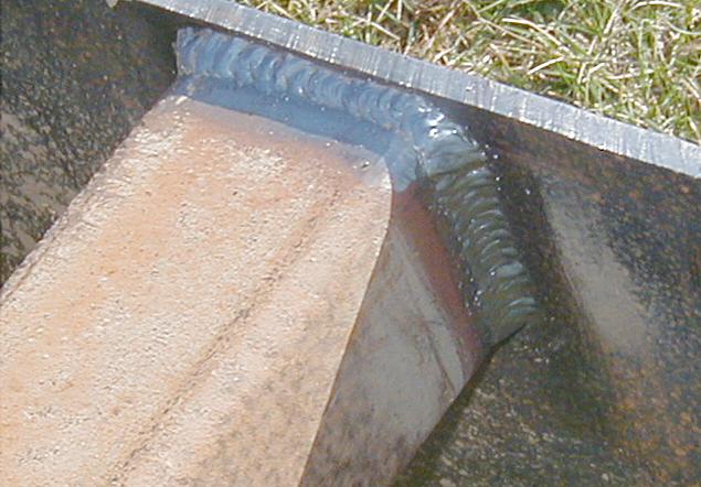

   / Road Grader
Just a beautiful weld. /forums/images/graemlins/wink.gif
   / Road Grader #7
You did a GREAT job. That thing looks like it would cut very well and smooth nicely.
I don't have use for something like that, but what you built looks like it would 'get 'er done".
Around here, people seem to have trouble with the sides of the drives needing to be brought back to the center. Some of the implements I've seen angle the front blade to pull the dirt from the sides to the center, and the rear (straight) blade smooths it.
I like the way your cutting blade is below your sides.

   / Road Grader
Ron
I got the idea from the dura grader. I was going to buy the dura grader, but the price of the unit and the shipping price drove me to just build one. I have horses that just love to tear up the land. This field is one of them. I plowed it first and use my road grader to smooth it out. I haven't used it yet on my drive way. I dont think it will help my drive cause its hard as a rock right now. It would smooth the rocks on top, but that about it. Its calling for rain here in a couple days, I'll try it out after it rains. As for the angling the front blade. I was going to do that, but after seeing SonnieP pictures of how his dura grader performed, I decided to mount them straight.

   / Road Grader
</font><font color="blue" class="small">( Great looking welds, indeed!
Nice job on the project. How heavy did it turn out to be? )</font>
I have to guess 1000 pounds cause I cant move it at all or even tilt the front up a little. By the way, that picture that shows the weld was done with a 100amp mig welder.
   / Road Grader #11
As already commented; Great Looking welds, really nice fabrication technique! /forums/images/graemlins/grin.gif
