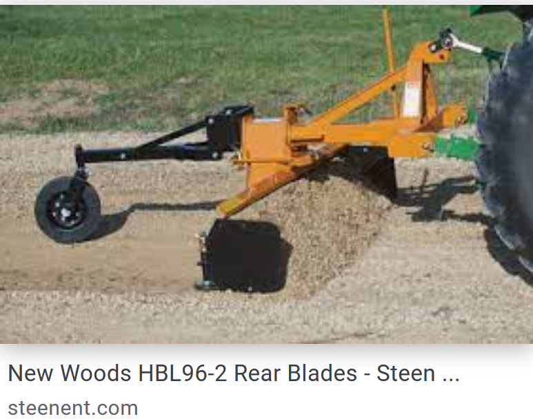

If you can afford it I'd be looking at a cabbed tractor with a front blower. With as much elevation loss along the sides of that road I would sure think you could blow the snow off never to be seen again. If you need to scrape in a few places a rear blade that can be turned around would give you some flexibility as well. Your idea of a pull blower could work also I just never liked the idea of driving over the snow before you blow it, also I'm not too sure how it would work with all the turns getting into the corners as I think a front blower would be more maneuverable for getting into little niches.
I would also think a land plane would be a good implement to maintain the road and your rear blade could aide in ditch cleaning.

8' Land Pride RBT4096 with hydraulic offset and blade angle.
7' Road Boss land plane grading scraper.

I think a rear blower and FEL plow gives me the best options, there is no way you could have blown what we received today. The snow is currently driven over a lot before it is plowed now, the current moto around here is gravity will get you down in the morning and it will be plowed before you come home from work. I am not sure one more pass with my tractor before it is cleared is really going to matter. If I am wrong, let me know.
