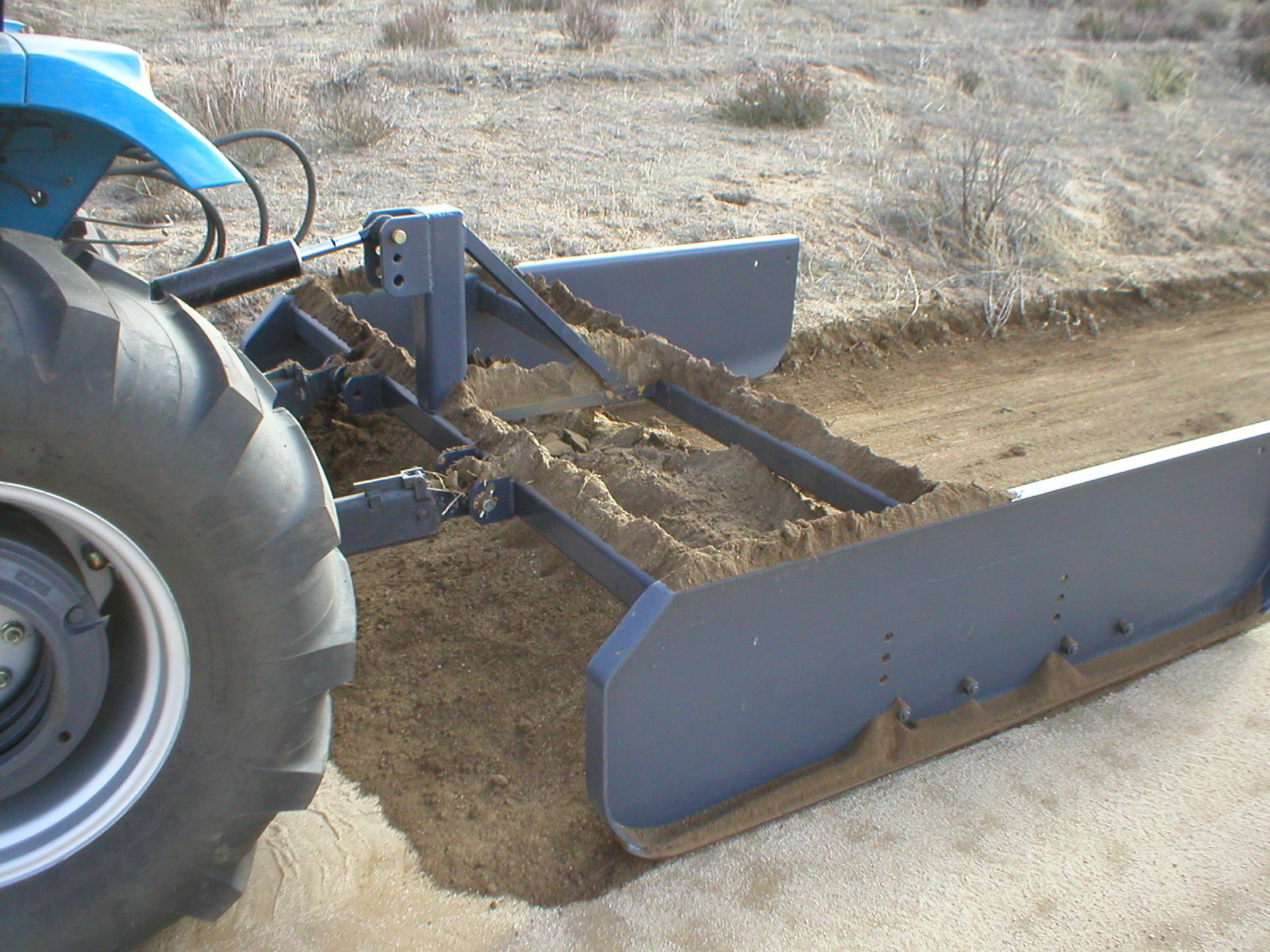

Spend the $500 for the 72" long unit. Longer is better, plus the additional weight will be beneficial.
I have an 7' unit that is 1400lbs, 84"x 22" sides. With the right conditions I can easily fill it up. Moves a LOT of dirt when needed.
