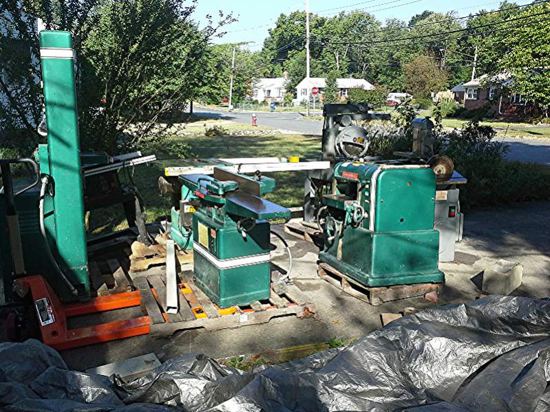

If you have not found it yet Practical Machinist has a LOT of info on building your own. I'm in the same situation. I bought about $1K worth of 3 phase tools:ForumRunner_20131014_174713.jpg
about 2 years ago. Based on comments at OWM (old woodworking machines) and Sawmill Creek just the planer was about worth that.
Everyone bragged that one could easily pick up a 3 phase motor for a converter for $10/HP. BS. I searched for over a year before I found a 10HP for $150 in good shape.
There's a good seller on ebay, Phase-Craft, that seems well respected and sells everything but the motor for a 10hp unit for $220. Thus for about $400 I should be able to put together a unit. BUT due to a 1,000 other things I've not gotten around to buying that and hooking it up, hopefully this fall.
I read and viewed a lot of guys just running one by starting it with 220V and a rope. Not the safest but might do.
