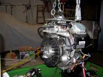

Myself and a friend both bought a 422s and are using them in the Pittsburgh area. Both refused to start around freezing or below, which has been a huge PIA.
Here is what we have learned as we pursued this in parrallel-
Changed to Autolite 64 plugs - small improvement.
Initally Robin America told us it was the starter. I got a 1 kw starter under warranty to replace the stock 0.8 kw starter. Pulled the engine and put it on. This did not fix the problem. It did help a little.
Then Robin told us that after engine serial number 1016365, their coil manufacturer gave them weak coils. Replacing the weak coils solved the problem in their tests at a temp of -4 C. I just pulled both hydraulic pumps off and pulled the engine to put the good coils on. These seem to have made a huge difference. The "good" part number is 263-7820101. The good coil is larger and has more laminated core. Robin provided these under warranty. Robin would have paid to have someone else put them on, but I don't like others working on my equipment. If you have an engine lift, it is about a three hour job.
I added syntetic oil to the hydraulics and the engine (ouch). This also seems to help significantly.
The bottom line is cranking speed and spark strength seem to be the key. Calling Robin and getting the good coils is a must.

welcome aboard. Where in the Pittsburgh area are you located? I am near Ligonier and I have had a 422 for 3 years, I agree this last cold spell we have been having makes it difficult to start the 422. I had my gas filter plugged with a combination of dirt and water I think, first time I have replaced it in 400 hours. Mine would not start but it was because it was not getting fuel. I have found in the past it helps to put the battery on charge for a while before starting.

The battery charger would help both with the cranking speed and spark. I have used a charger on the 50 ampere start setting on occasion to give me that little extra for starting. I have also used an oil heater on the hydraulic tank and front pump.

I contacted both Robin-Subaru and PowerTrac, but with no luck. And never any mention of the coil issue. (How did you become aware of this???) Between PowerTrac and Robin-Subaru I was told of five different spark plugs to try. I tried them all, but no luck. I also tried a new higher cranking power battery, but this did not do any good. I have struggled along till now, but had just made arrangements to take the PT422 to a Robin-authorized warranty dealer to have it looked at when I thought I would check this board. I have to check my engine serial number, but I'm betting I'm in the same range as you note. So, its off to a dealer I go with this thread in-hand.
