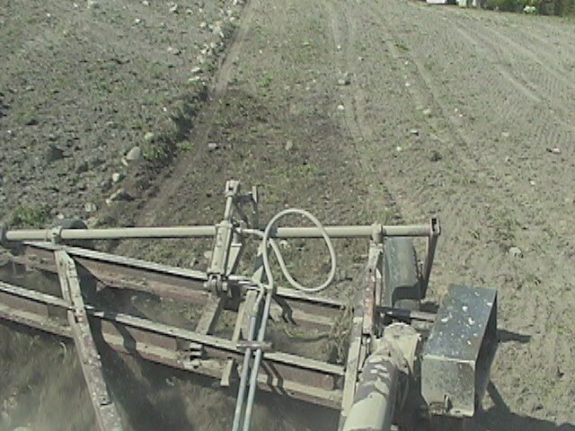

I think your observation is correct. But the small stuff disappears under the tractor's nose. End up guessing & taking a lot of topsoil.
I finally bought an older Deere SS with several buckets one of which is a manure fork which I welded some 1" hot rolled out past the fork tines. Makes for super visibility and easily digs/picks smaller rocks.
Also added a tractor pto powered rock windrower that sweeps a 9' width putting the little buggers in a row for fast pickup.

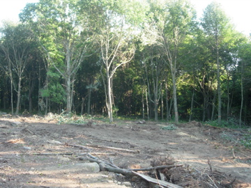

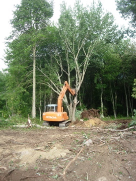

Guys - Some great ideas offered but I wonder if these are the right tools for the stage I'm at. The land area that I am clearing had large rocks( which I will grapple or use an excavator), medium rocks, broken roots, branch bits, and invasive vines with roots. It is not perfectly flat anywhere so I was thinking that the rock buckets by Bradco, Precision, Houle, etc. were possibly the right tool for the job. I will see if I can get a photo into the thread later to show what I'm working with. Thank you.
   / Rock Bucket Question
I have added a couple of pics I had on hand. I will try to get better pics up shortly...

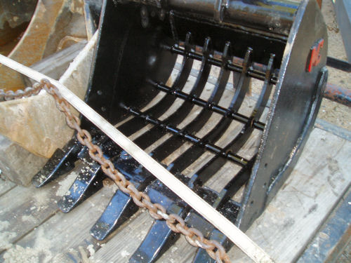

   / Rock Bucket Question #8
I had this bucket built for my excavator and it works great for stone wall building.
