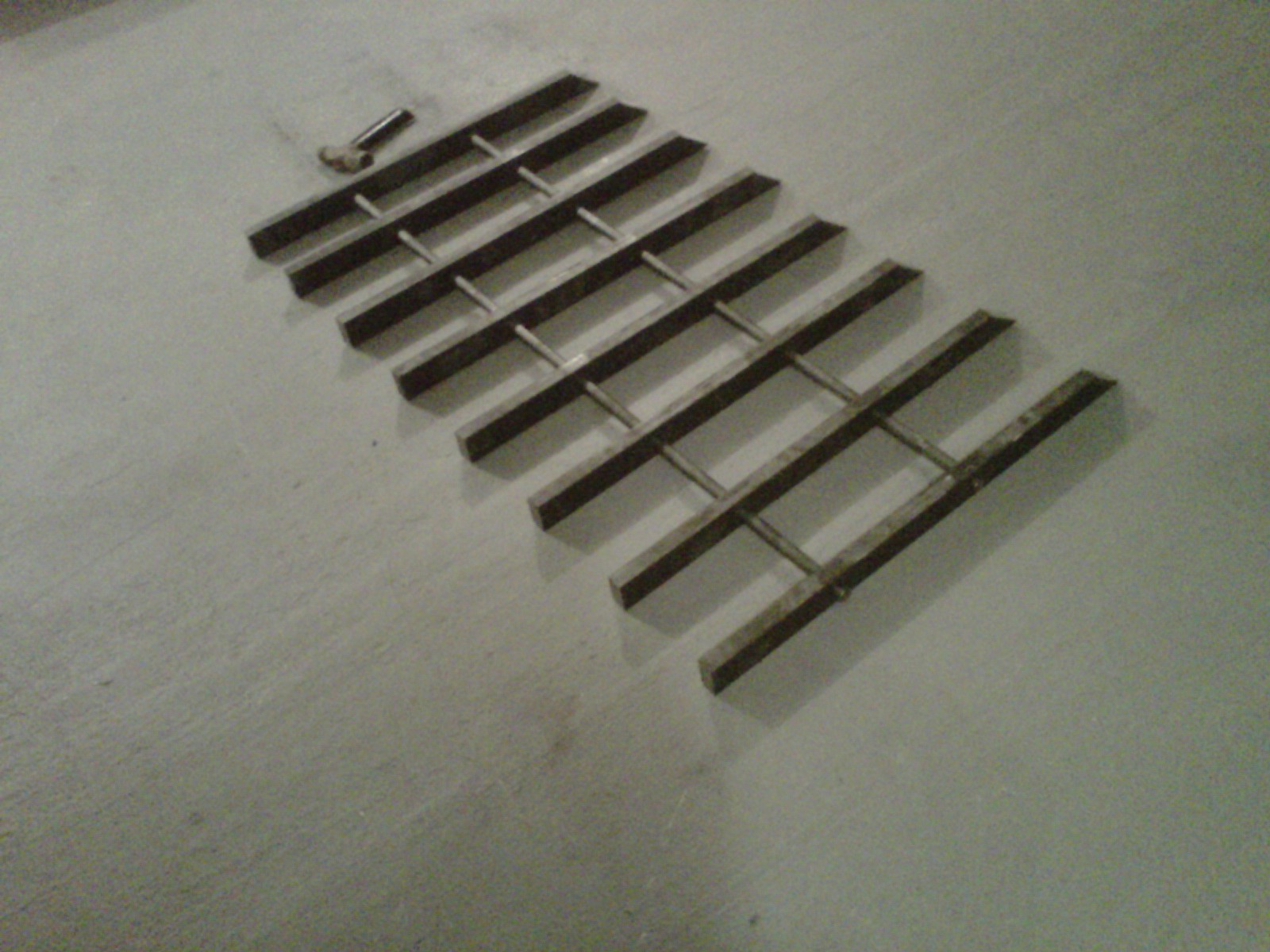

Just wanted to show you the rock bucket I started to build. I was looking to buy one and wanted it only 48" to fit between trees, buildings etc. Picked up the steel yesterday afternoon and started work. Basically it is 1'' x 2'' flat bar with 3/4'' round . The property I bought grows rocks. I have only lived there less than a year, but I seem to have a bumper crop.

Rodsauder, what spacing are you using on your bars. I am thinking of building one myself and looking for ideas.
   / rock bucket
I have gone with a 6'' space between tines, I cut the 1'' x 2'' @ 30'' to maximize yeild on a 20' length (no waste). I will post another pic when I get the back and sides tacked into place.
