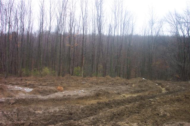

I want to remove the many rocks on top of a septic field. I think a rake would do the job, but am worried about the tractor weight on top. Any ideas how to do the job without damaging the septic field? Thanks.

   / Rock removal on septic tank field #5
I used a york rake on mine the key here is not to dig or rip with the rake.
let it float- take your time make small piles with the rake do not try to do it all in one pass.
nice and slow-- wheels on the rake would be a plus
