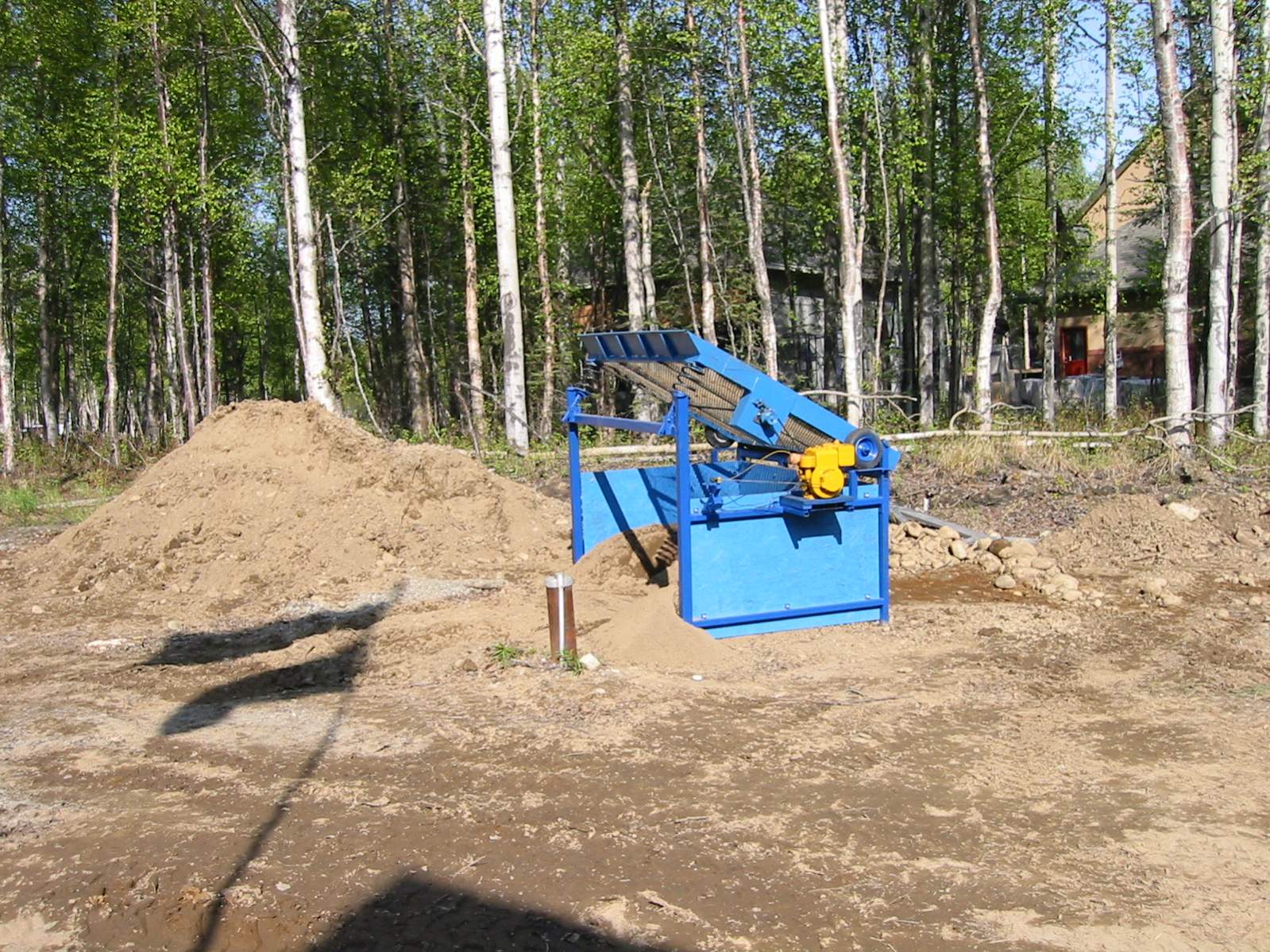

My brother made this last week and we tried it out today to see what kind of bugs need to be worked out. It ended up working real good and the only bugs were, needs sides on each side on top and bottom grades, and a guard over the motor. The bottom half well be closed in on 3 sides and it well have shouts off of the top and middle grades. That way if we want we can load right into my dump trailer.

I like the dual screen idea, I built a single screen one a year ago, but having two screens would be nice. What are you using for a viberator?

Sure like your shacker. The bottom part well be like you have. With the 2 screens that gives us 3 sizes. top as you know is the big junk, out of the 2nd we are getting septic size, and what is left is the sand & pea gravel size.
The shacker is a flywheel with weight removed on one side and added on the other. Sure shacks it. The fly wheel I made years ago and was used on a weed eat. At the time I couldn't find anything that would hold up for the blades. After the big string came out it worked good, just to heavy.

I watched youtube of the shacker and it looked like it work real good. Do you use yours much? It looked like his might shack more, I wonder if it might be to much. After he gets the sides on, we well give it a good workout and see if holds together.

I also like the dual screens. Let us know how it works and maybe what ratio of finished material you get from one screen to the other?
I was going to build a coarser screen on top of my fine screen, as well.

Update on Shacker. Have it aready to start work. Well be doing that one day next week.We well be shacking most of the day if everything holds up.
Here are more pictures and I'll post some after we run with it for awhile.

Very interesting build. The dual screen is a plus if you have need of segregated materials. I will be interested in seeing the after results. Post some more pics closer up so that we can see the construction a bit.
