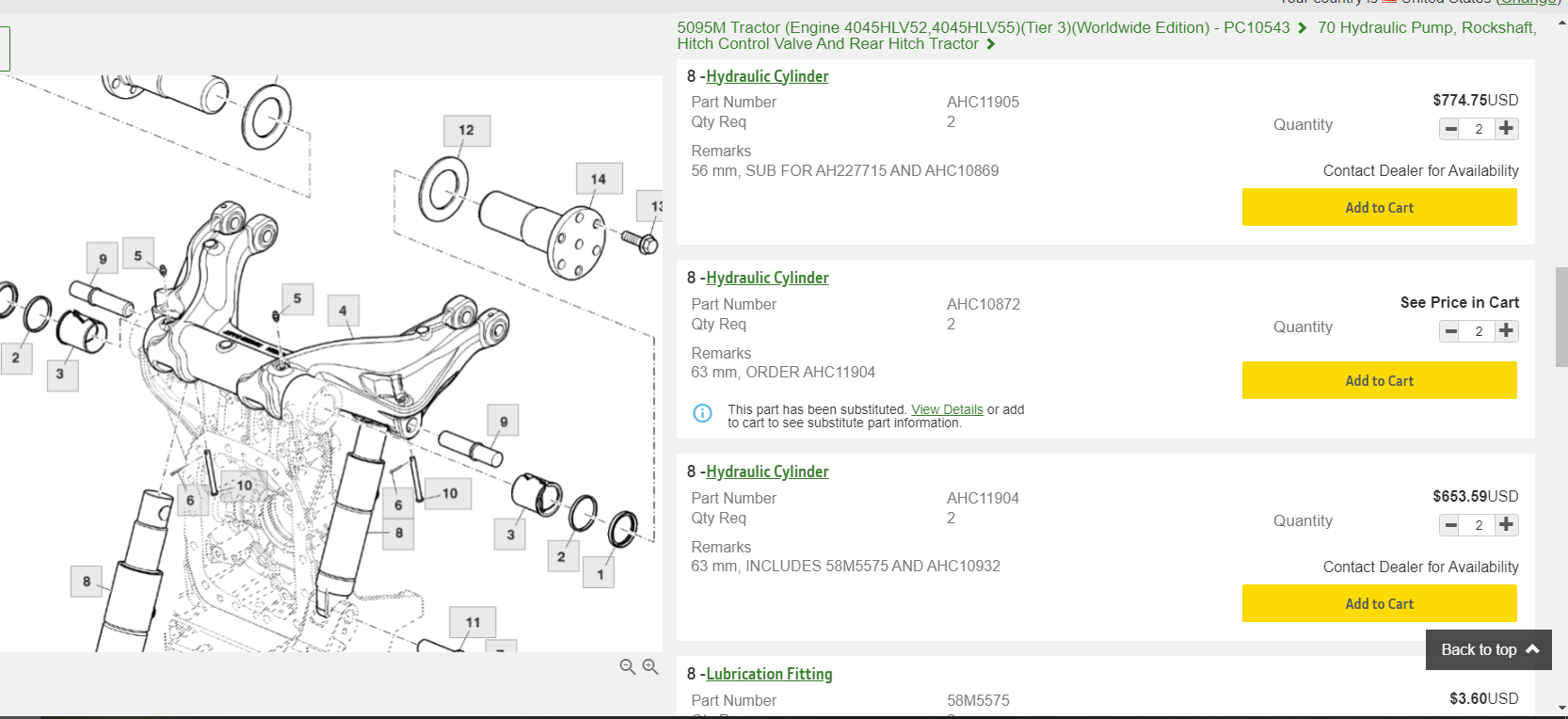

Thanks for a quick response. I think from the John Deere parts list, the 5095m could have 3 cylinders. A 50mm, a 56mm and a 63mm.
The dealer told me they list a seal kit for the 50mm and the 63mm, but none for the 56mm. The seal kit for the 50mm is $100 and the seal for the 63mm is $29. I am not sure of the difference.
I measured my cylinder rod and it is the 50mm.

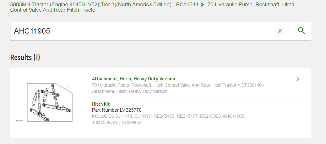

What's parts schematic are you using to locate that has 50mm rear rockshaft cylinder? I'm only locating 56mm & 63mm diameter cylinders?

It is listed on the schematic for the 5095MH.
This is what I was told at the dealer.
The 50mm cylinder was used on the 5095M and 5095MH for North America distribution with 56mm as an option.
The same tractor for worldwide distribution used 56mm as standard and optional was 63mm.
To make it more confusing, I found a Deere literature that listed a 70mm and an 80mm for worldwide distribution,but that was tied to a transmission option.
Dealer just said measure the cylinder rod to determine which size cylinder I had.
All confusing, so that why I posted to see if anyone had any experience with these lift cylinders.
Thanks for helping

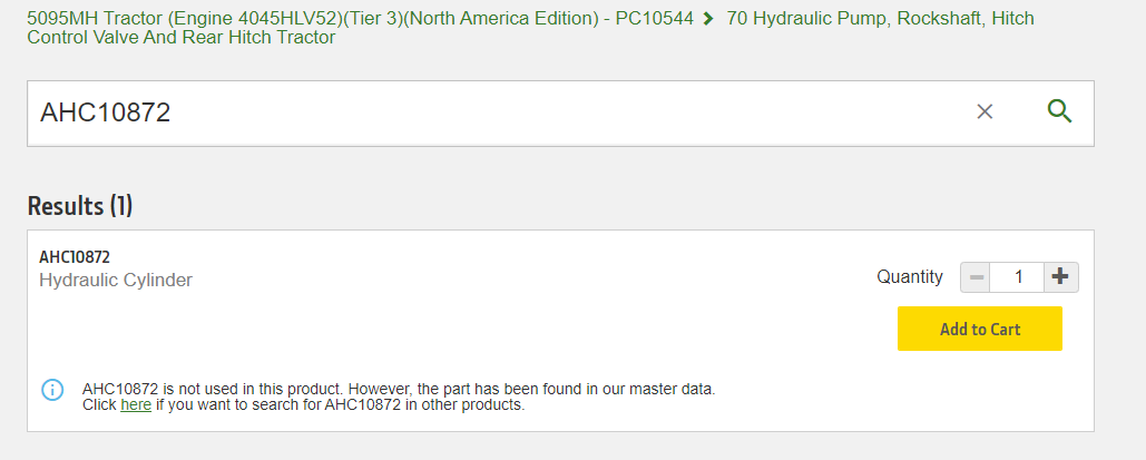

   / Rock shaft lift cylinder #8
My 21 yrs experience of being previously employed by a JD dealer working many hours in parts dept. that after performing some parts number research notify me that the 50mm(AHC11906) was designed to fit the 5095MH only & the 56mm & 63mm(AHC10872) were designed to fit the 5095M. I have not idea what the M(H) represents.
