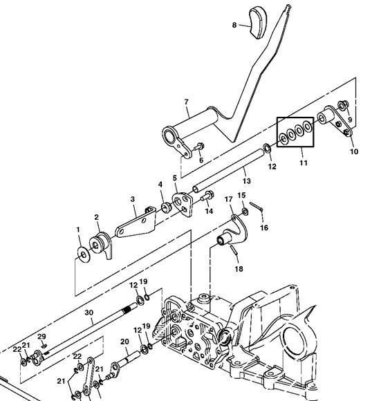

Ihave a 3203 john deere , the rockshaft lever is very stiff. The John Deere site said I need to adjust the rockshaft friction disk. Does anybody know how to adjust this?
   / rockshaft control on JD4200 #6
:welcome: to the forum
Here is the friction nut #9 that you need to tighten. #11 are spring disks that make the friction to hold that lever in place. This is correct for the 3203

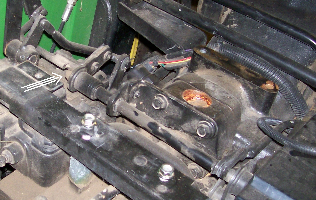

See the locknut item #9 .. loosen that and see if you get freedom from binding.
Yours likely looks like my 4300, and the white arrow is pointing to that locknut.

   / rockshaft control on JD4200 #9
thank you. I will try to loosen that nut. And then check the bottom shaft to see if it is stuck. I know the pin is broken
   / rockshaft control on JD4200 #10
Where is the roll pin that is said to be broken in this photo if you happen to get the reply?
