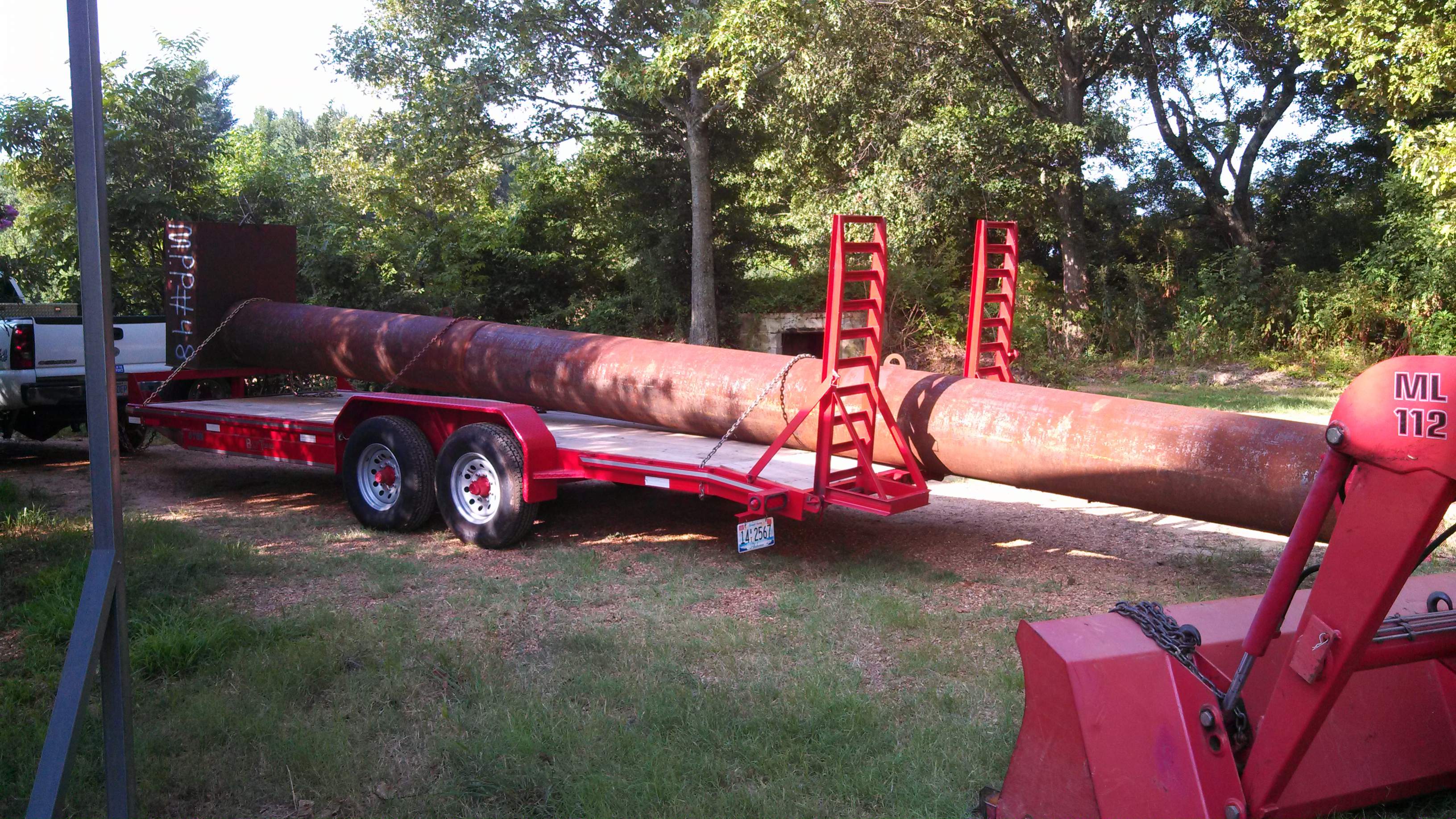

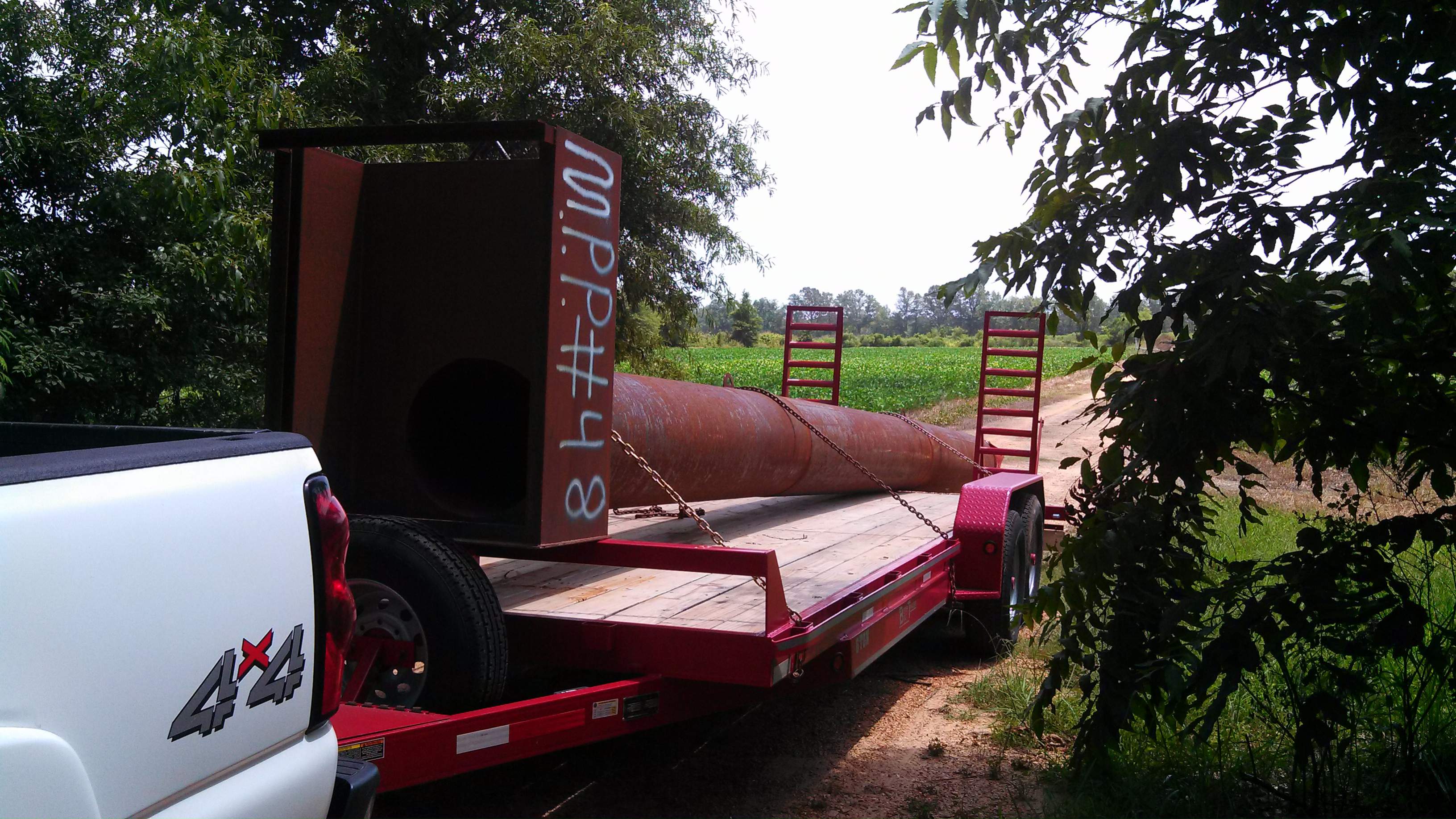

Project-
Weld 2 pieces of pipe together in the yard with Miller Thunderbolt AC/DC machine.
Details-
Pipe is slightly rusty and dirty 16" diameter 1/4 thick that was cut into with a saw. Edges are fairly clean and straight.
Pipe is part of a Water Control Structure that will be buried in a levee to control water level in a natural wetlands.
I know some of you guys know exactly how to do this the easy and best way and will be happy to advise a 'Rookie" !!
:thumbsup:
Not this pipe, but a old 16" one already on the place

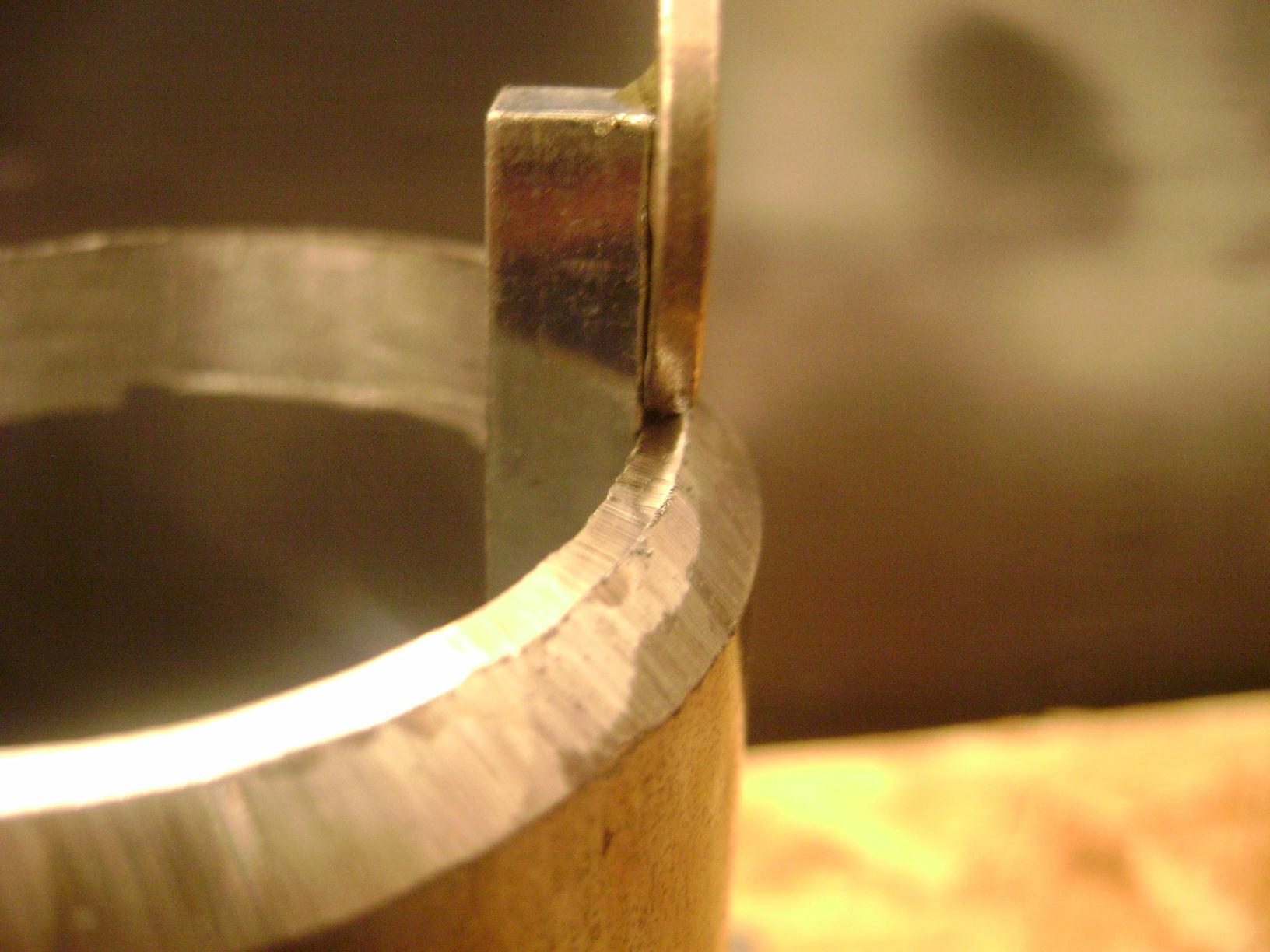

Here are some pictures of how I fit pipe. Now remember this is for all up hill welding. And on small dia. pipe. So you'll want to make your tacks longer.

The only thing not mentioned is that you must grind back on the inside to remove all the pits and rust. Rust will really mess you up when trying to make a weld. Clean it up completely even if you have to remove a lot of the material.

Farmerford as you make the root pass welds the gap will close up on you. If the gap close up too much you can always take a zip disc and slice the gap open again.
I never really messed with down hill welding. I'm not a pipe weldor. Strictly structural, in my little bitty world of welding, welding down hill will get you fired.
The last two pictures show the inside of the root weld. These pictures are not perfect, but about as good as I can do. Like I said I'm not a pipe weldor. I worked union all my life, getting caught welding pipe on a job with union pipe weldors is not real healthy! :laughing:
