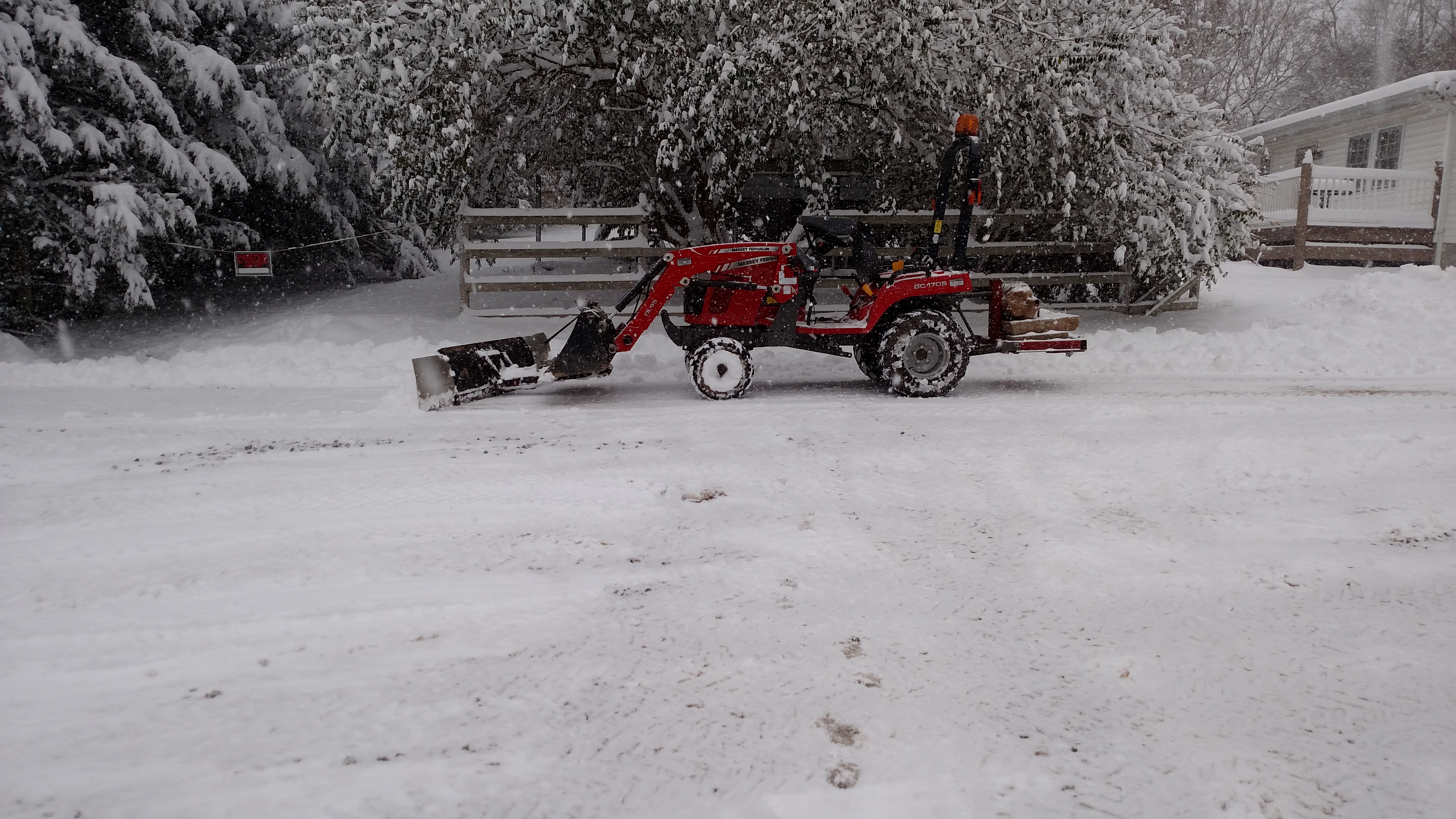

Well after purchasing an HLA 2000 front mount snowblade, I decided to go with a set of lines running to the rear remotes of tractor. I have quick couplers bracketed to the front of the FEL so I can leave the hoses and just connect/disconnect the blade when needed.
It works very well, only slightly inconvenient to have the angle on a separate lever, well worth saving about $700. (Approx 40 ft of 3/8 line with couplers at each end was about $300).
And btw, I love the front blade, we're getting another 40 to 60 cms right now. (2 feet!)
/ Roll function on snow blade? #19

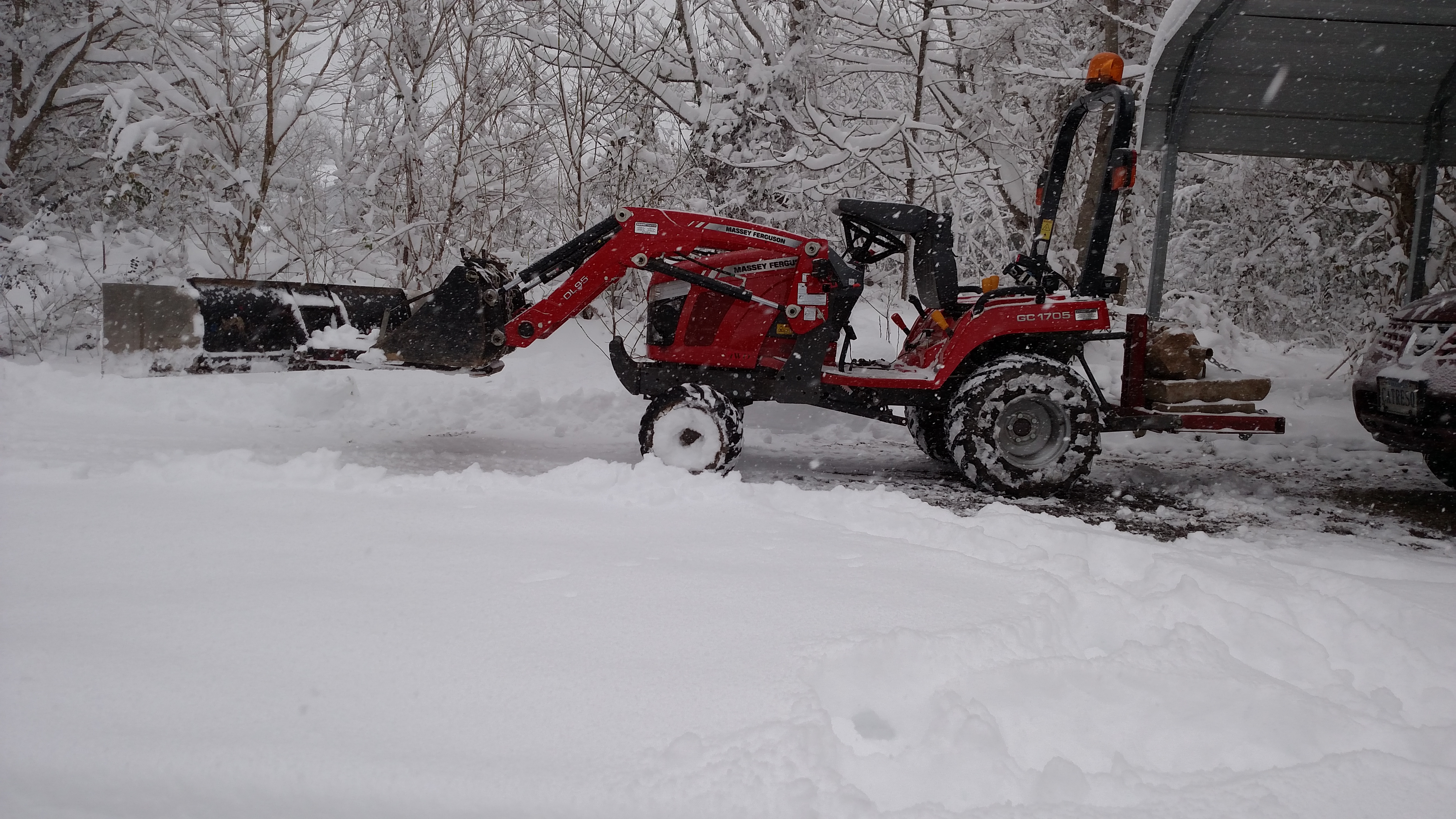

I also have an HLA 2000 blade. I think you will be very satisfied with yours. I still need to get used to a few things like the pivoting left and right of the blade on angled terrain, which will make my job easier plowing driveways that meet the road at an incline. Hard to describe, but with my previous rigid rear blade I had to watch my angle carefully so I didn't dig a corner of the blade into the pavement. I need 2 available rear remotes for a blower, so I use the 3rd function on the FEL for the plow.
#20
You were right... we got 2 feet of snow in last 48 hours... and i am very satisfied with it!
