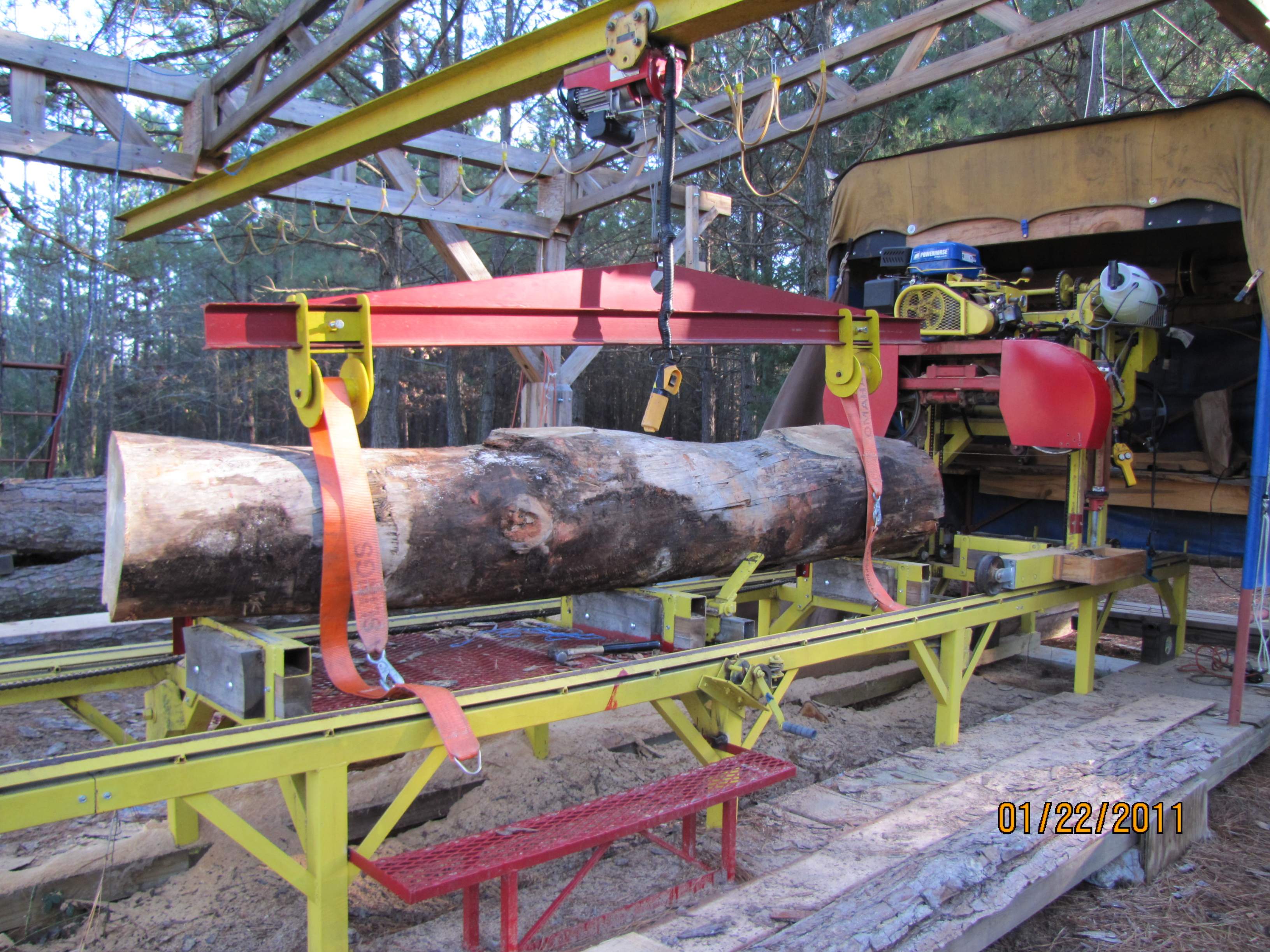

Excellent job grunt and thanks for the pics. I've always wanted to watch a sawing operation like that first hand but it's looking like the closest I'll ever get is my 9" delta shop band saw with a 3/8 blade.:D

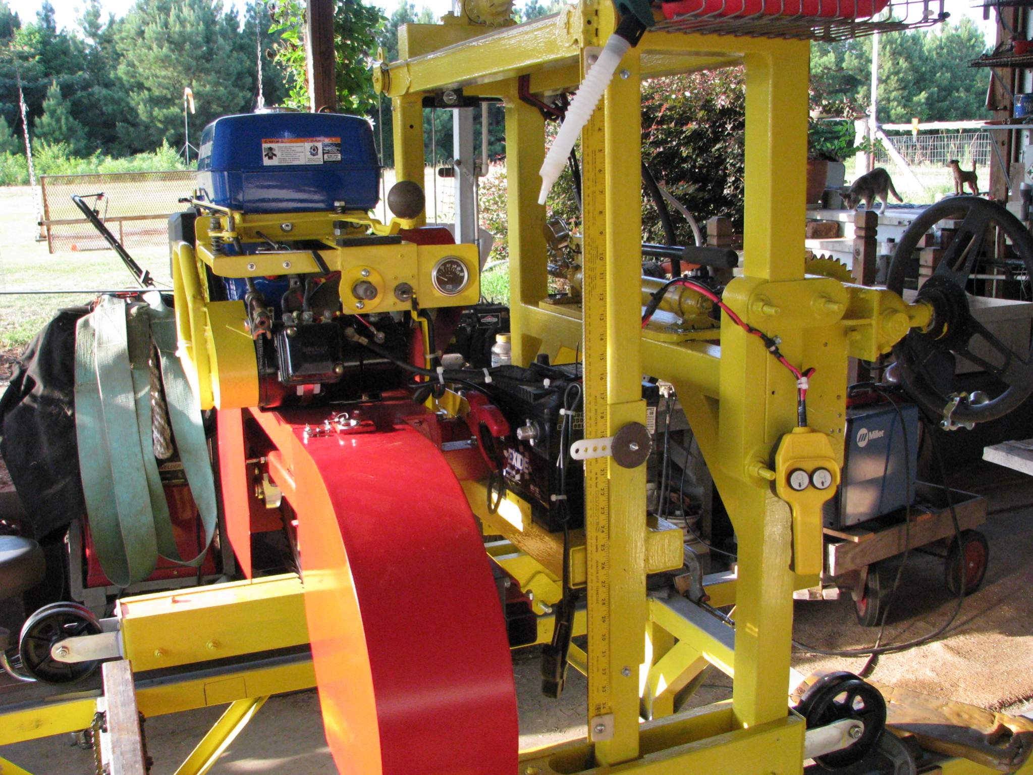

Nice looking building and setup, kimda unusual design. Electric hoist and beam are big pluses. What brand/model saw are you using? Is the bed height adjustable ?
   / roof compleated

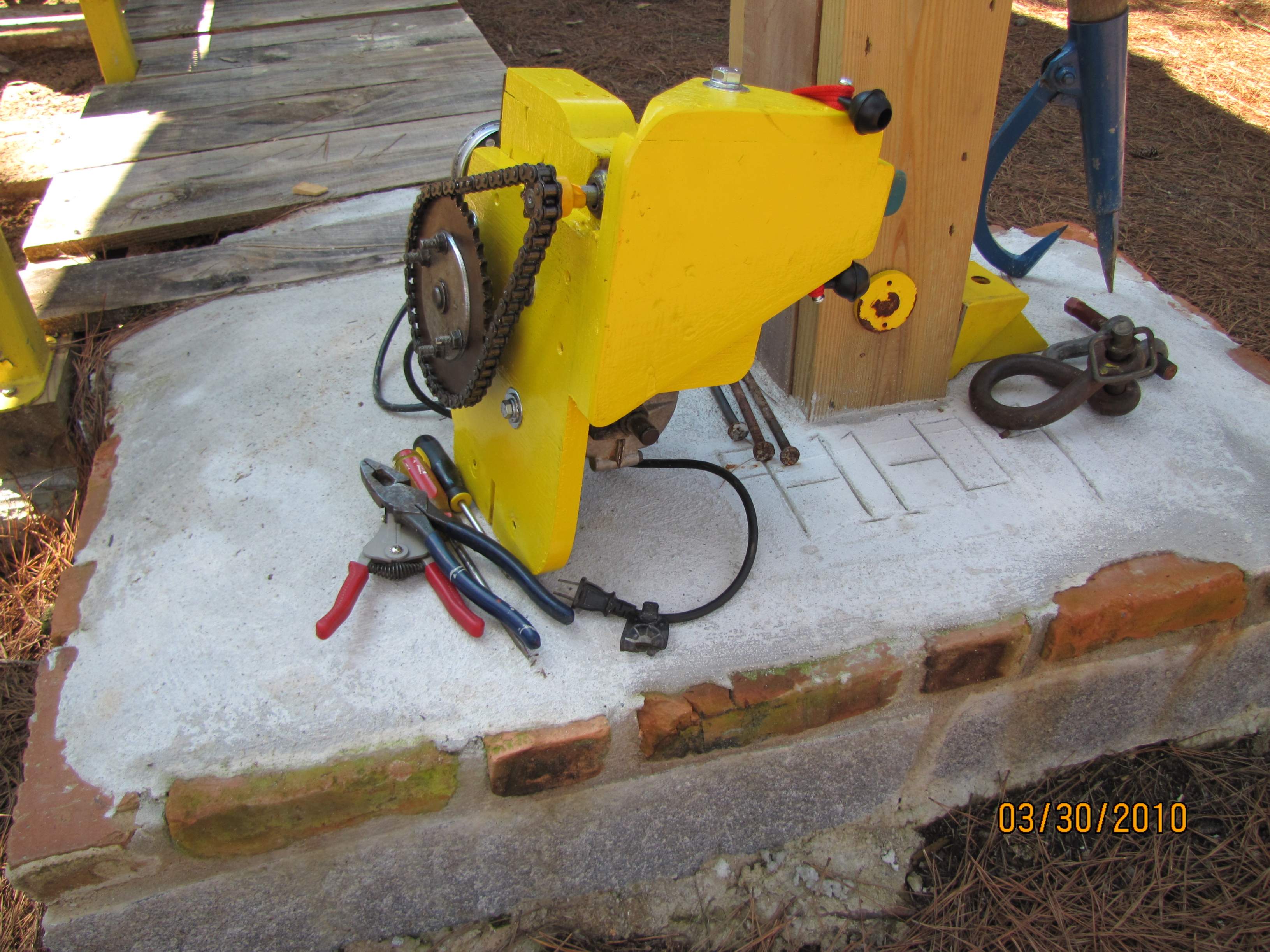

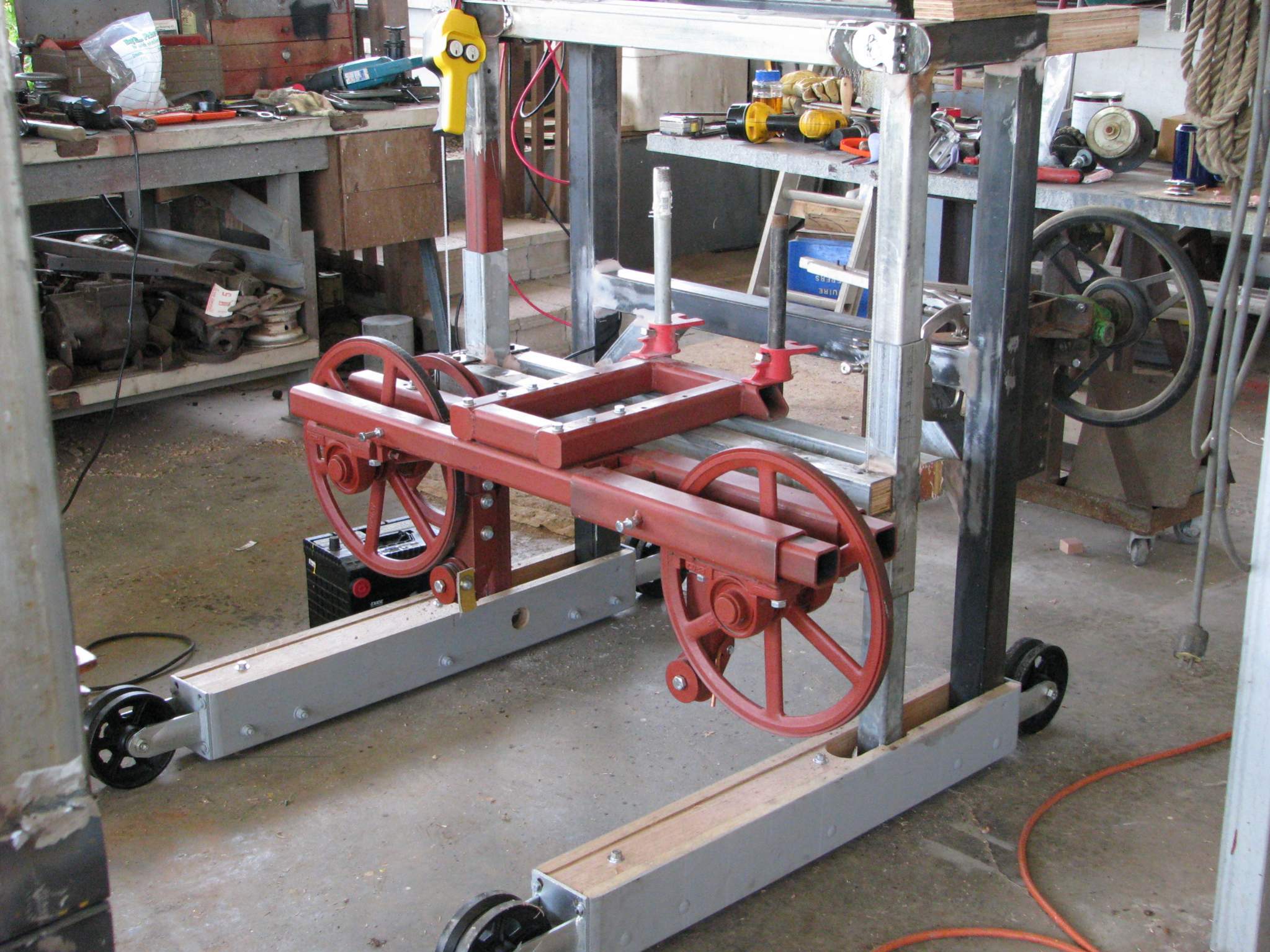

Its a "linn 1600"the saw will handle 16" log 20 ft.Fully adjustable , Its sitting on concrete pads.The power head is linn ALL the rest is my scratch built with no plans.Just pictures for reference.

Well then, you did a great job building the table. So the head travel (feed) is manual? The table is manual?
We got a Timberking 1600 and adjusting the log to start the square cuts is kind of a bear. Seems like it would be so much easier to stand behind the head and push a button....I ordered some 12vdc scissors jacks to see if that will help.
   / roof compleated

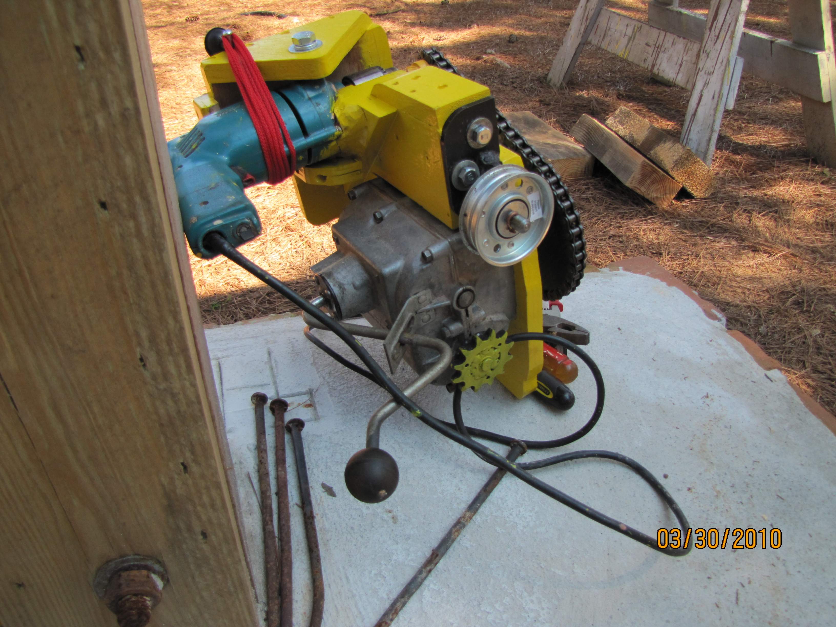

Everything that's yellow I built(from pics,No plans)It has a power feed I built using a 1/2" drill ,an a sears transmission. Using a trigger off a saws all gives me a slow start, then full speed (any of the 3 gears in trans.)All an all its really easy to use.I have a really bad back so I try to make it easy on my self or it would be a no go.

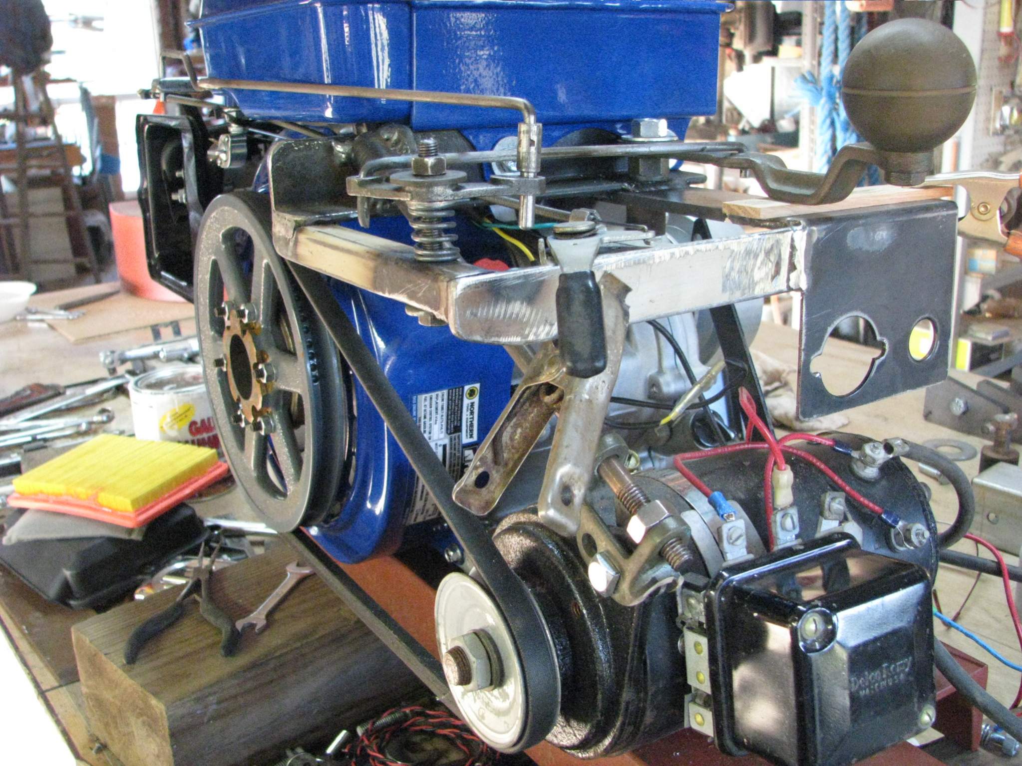

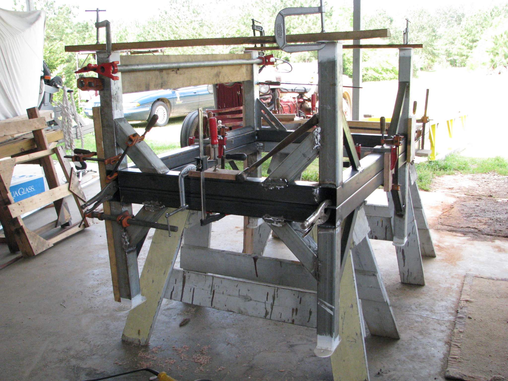

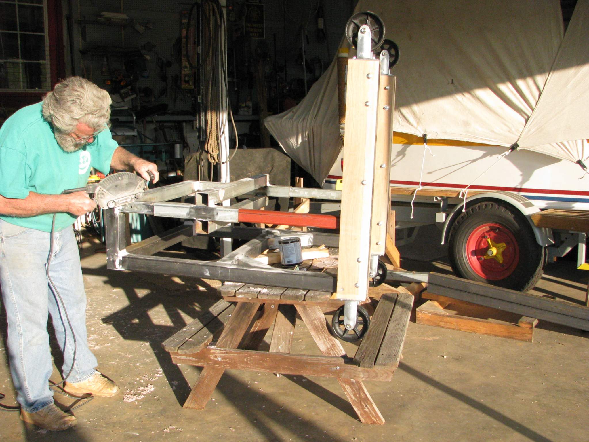

Here are a few more pics of "The build"As said above its scratch built with no plans.Even the electric starter.

Sorry, I misunderstood at first. All I can say is, WOW and Kudos. You must have an awful lot of work ahead of you, because you spent the time and effort to get to this point.
