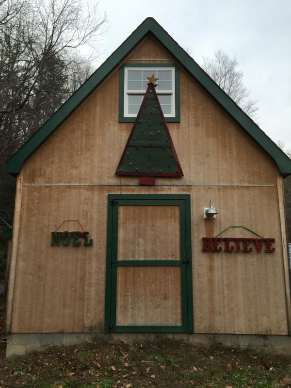

I'm installing a wood stove in my workshop and I'm having trouble finding flashing steep enough. I have a 14/12 pitch roof and most flashings just go to a 12/12. Can I cut out the high side just a tad to make a 12/12 work? Any suggestions...or sources for a 14/12 pitch flashing. Here is a pic of the roof in question....not the best angle, but you can see how steep the roof is.
Thanks!

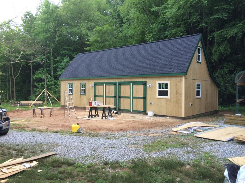

Another pic showing roof pitch

Yes.. you can cut it some.. your storm collar should cover the rest..I have had some special made
   / Roof flashing question...
Thanks, Ken. I'm figuring I won't have to cut a whole lot, but was just wondering if this was common practice.
   / Roof flashing question... #5
Being in the HVAC bus.. I've cut many.. Did you get a storm/ rain collar that goes over the vent ,and slides down /buts against against that roof jack ?
I have the collar that came with my through-the-roof kit. I might look for a wider one just to be safe
