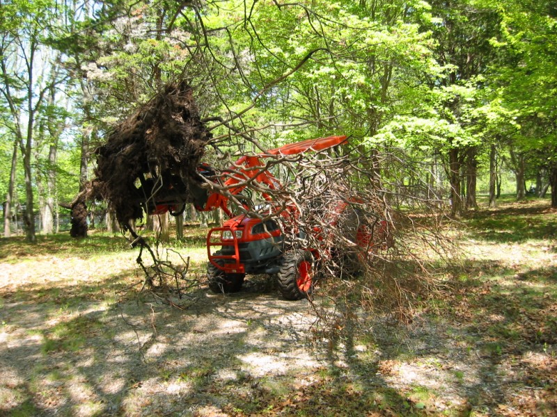

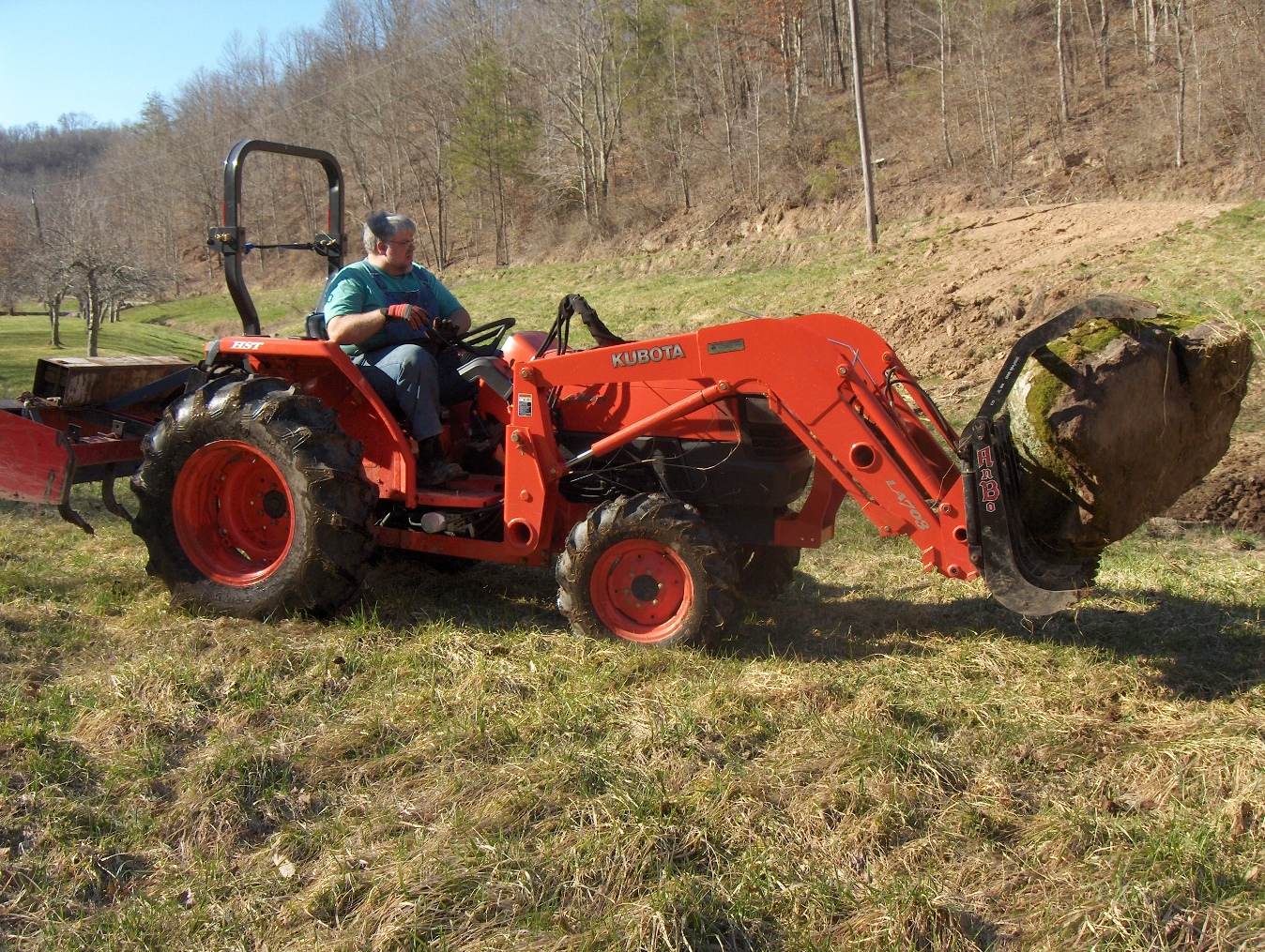

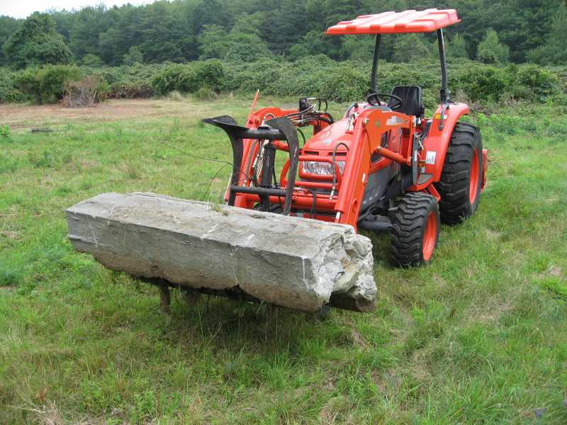

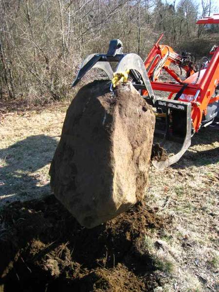

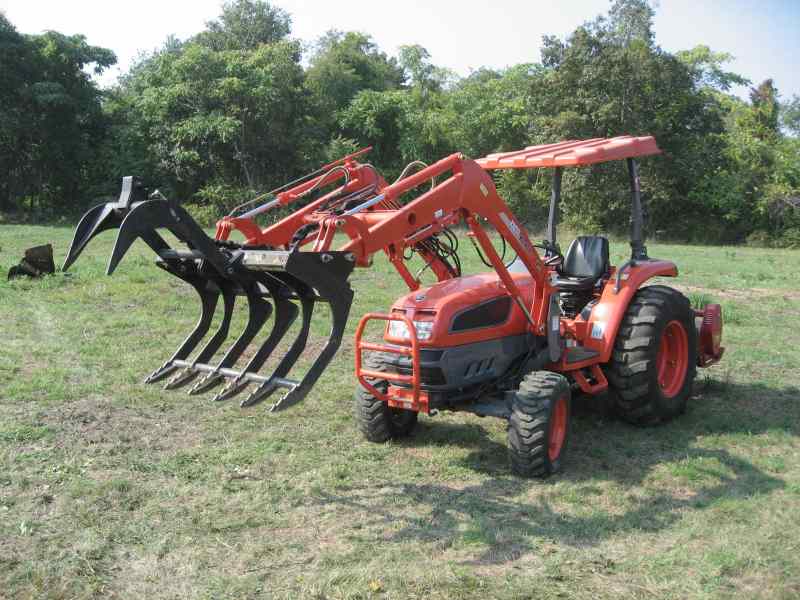

Regarding a root/brush grapple for the KL401 loader. I have a 48 inch Millonzi grapple that is roughly equivalent to the Markham light duty or the WRLong OMG style "traditional" grapple on my DK40se. Works absolutely fine so there is zero reason to invest in anything more expensive or heavier duty. Grapple plus the KL401 is a truly mean brush killing machine.
