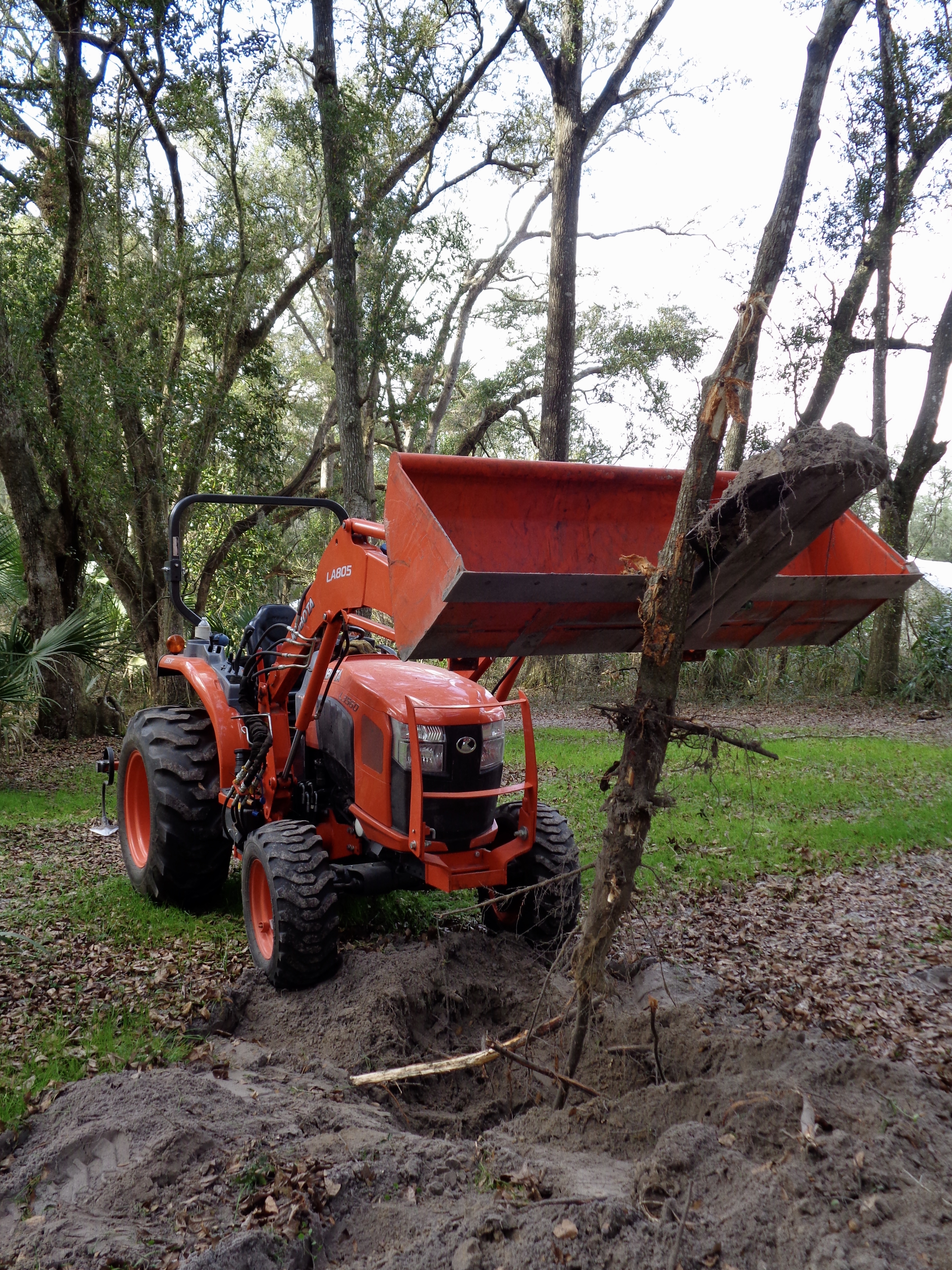

Consider a Bucket Spade if you have a tractor of around 4,000 pounds bare weight. I have used a bucket spade for seven years to remove and transplant 25 - year old Florida Rabbiteye Blueberry bushes as large as Rhododendrons in Seattle, with similar size root balls.
https://www.tractorbynet.com/forums/attachments/328798-bucket-spade-today-fel-bucket.html?highlight=

I have moved and transplanted large Rhodies 6-8' tall x 6-8' around - they are shallow rooted. I go in with my bucket and get 6- 8" or so deep and under the root ball, then wrap a strap or a chain with burlap to protect the trunk, then tilt the bucket back and take it to its new location.
IF you just want to get rid of them a root grapple will work well. If you don't want to remove topsoil, then just cut them off at ground level and grapple them away.
