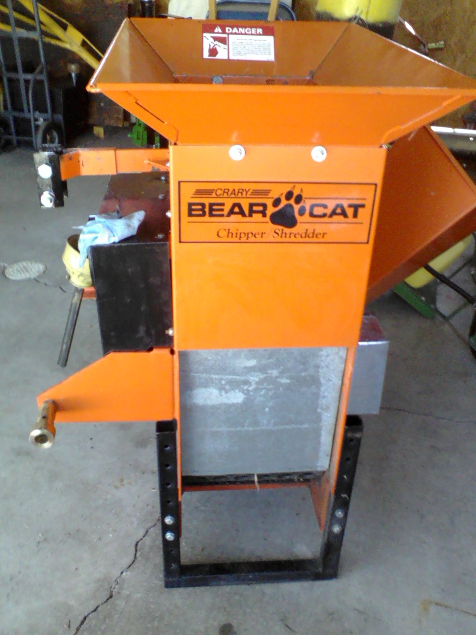

When I have to deal with brush, I don't use the chipper part of my chipper/shredder much at all, the shredder does 90% of the chip making. Either way, it is a lot of work! Sometimes I wish I had a grapple and a match.
