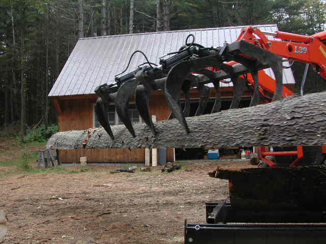

Have had my L-39 for about a month now. Love the tractor and the attachments esp. my root grapple (JRW 72") which has allowed me to move a lot of material and logs.
My problem is the grapple has fallen off 5-6 times with the last being today when it came off while I had it raised and ruptured several hydraulic hoses. :(
Any suggestions? Is there a way to adjust how far the pins of the disconnect go into the implement opening? The grapple seems to pop off the bottom. Sometimes I have a full load, sometimes nothing. Today I hadn't picked anything up yet. Does seem to be when the grapple is curled down. Should something be welded onto the opening for the quick connect to make it deeper?

Something is seriously wrong and that is very dangerous. That grapple should never fall off. Do the bottom pins of the QA adapter engage fully? Does the adapter locking mechanism loosen up? Is it properly adjusted? Is the locking mechanism for the adapter coming loose and opening? You did not specify whether you have the Kubota QA or a universal "skid steer" QA. I don't know how the Kubota system works exactly but I presume your dealer knows about this problem and can help. Different QA adapters have completely different strategies for locking the implement in place so it is hard to troubleshoot without knowing more about your adapter.
Sorry about your problem. Please do post when you figure out what went wrong.

After I mount an implement on the FEL using the QA I raise the FEL and make sure that the pins are always engaged (pass through) in the plates. As a result I have never had an implement fall off while in use.
I will say that more than once the pins did not fully engage because of dirt or mud but it was caught on inspection.

I do pretty much the same thing. I raise the the FEL arms and inspect the implement, first from the seat, and then from the ground before I hook up the hydraulic lines. That way, if something goes wrong, I don't lose any hydraulic hoses.
Several times, I have caught a situation where I had to set the grapple back down on the ground and re-lift with more, or sometimes less, curl in order to get the grapple, or the bucket, to seat properly. On my JD 110 TLB, with standard skid steer attachment, I must lock the pins from the ground. I always make certain that the implement is no more than an inch off the ground and always contort my body to do the locking so that I am in no danger if the bucket or grapple falls off.

Good idea. The other thing I do after picking up the grapple with just the top lip is to curl the bucket so the weight of the grapple tends to push the bottom of the grapple into the correct position for locking. It is also pretty easy to feel when the pins are locked on my adapter.
The more I think about this the more it seems catvet is either having trouble locking the grapple on or the adapter locking arms are coming loose due to a poor adjustment. When my adapter was new there was a nut that backed off one side of the locking arm mechanism that prevented the lever from locking in place. I tightened it and it is now fine. From the little I can tell on your loader it appears you have the proprietary Kubota style adapter and I don't know if those have a similar mechanism. Your dealer should inspect it to be sure and also so show you how to determine the adapter pins are locked before you use the implement.

Seriously though, that is a real problem. What is the type of grapple you have? Maybe you could post a photo of the grapple attached to the loader with focus on the pins. I bet it may need to just get broken in some so that they fit and lock into place. It sounds as though you have been using it without the loader seating in place and hence the pins not fully locking the attachment in.

If that is the Kubota quick attach adapter, I have heard of people adding washers under the springs on the pins to make them a little stiffer and not let them back out as easy.. Have the adapter on the L3130 and every once in a while will notice the bucket pushing on the tapered section of the pins and they will back out some but have never had the bucket fully disconect. You may also curl the grapples back some so that they have a rotational force against the back of the adapter because if you have it curled all the way forward you are carrying a load on those pins where if it was a bucket or forks they would be pointing down and usually empty.

I posted this reply on 26 April 2006 re: "grapple comes loose". I welded 3/8" angle to the bottom of the grapple plate where the pins engage. It was a quick simple fix that has not failed.
