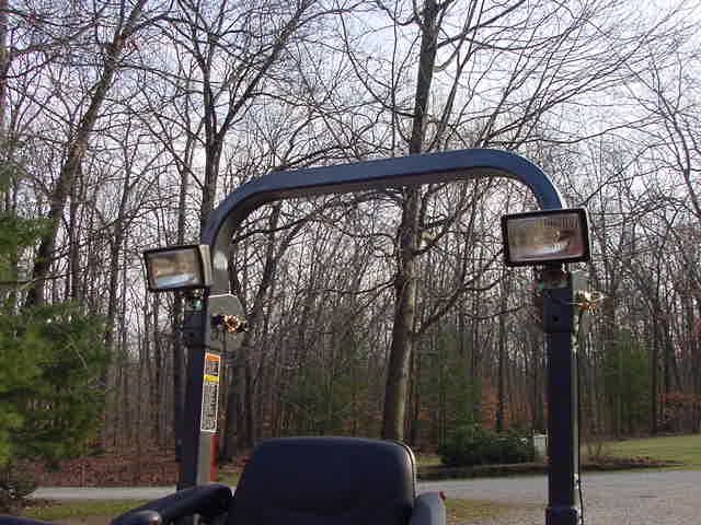

The following is purely hypothetical. Let's say a may tries to drive his Kubota into his garage while the ROPS is fully extended. (As I say, this is purely hypothetical. This would never happen to me. And, furthermore, would never happen to me TWICE.) Now the ROPS top is jammed into the garage-door frame. The only way free is to back out. The door frame is left a little splintery and the ROPS now has maybe a quarter-inch of extra play in it, though it is not bent. My hypothetical question is: Is the ROPS damaged to the extent that the man needs to have it repaired? I present this question purely out of the spirit of open discussion.

Where is the extra play coming from? Tighten it up and don't worry about it; IMO
   / ROPS damaged? #3
As long as there is no structural damage to it and it's only "loose" I would have to agree with dgdave1, tighten it and keep on tractoring.
   / ROPS damaged? #4
You haven't stated which ROPS you have: Folding or Non-fold ... if the later, I would think the hinge pins/bolts could possibly be tightened. I noticed in a recent VERY cold spell, the pins contracted in the cold and loosened up substantially.
If you have the non folding ROPS, I would have it checked out THOROUGHLY. NOONE can afford to have that part of their tractor fail.

A ROPS is a very solid metal structure. I really don't think that a garage door frame would damage it. Retighten the hinges' bolts and you should be fine.

My ROPS has a bit of play at the folding joint that I never really noticed until I was driving over some bumpy frozen ground and it was flopping back and forth a bit. Is it possible that the play was there all along but the hypothetical man just never noticed it until he gave it a critical inspection after the "incident"? I plan to make some little wedges to take the play out.Not for any functional reason, just so I don't notice it on bumpy ground.
