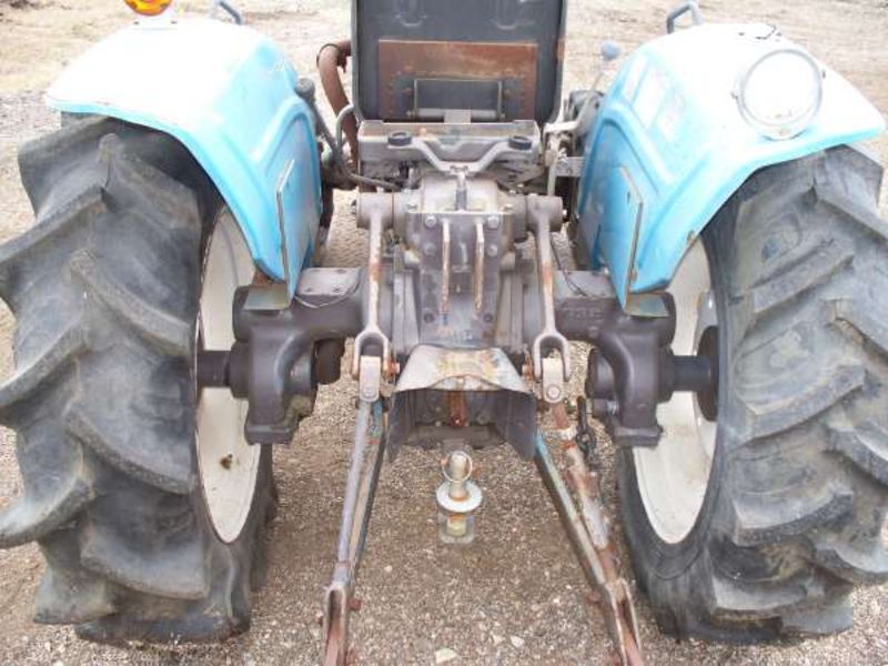

My son in law's brother is an excellent welder and would build a ROPS for my D2350 tractor.
However, I'm not sure how to design it and where it should attach to the tractor.
Anybody done this before?

284 brings up some very valid points. Homemade ROPS can be very safe or kill you. I had seen the posting where the 14 yr. old was killed before and it is truly a shame but this is a prime example of people using correct ( or even approved) materials then not being educated or aware enough of the other factors involved in completing a safe ROPS system. My Mitsubishi is very similar to the CIH 254/255 tractors and I'm not sure if that is why it has ROPS mounts on the axle or if it was for some other reason but it is a grey market model and was not fitted with ROPS from the factory. I did however make my ROPS and use the factory tractor mounts.
The 2350 has a different rear axle than my tractor but appears to have similar mounts. I would not trust those alone however. I would utilize them, tie the ROPS into the transmission housing as well, much like JCJethro did on his tractor and probably to the fenders as well, even though they have almost no structural integrity. They are right there and the ROPS/fenders can lend support to each other. If you are considering building ROPS there is a ton of information online concerning the common reasons they fail. Educated yourself and if you decide to do it, use proper materials, attachment points and fasteners and related welding.
