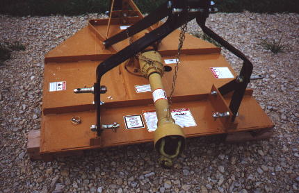

I need to lower the 3pt pins on my 4ft rotary cutter to allow higher lift capability on my BX2200. I was about to drill holes in the 3pt frame when I noticied that the 3 pt frame was connected to the deck frame by 7/8" bolts. Couldn't I just remove the bolts and insert the pins in those holes where the pins would serve as the frame bolt and the hitch pins. There's plenty of room for hookup and raising/lowering without binding and this would make the pins about 3" further down from the point I had planned to drill. My Landpride 42" box blade is/was made that way with the 3pt frame attached to the box blade frame by the hitch pin bolts.
   / Rotary cutter 3pt pins #2
Try it. Sounds like it should work. If still hesitant, post a picture of what you are talking about. Someone here will surely give you some feedback - good or otherwise.

Yep, that is what I did except that on the KK brand the holes had to be drilled up in size to accept the pins. It will be better that way and stronger too, why they put them up so high is beyond me. J

I know 2 people that have done that and I'm planning to do the same (the only reason I haven't is because I haven't had time). I have a King Kutter 5' bush hog and will have to drill those holes out big enough. You're lucky your bolt holes are already the right size!

Thanks for the posts guys - I'll be lowering the pins this weekend and will repost if I have any problems.
Solo, your right that I don't have to modify the pins to get it to work because I've used it in its current condition (the cutter is an older model brand unknown that had been reconditioned by an older gentelman that loves to fix up stuff that I picked up for $200 in perfect working condition with a recently reconditioned deck). Lowering the pins is a want of mine to get more clearance at full lift and so that the hookups match my other equipment (all with pins turned in). I enjoy riding the tractor - not beating and kicking the heck out of it and the implements to use them.
