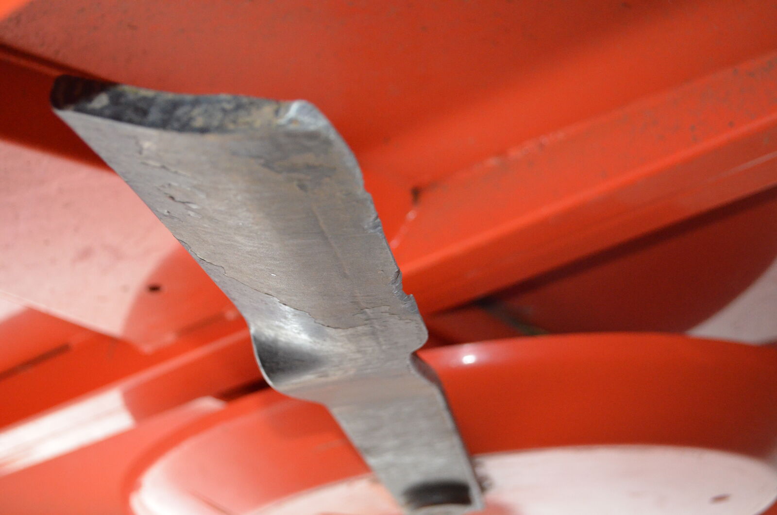

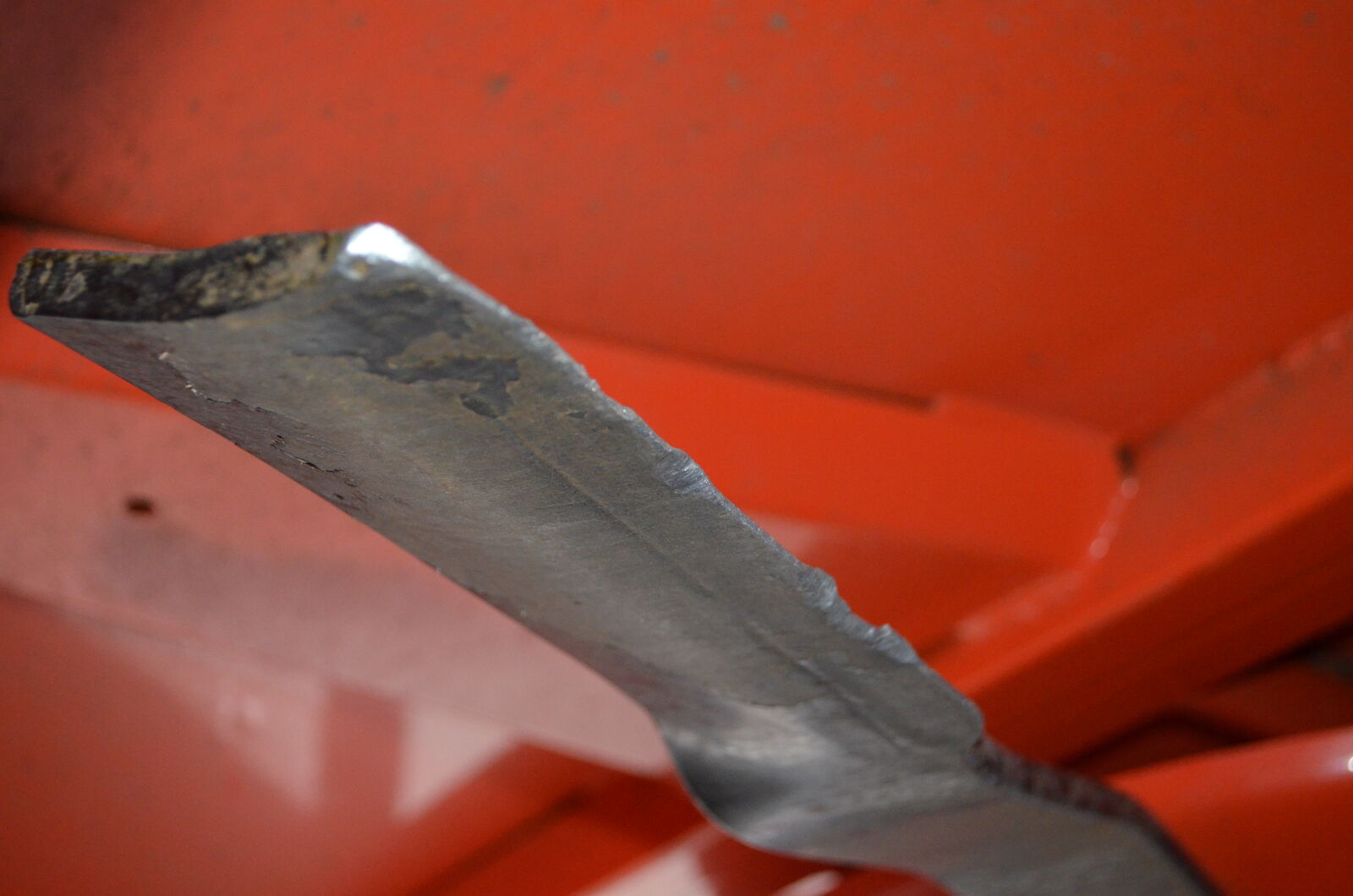

I've read the various threads. I know we don't want them too sharp, that dull blades are arguably fine.
After my first field clearing I thought I'd just touch up some rough spots with a file, but man, these look more like they need to be put on the anvil and hammered out. Normal? Just leave 'em alone?
The field cutting definitely seems sub-par now compared to when the blades were new. Pics are of new blades after about 15-20 hours of use.

Just guessing from the pic...but it looks like the blade edge has lost some temper...possibly from heat generated by grinding ??
   / Rotary cutter blade pics, advice? #5
Piney is right,from the way blade edge is bent,the metal is soft. The blade also appear's much thinner than usual. I wouldn't sharpen that blade but I'd certainly compare thickness to other mowers and take note how blades normally wear and chip but don't distort.

Nope, that's a brand new blade with its first season in my field, untouched by me. The damaged edge is _very_ thin in places now, I don't know what it looked like new, I didn't bother to see.
The only grinding it's had is the the occasional rock in the field.

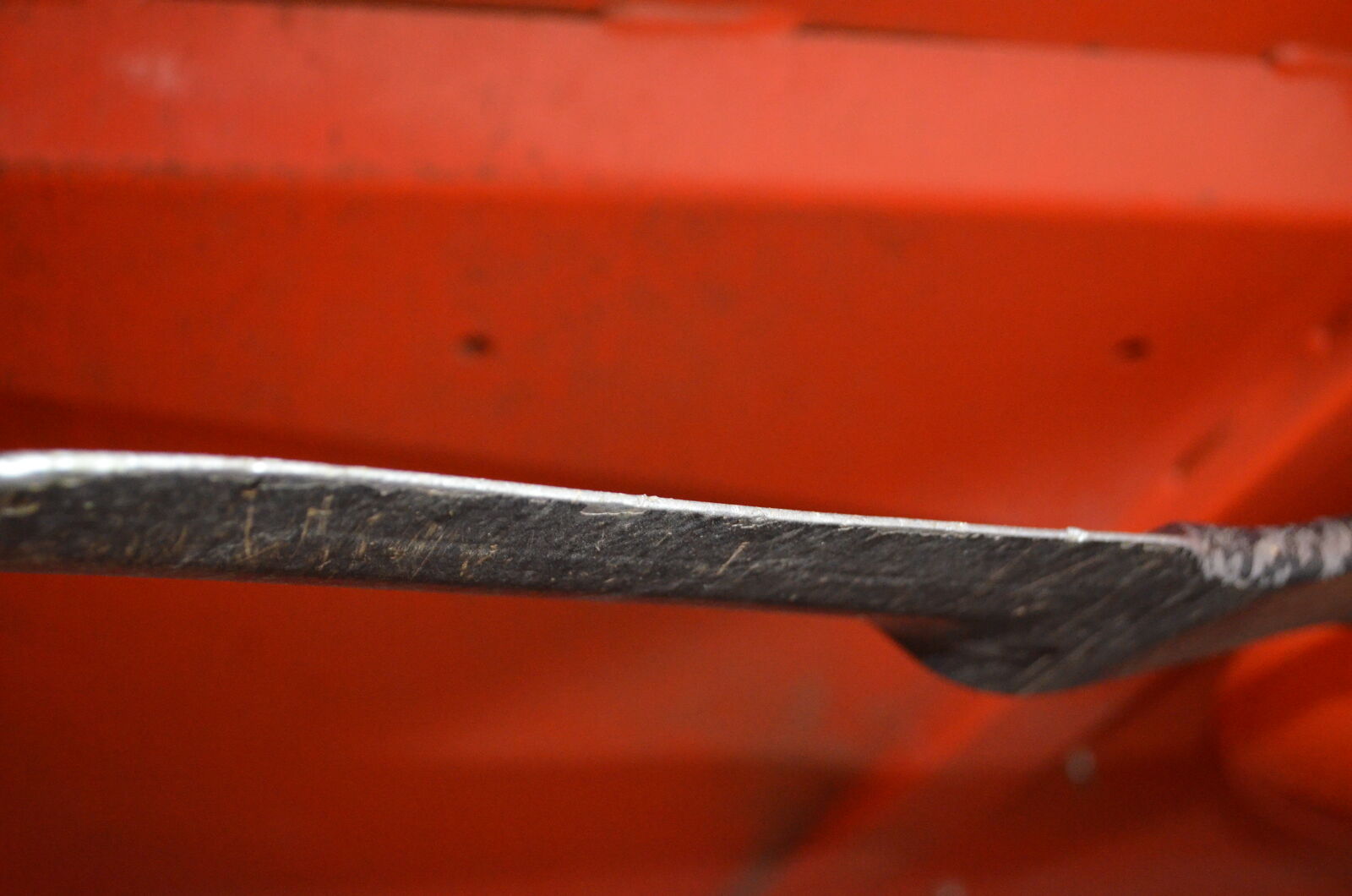

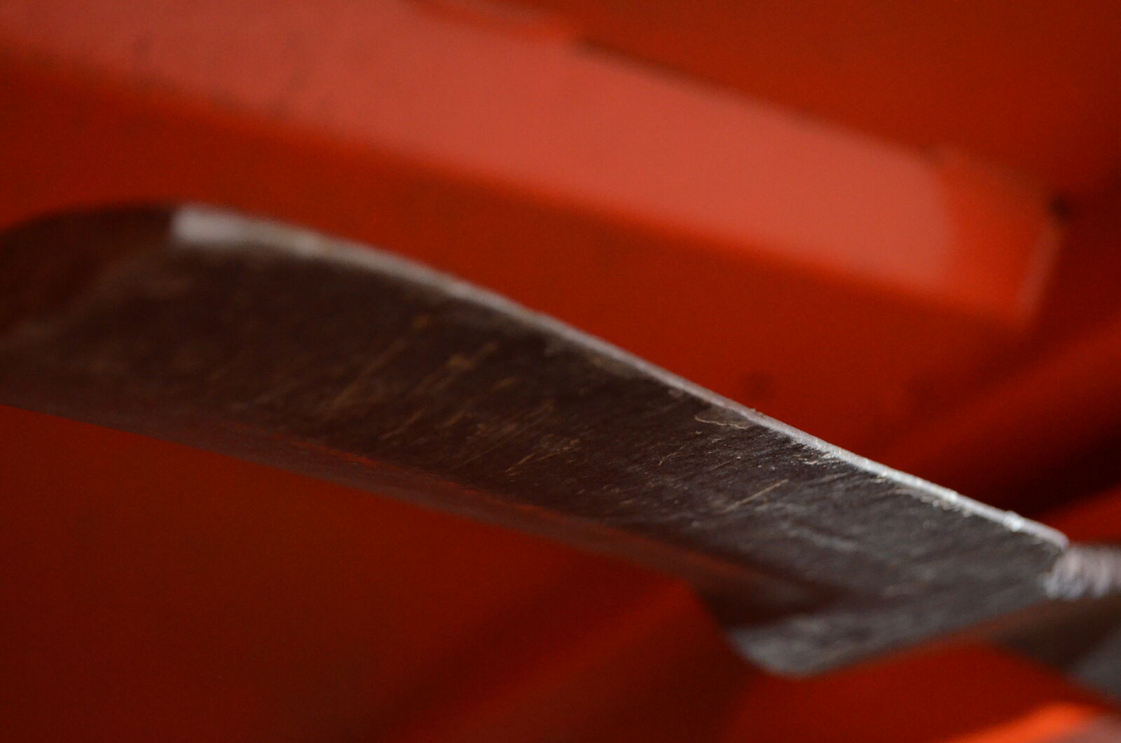

That's a lot of rock grinding right there, whether you hear it or not from the seat.
Can you get a pic from above or from the end of the blade edge? That will help in determining what's left of them.
I use a 7" grinder on mine.

I'm with Pine. Exception being, I don't think that blade was ever properly tempered. What brand cutter is this?
