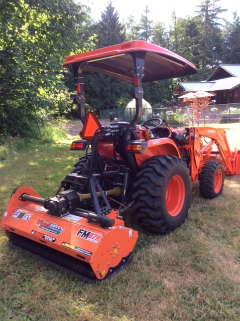

L2501 here as well. This tractor cuts great with both the 60 inch flail and 60 inch brush mowers. I do go slower in tall grass and have cut up to 6ft with both. The flail weighs about 700lbs with no issues of a light front end although I do feel it in a few places. On the steep stuff I engage the 4x4 otherwise 2x4 is just fine. I have juice in the rear tires as well and often mow with loader attachment removed and in this configuration have mowed some steep stuff as we have a couple deep ditches for run off water in winter. My tractor is not optimum I know but wanted something smaller for the tight stuff around the barns and old cow pens where the bigger JD is just to long for turns and such. As suggested, the lighter mower in question might be better for your tractor and if not having tires filled you might consider doing that, it does make a difference.
Ricn
