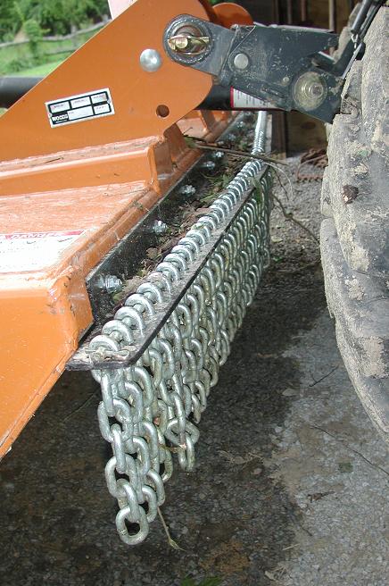

Can someone post a picture of their chains? I don't have anything on mine.
   / Rotary cutter safety devices #9
I'll try...have not posted a pic since the new TBN appeared...:eek:
Here goes...don't know if the pics will appear or not...:eek:
These were taken a while back before my tractor evolved a bit.

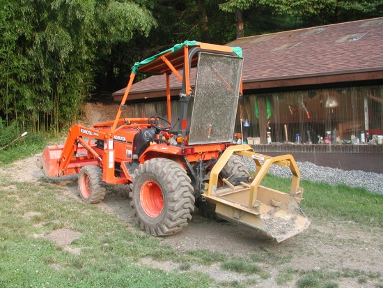

... was it Henro who put mesh on his ROPS to stop stuff hitting him? What do you have?
Yes Mith, I think you remember this...actually a relatively heavy duty stainless steel cookie sheet adapted as PPE (personal protective equipment).
For those who may wonder what we are referring to:
(Don't know why the guard is on the tractor when the brush hog was off...)
