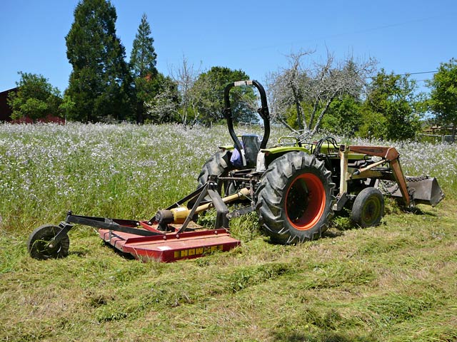

I still don't know if I should have bought a 5 ft mower.
My neighbor, an experienced (third generation) orchard operator, looked at my YM240 (YM2000 equivalent) and advised 4 ft maximum considering the tractor hp and the hilly terrain.
Most of the time I can run in H3 with this 4 ft Howse. For this field in the picture, with heavy wet grass, there were a few times I bogged down going up the slope and had to use H2 until I reached a corner and started downhill. I soon learned it was easier to take a 3 ft cut going uphill than to stop and shift down.
My comments: If you are cutting heavy stuff like this, then 4 ft maximum. If you are mowing a few inches of grass on level ground then you might try a wider mower. Does your dealer allow exchange if the 5ft is too big?
