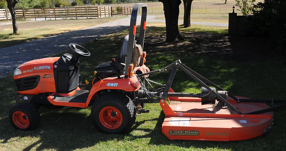

With the BX1500, I think 48" would be a bit much. A 42" would make more sense at that horsepower
Here is my BX2660 (19.5 HP at the PTO) with a LandPride 48" rotary cutter.
