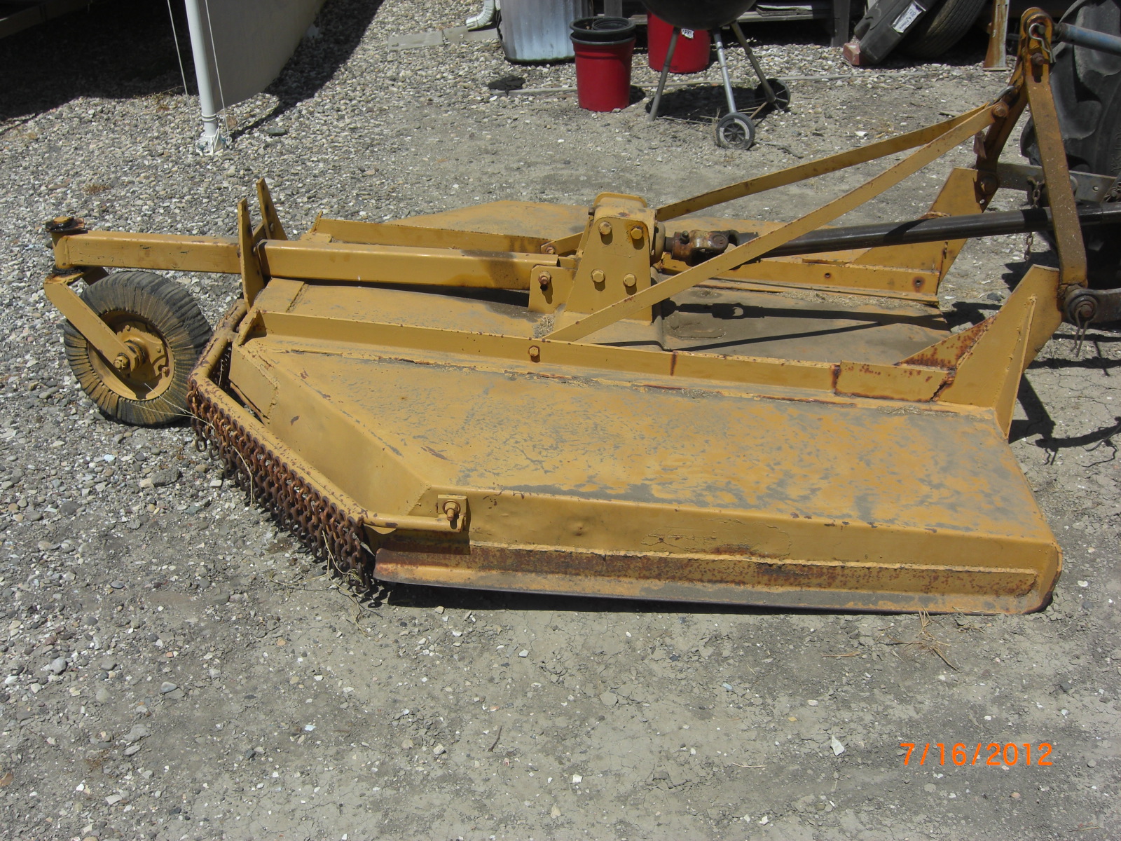

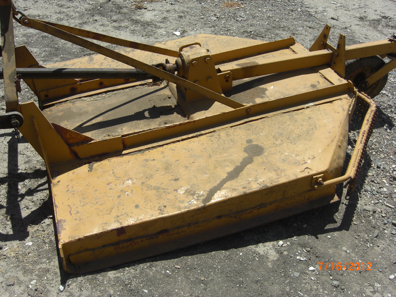

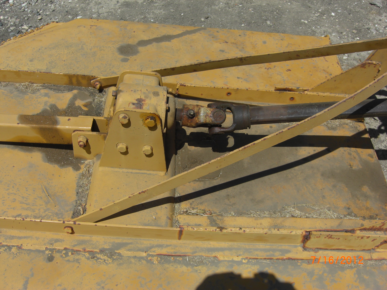

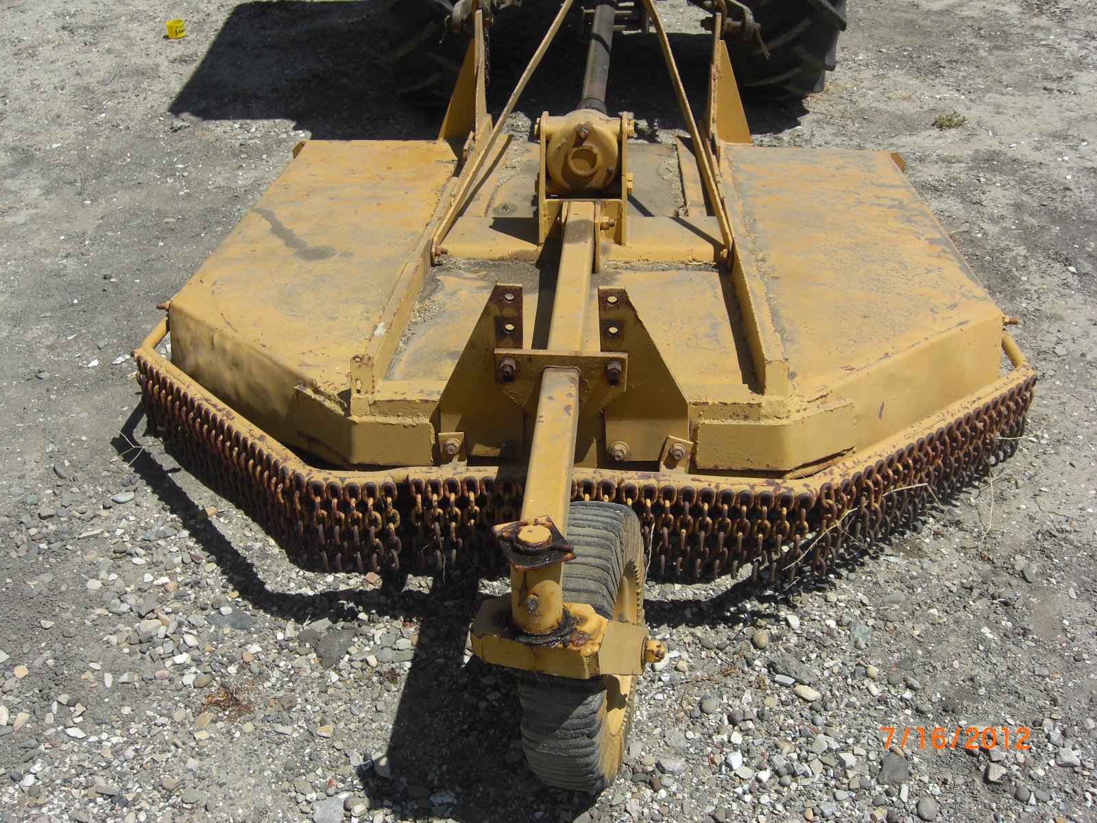

I recently bought a used tractor and a rotary mower came with it. The seller couldn't tell me what make the mower was - and there are no ID tags, plates, serial numbers etc. I'd like to get a manual for it and possibly order some parts. Can anyone help me to id it? I've uploaded a few pics of the mower. Thanks for your help.

I see a lot of similarities to landpride, frontier, and johndeere. But cant find an exact match from any. Sorry I couldnt help. But it looks like a decient mower. What parts are you needing??

I've got a gear box oil leak so unless I want to constantly put oil in it I would replace the seals and maybe bearings. It's probably cheaper just to buy oil........ Thanks for the help. I'll do some online looking with those makes in mind. Thanks again.

Pump the gearbox full of grease and run it... It looks like a Woods...

Yeah, corn grease. That should keep you going till you can find the right seal.

I have found that when dealing with old or unknown equipment, it is easier to just take it appart and get the seals/bearings by size, rather than by MFG part #. Because if it is one of the three I mentioned, and you order seals and bearings from them, (or even any other for that matter), the cost is going to be about 3x's as much. Rest assured, that gearbox doesnt use any special kind of seals or bearings. Probabally just common off the shelf stuff that can be had at napa, autozone, or similar. And can be ordered online from about anywhere.
