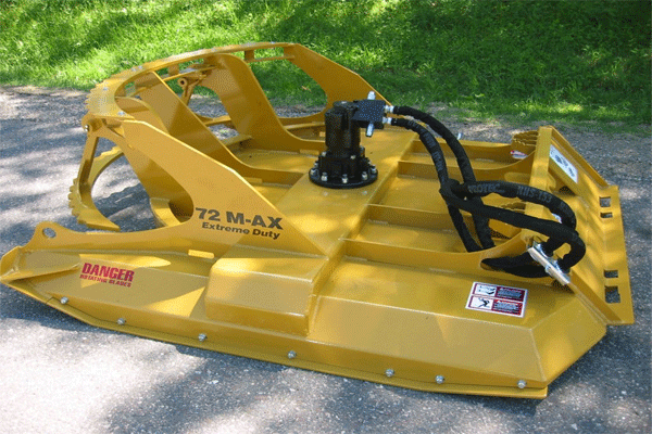

Hello newbie here looking for advice on a rotary mower to use on a 2032r. The mower will be used to maintain woods, trails, and fields that if bad enough will be mowed prior to with a Bobcat T750 and a Brushwolf M-AX. The reason I'm intrested in an tractor unit it cost so much to run the CTL and mower fuel and wear and tear. We don't have a lot of rocks around but the skid steer does leave some tree shreds prolly in the 1-1 1/2" size laying around. I know i need the heaviest duty cutter i can get that the tractor can handle. I was intrested in a used deere MX5 for $1500 but am concerned that its to much weight possibly? So my next thought is a bush hog squealer sq160, next option woods BB60X Brushbull, or Land Pride RCF2060. I like the idea of smooth decks its a pain in the butt to keep the top of the Brush Wolf unit clean. I've searched and read as much as I can and some say they love this cutter and others this one and some problems on brand x and some on brand Y. I know deere has the resale value but can the 2032r handle an MX5. Let me here your opinions good or bad. Thanks
