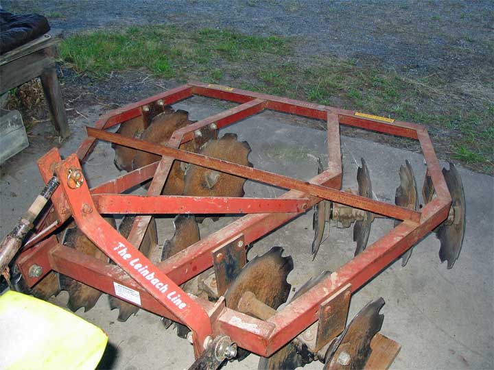

Ken,
How much ballast does a small disc need, to make it turn over sod? It's a 6 ft Leinbach like your 'Lift Disc 628'.

With your tractor, I would go with the heaviest 4 or 5 ft disc I could find. The 6 ft is too much width, to get good penetration--Ken Sweet
